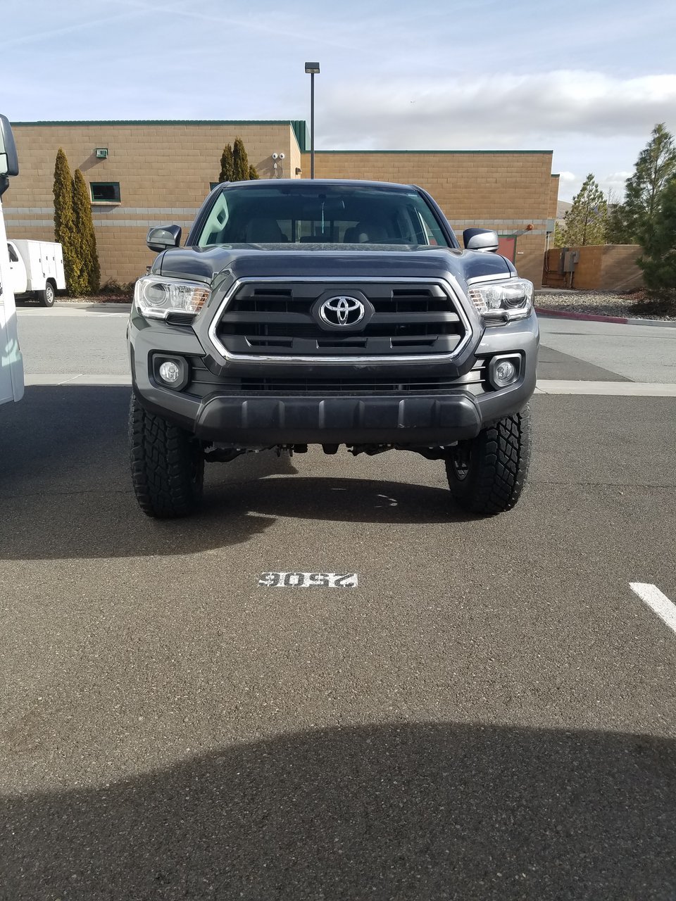

    about the same here. :thumbsup:

    What rims, lift? Any rubbing?

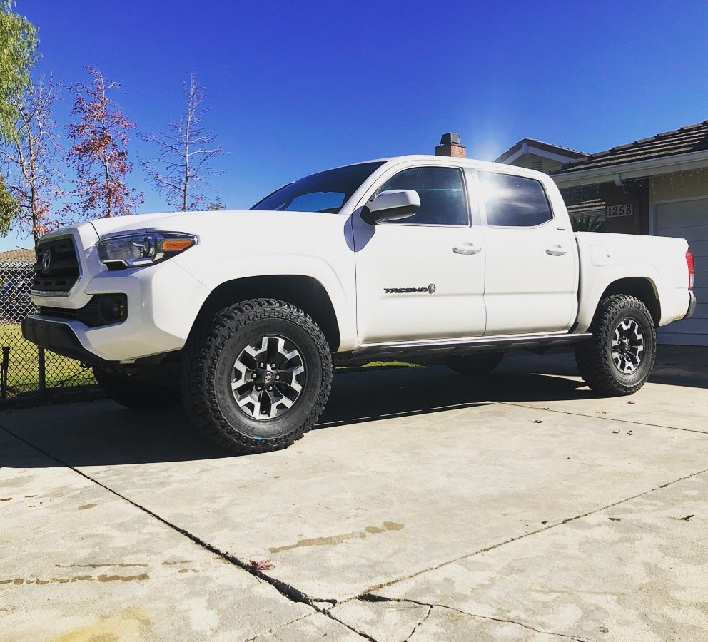

    Got mine on today 255/85r16

    Looks great! Do you have any pics of the truck in action with these new tires?
