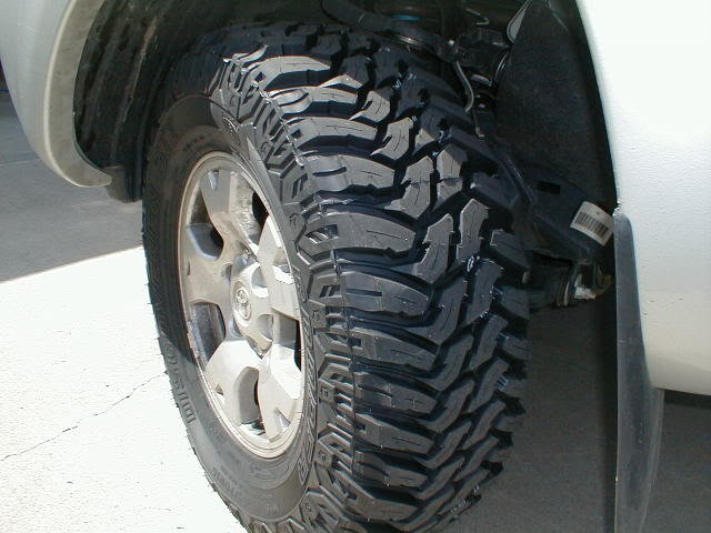

    Here they are on my 2005 Tacoma... They are stock size or within an inch of stock (75 vs. 70 aspect ratio)... Look great... I would NEVER get them again, unless I only did mud driving and noise wasn't an issue.
    1) Look Great and gave me the most mileage of any tire: 40,000 miles of life before switching to Toyo Open Country ATs.
    2) Work great in mud and rocks
    3) TERRIBLE IN SAND (remame them Grave Diggers)
    4) VERY NOISY on the highway
    5) Gas mileage dropped 1 MPG.
