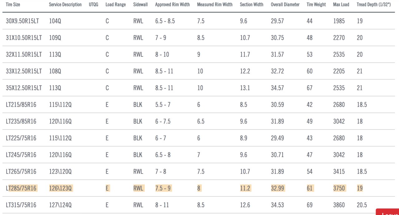

    Claimed weight on the 285/75/16 Duratrac is 54 lbs. Unfortunately they only come in an E load.
    STT Pros claimed is 61 lbs E load. Not seeing a C load on their website.

    They are all for 15” wheels unfortunately.
    I didn’t realize Tacoma brakes won’t work with a 15. The search continues...

    Copper STT pro also has C load for a 255/75/17. The first 5 on your photo are C load.
    If you scroll down on the spec page in your photo you will see a few C and D load.

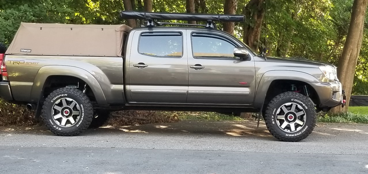

    Is this a stock OF if so what tire size looking to buy some STT Pros
