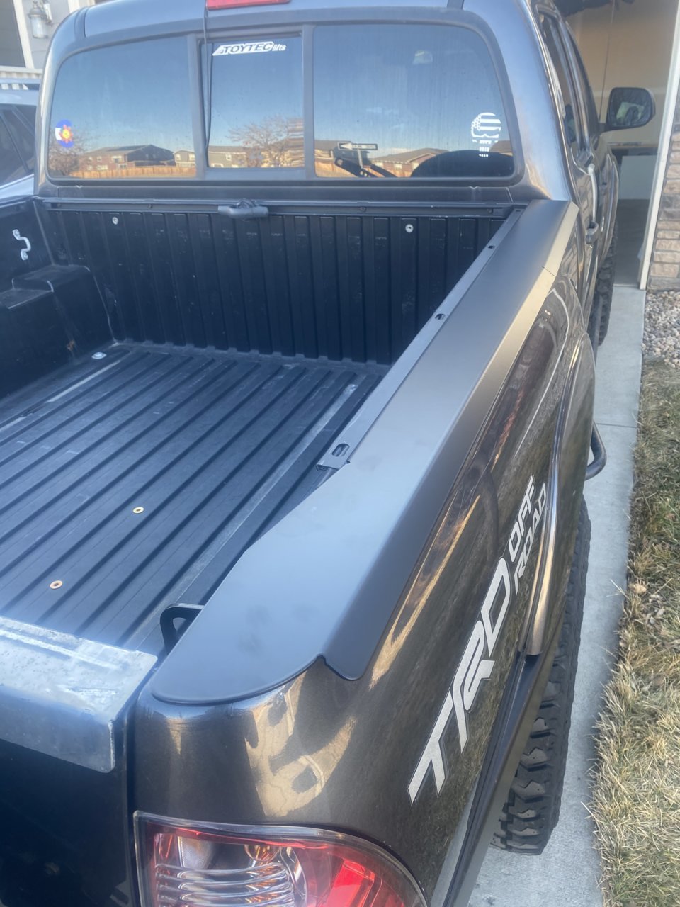

    320D46D6-F909-4D7F-8CC0-2FF1D7A12F2D.jpg Well thats was fast topper gone now time to clean the bed out seal it up and try and find some aluminum or steel side rail replacements kicking my self never should of sold my relentless fab ones i had.

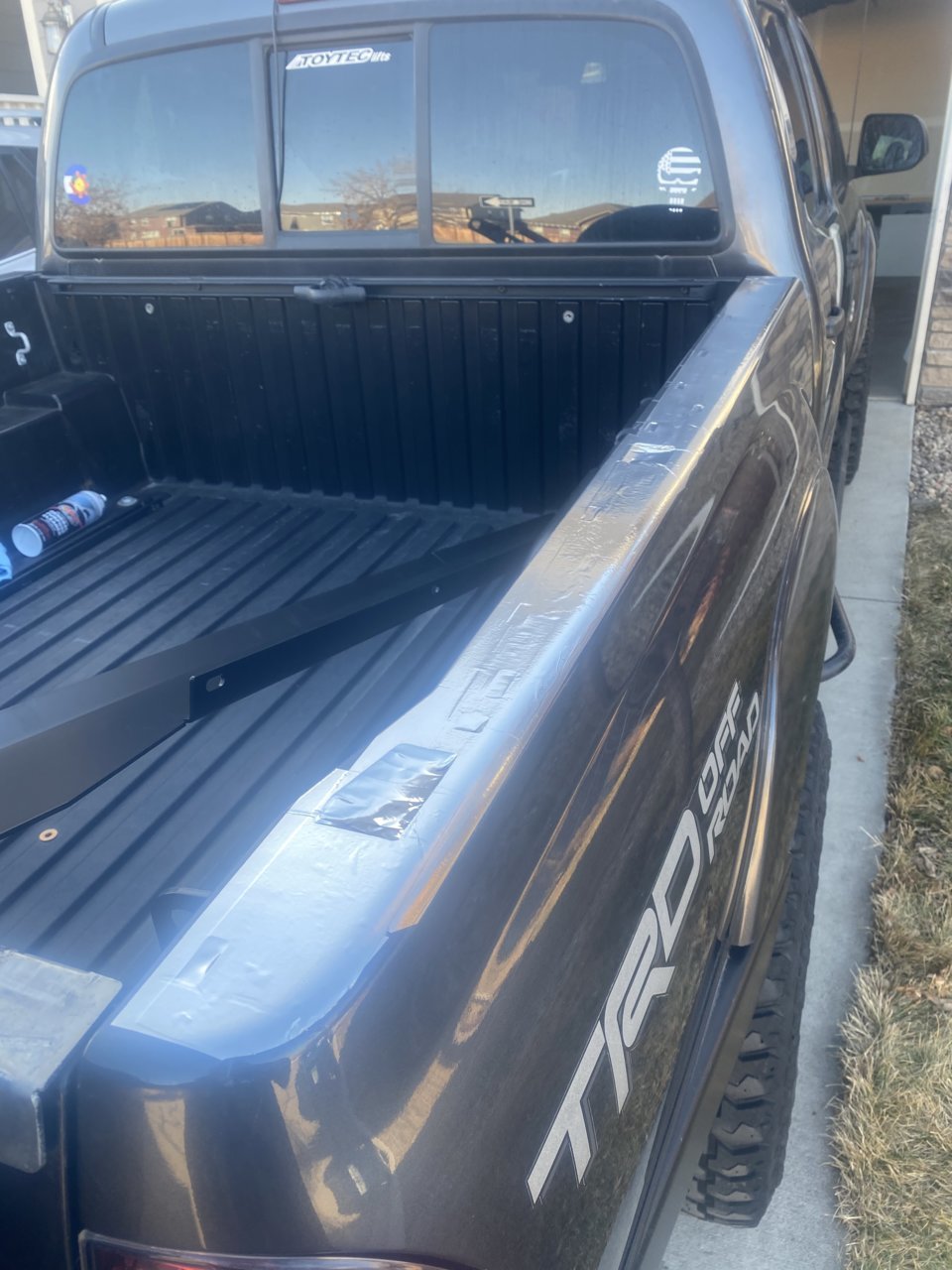

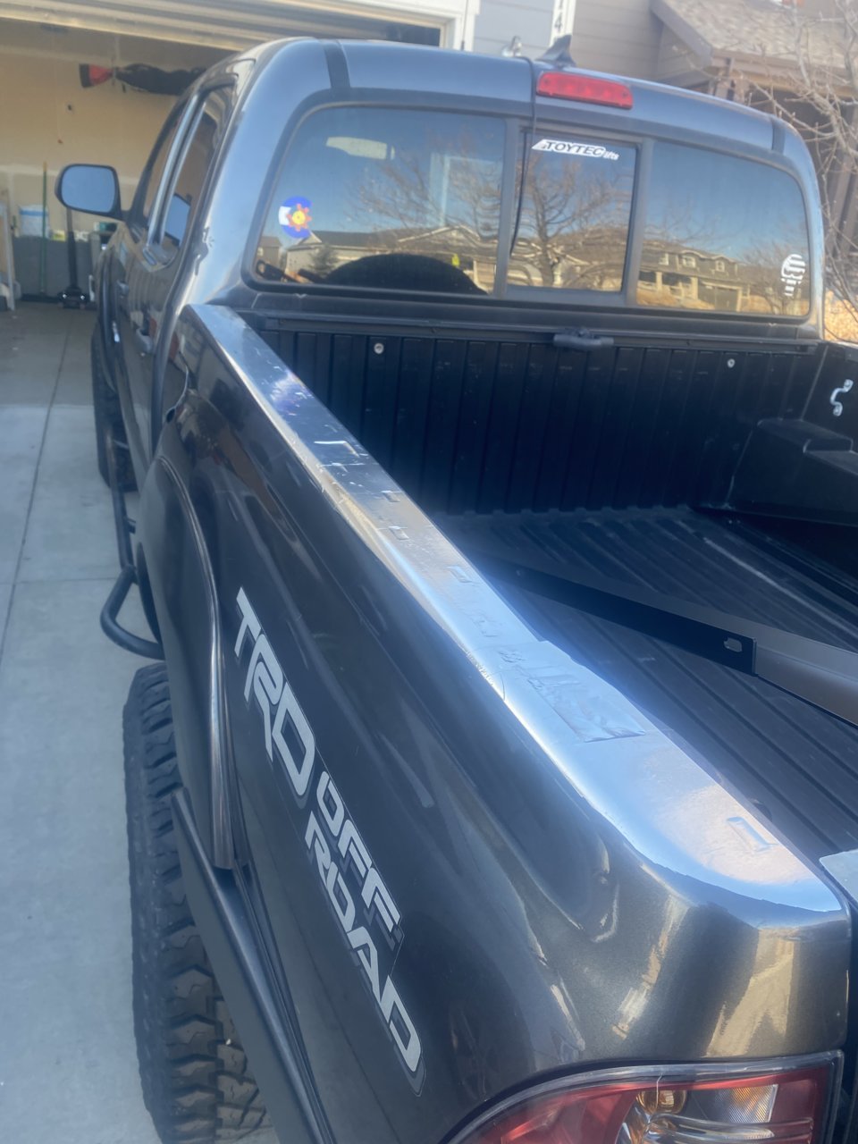

    Update sealed the side rails with aluminum tape was able to get a set of rails made local from a friend.

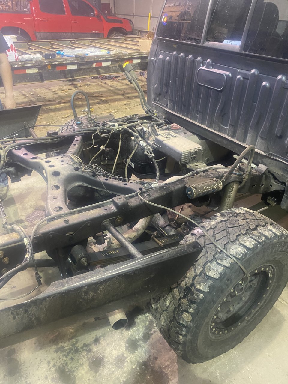

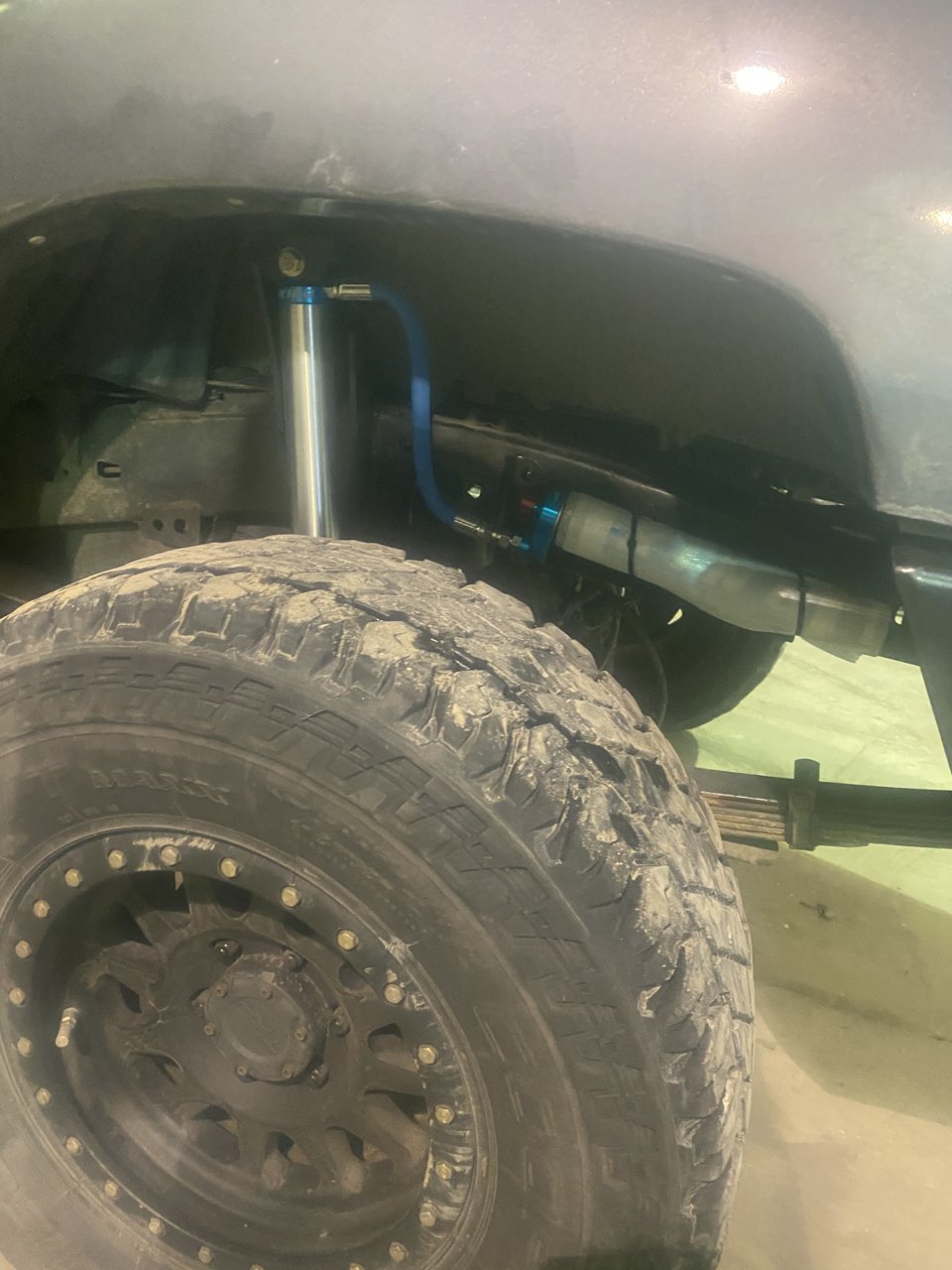

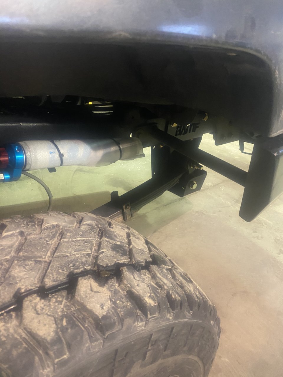

    Busy day today even with snow here, getting the truck ready for the camper and 2021 season. finally installed BAMF shock relocation. King 12”, and BAMF hammer hangers and shackles basically an all new rear end minus leaf springs. Thank you @YamaDirtrider and @Red Baron

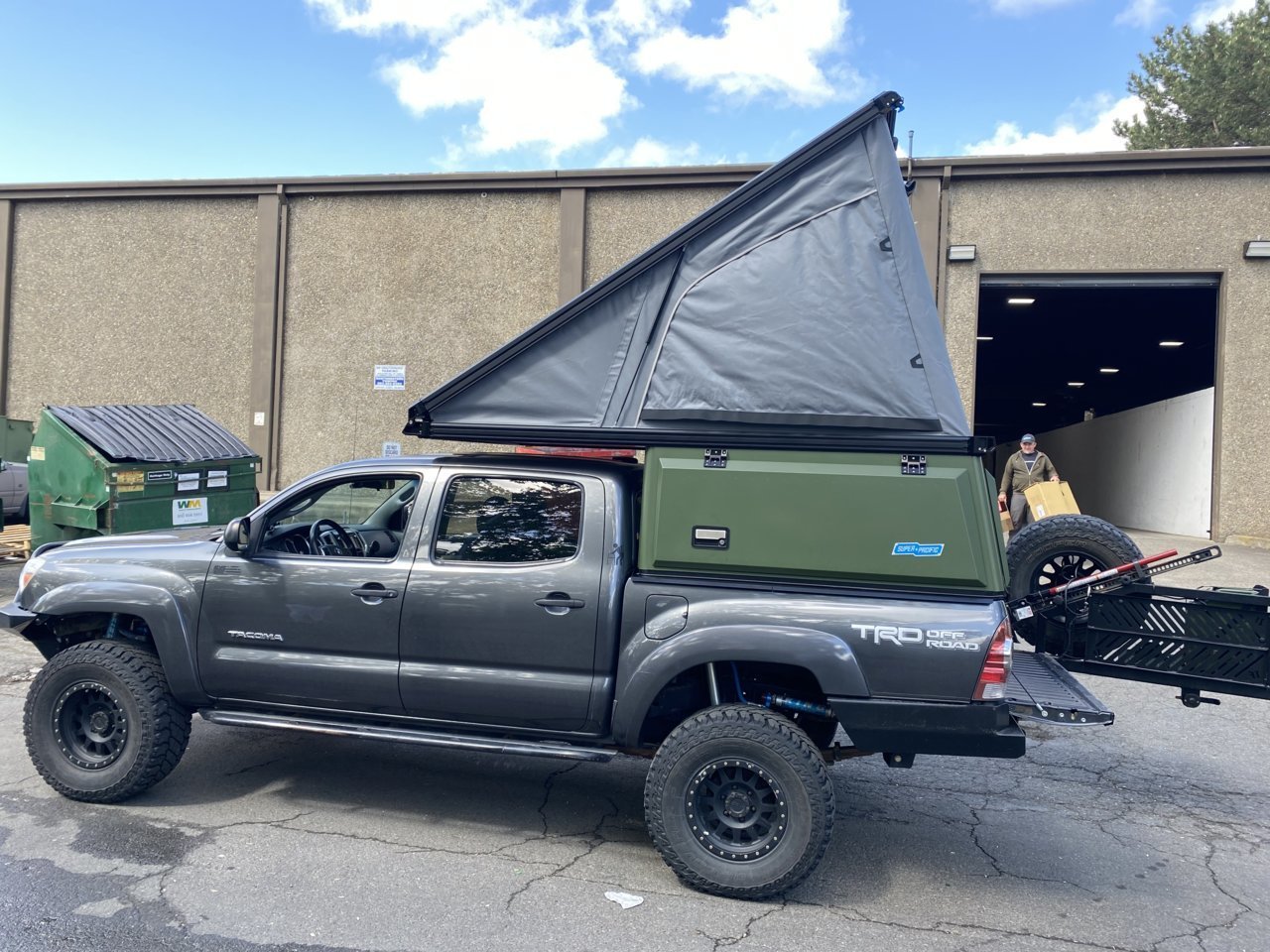

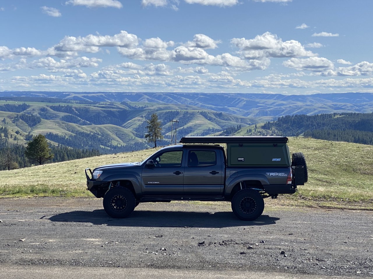

    :spy: Camper Installed time for many more mods getting this all fine tuned.

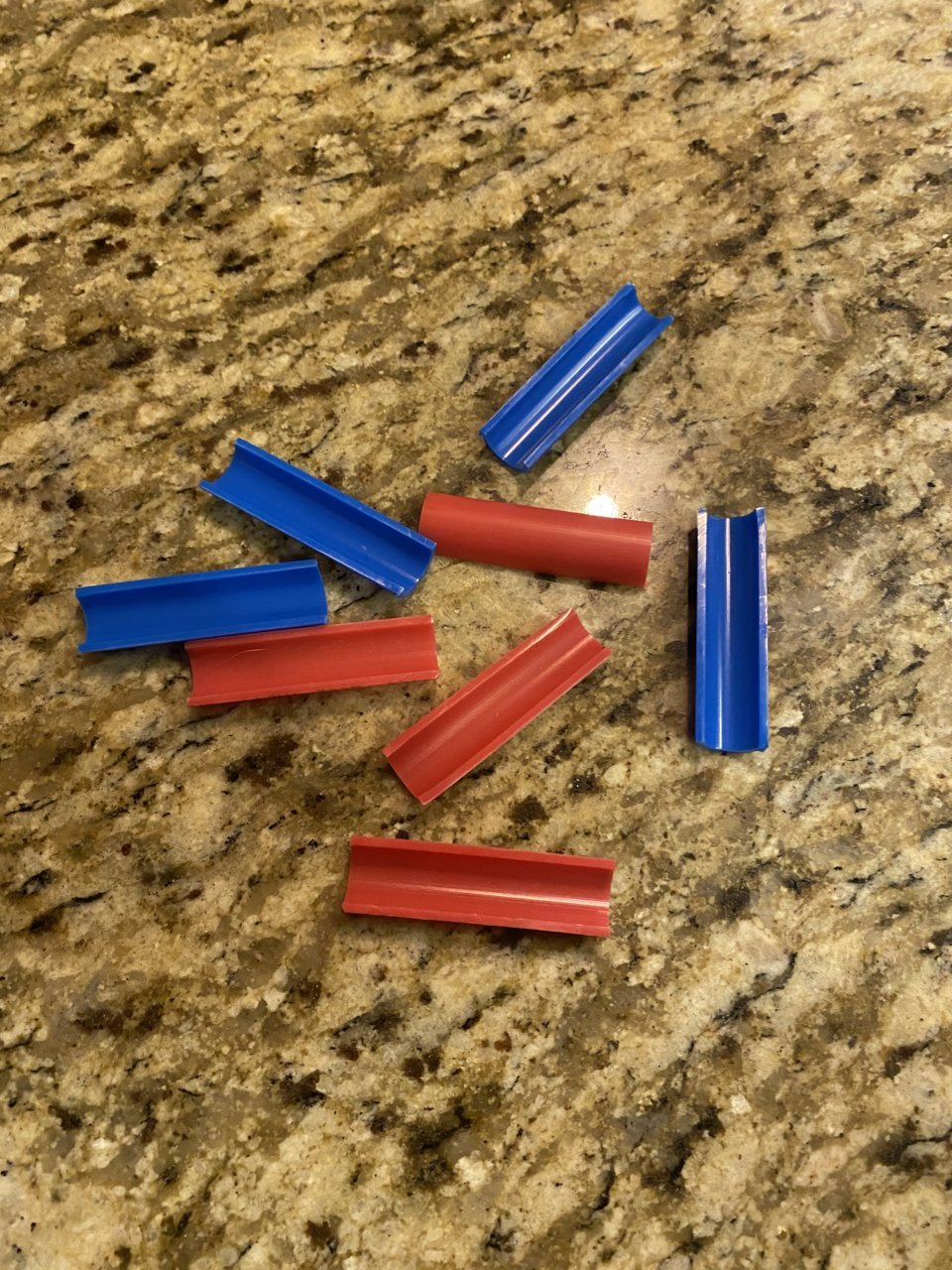

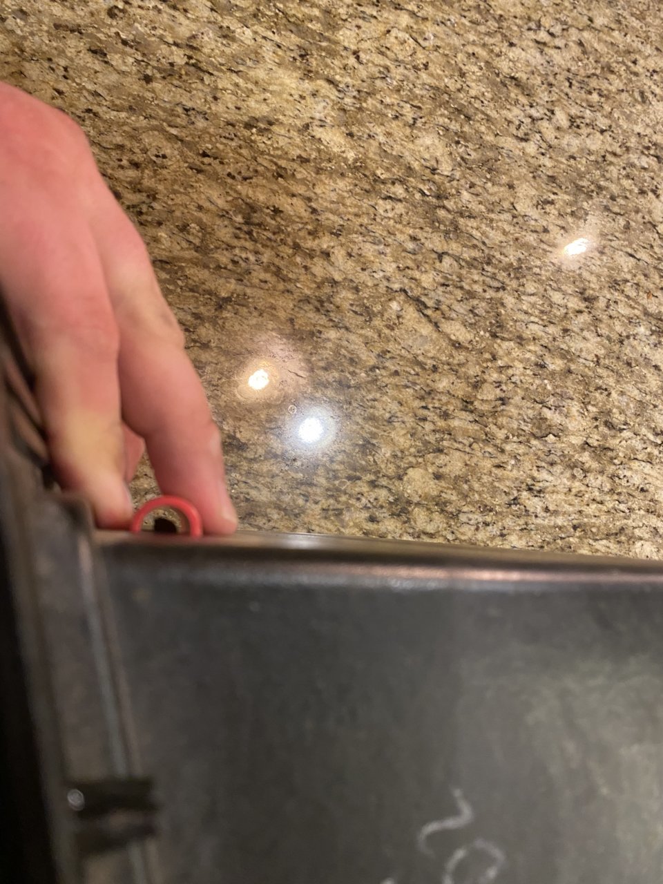

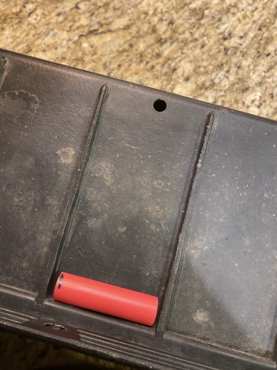

    Found a pretty simple solution for sealing the bed storage compartment if you have 1/2 PEX laying around or any other 1/2” pipe just split it down the middle and silicone it on plenty of room for the doors to operate and super cheap. Had left over scrap from a plumping project.
