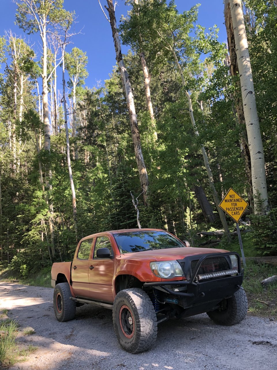

    I am running the 3” trailer products fenders, +3.5” LT kit, 315/75/16 tires and wheels with an effective 3.5” backspace in these pictures. Tires barely, and I mean barely rub the fenders.
    Definitely stick with the 3.5kit and see how they do. You’re only on 33” tires correct? What backspacing on your wheels? My guess is you should be ok. Maybe minor trimming.
