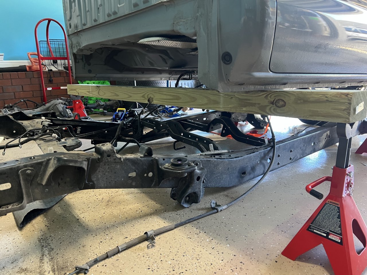

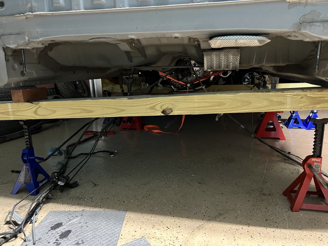

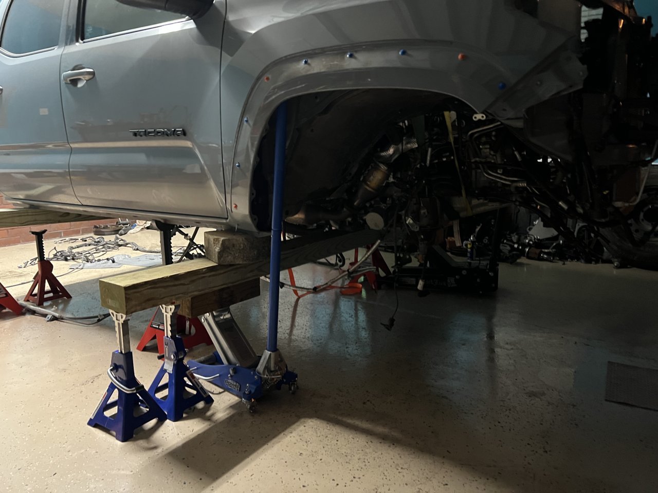

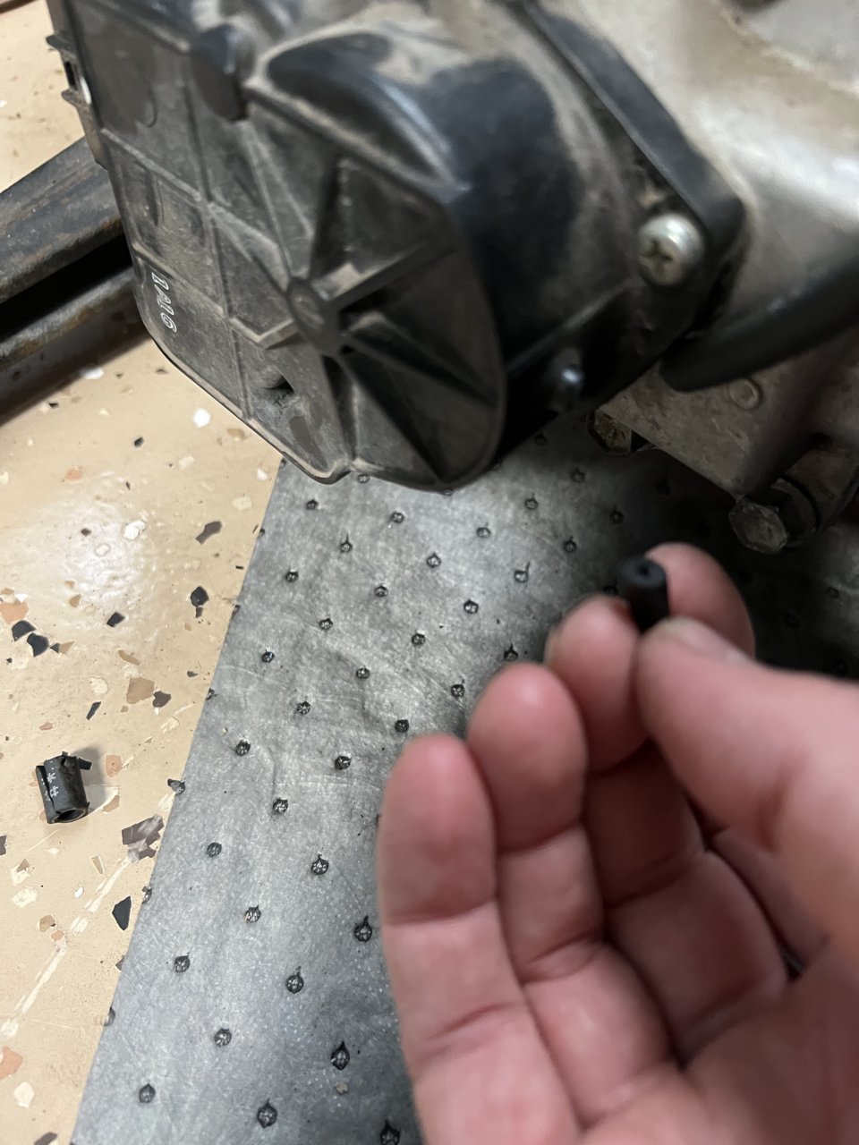

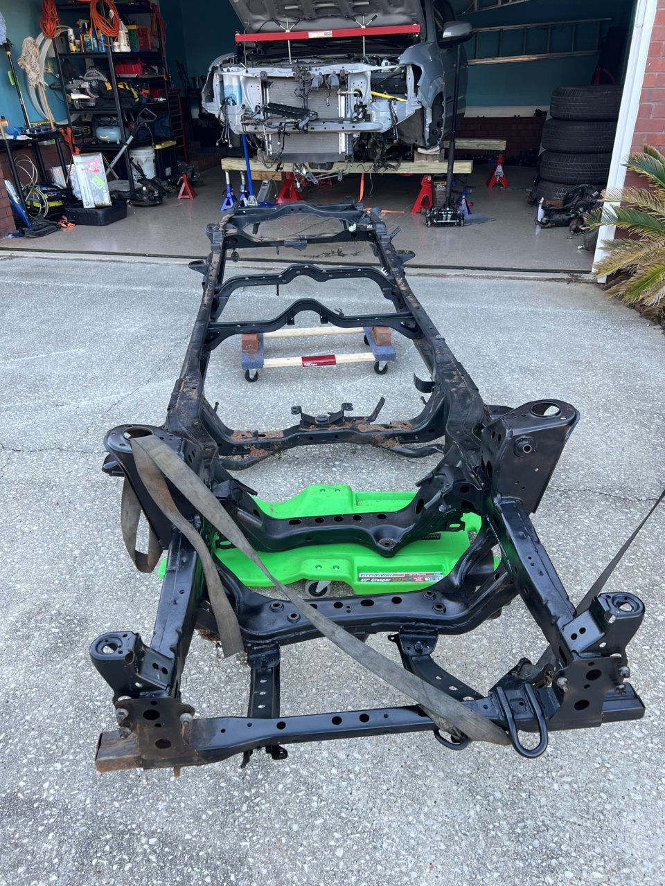

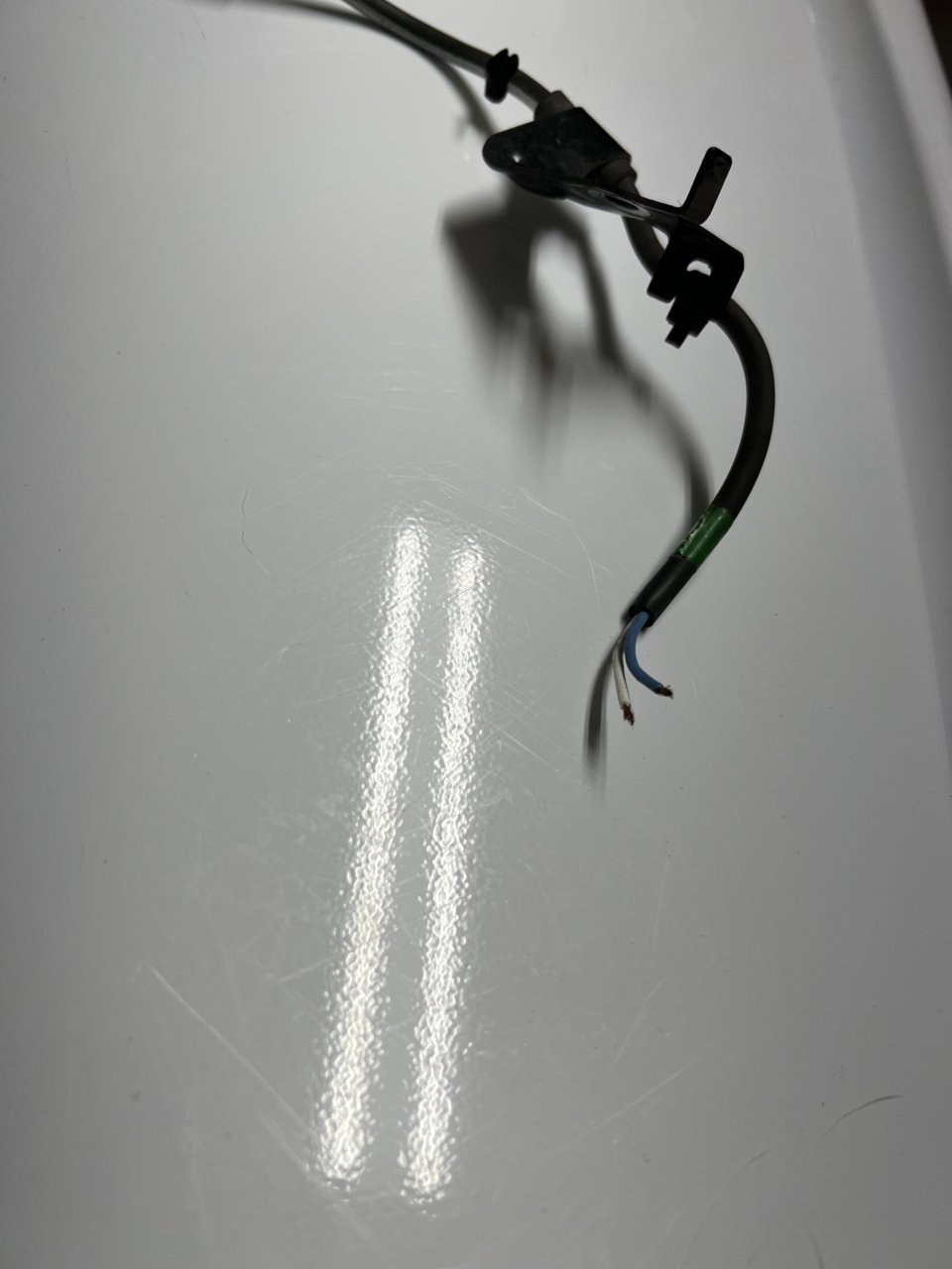

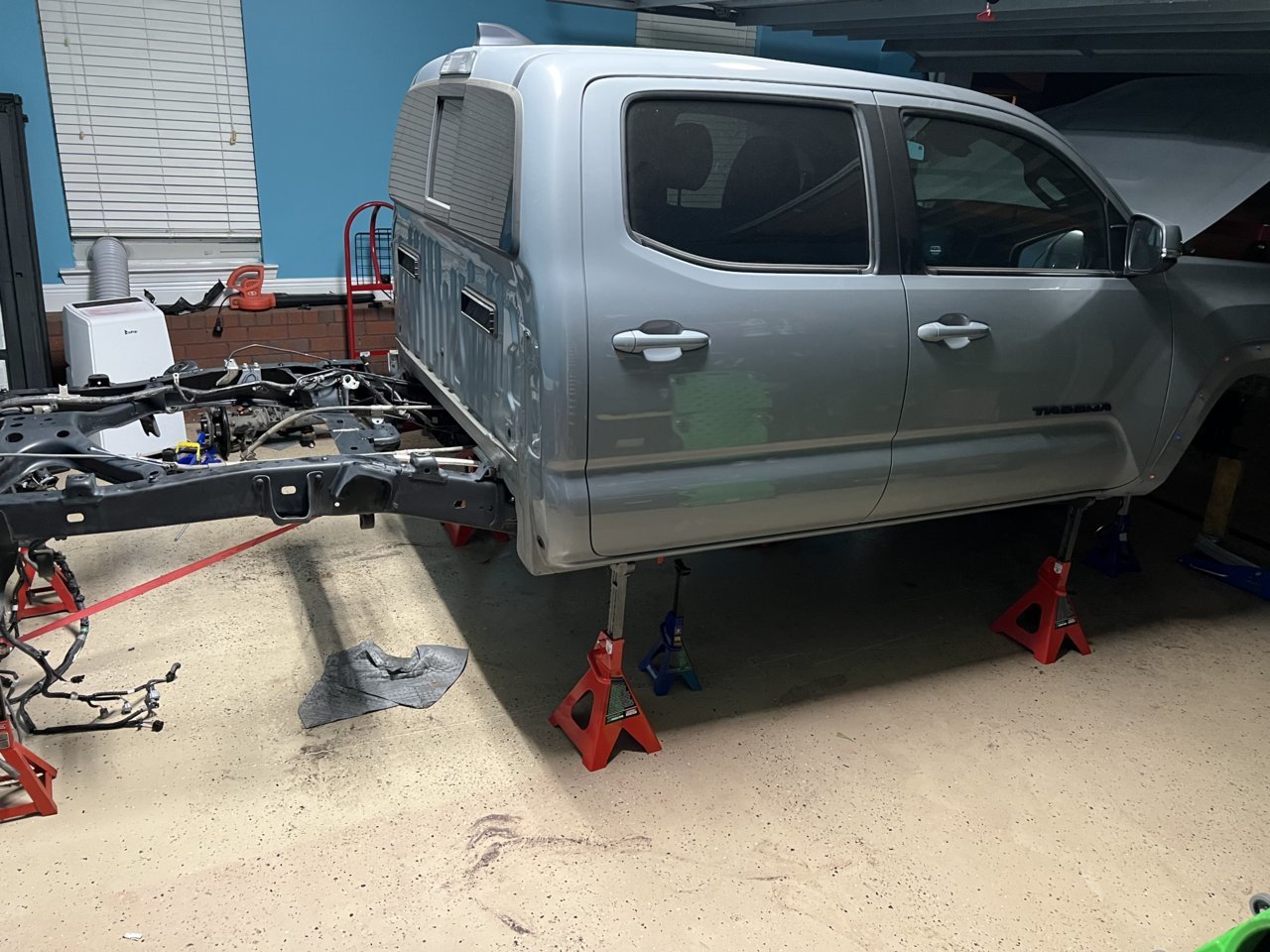

    Update: I just dragged the frame from the back yard. When I got to the front concrete I used my creeper on one end and a $14 furniture dolly on the other and if worked well. I went to harbor freight and bought an electric winch, drilled and put in a drop anchor in the carport to mount (drop ins allow me to remove the I bolt I used and put in regular bolts so it won’t be sticking up). On the way out with the frame I did pull the abs wires out and had to resolder, I broke the vacuum actuator and glued it with JB plastiweld (hope it holds, a new one is $300+). I’m going back to together with it now and everything is going good so far.
    Things I’d do differently: If you have room use a picker to keep the motor lifted (I didn’t have room) because I come to find that the jack stands have to be at the very front of the body seem or it’s really easy to tilt forward. You have to hold the body up with jack stands, drop the frame, use the jacks further back on the seems to drop the jack stands in order to put your 2x6 in to hold the body while you slide the frame out. Can’t do it with jack stands on the body because the frame is too wide to get past them. 2nd- I’d get the body higher up. The old frame was more twisted than I though and I ended up having to jack the body up on those planks and the body weight was lop sided. The new one cleared with no problem.
    It’ll be a few weeks before anymore updates. I’m about to go to Vegas and need to replenish my funds when I get back to buy the bed box, tailgate, bumper and left rear fender. So far I’m in $23,850 but it’s been fun.

    Looks like its coming togather. FYI that's not a vacuum actuator, the actuator is electric think the vacuum is to help keep moister out

    little vacuum hose is just a breather. ADD is all electric. it'll be fine if its glued back together

    That would be great news! Epoxy on those composite pieces almost never hold but it seemed sturdy. I won’t be taking this truck in deep water unless there’s a flood here so it should be fine. Thanks bro!

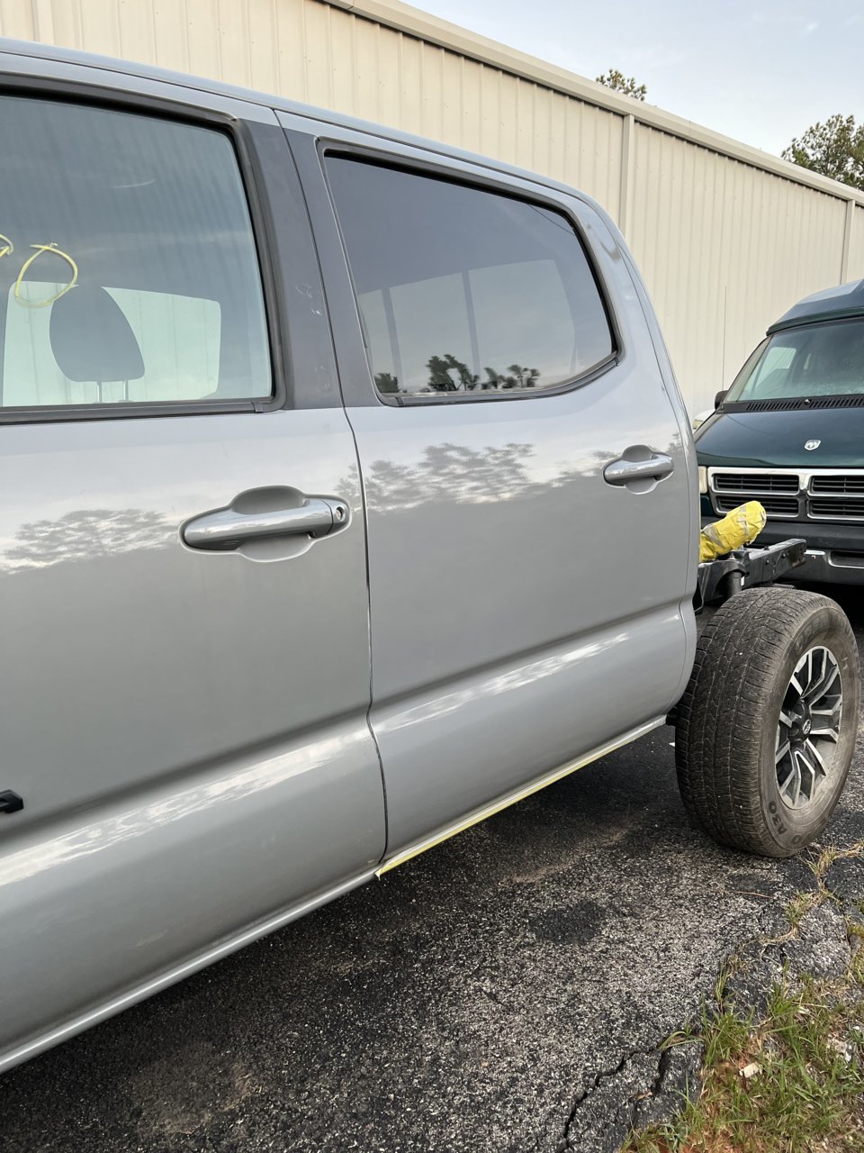

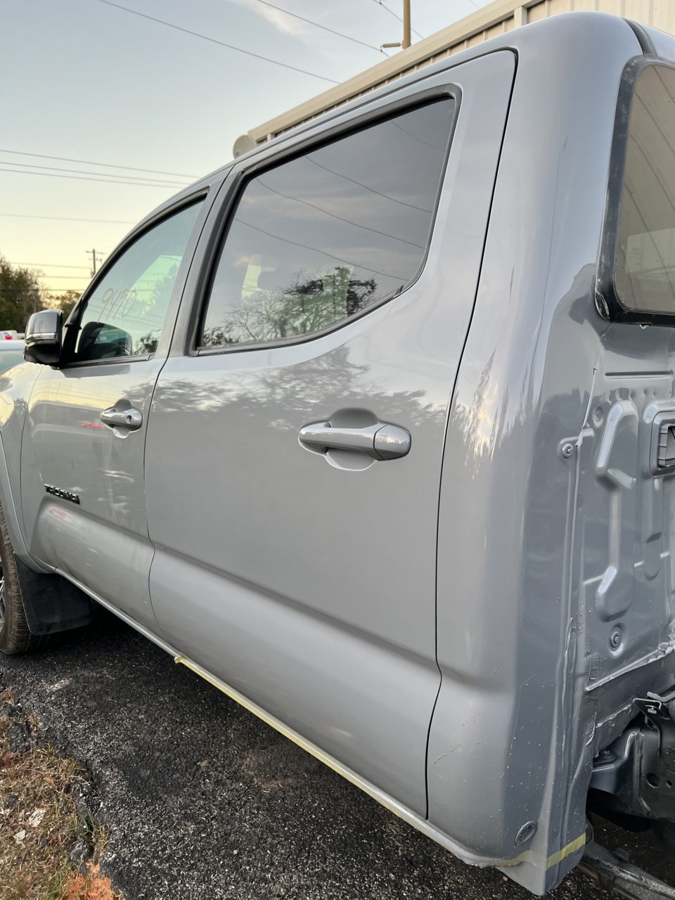

    Ok I got it over to Maaco for the bodywork and paint (paint less dent repair wouldn’t work). They did an excellent job especially for the price but the color tone is a little off. I’m hoping this won’t effect passing the inspection, I can imagine it will. My question is does anyone have any experience in touch up paints like AutomotiveTouchup, Direct Touchup or ERA? I’ll probably wrap it after the inspection but I’d sure like to get that tone closer. The back door had only a little scratch that I told them if it wasn’t too much try to do something with it, I assumed buffing. If it was just the back it wouldn’t be noticeable but those doors are gonna drive me nuts

    Shouldn't effect inspection, I wouldn't worry about the tone unless it bothers you that much. Only real answer is to repaint the whole thing at once, the different paint areas won't match up perfectly.

    Honestly doesn't look like a super great job for a body shop. Paint doesn't even seem close based on those first two pics, painted right over the rubber grommets and the rear air vent things, and maybe got paint on the rear window molding (or maybe thats just dust?)
    But either way as far as the color goes, if you are going to wrap it does a perfect base color even matter?

    I would take it back, horrible job, but it was Macco. Can't expect much from them...
