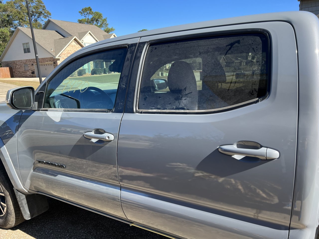

    There’s a couple of things here. In my first comment I was mainly talking about the bodywork, sorry for the misunderstanding. Toyota wanted thousands and Maaco did it for $680, it’s worth that even if I had to get the door repainted. Second, and I’m flat out shocked about this, when I took those pics it was hours after they painted. Today you can’t tell a difference. I’m not sure whether it was the reflection of something or the paint needed to cure more but it seriously looks great now! I’m more than pleased at the new development. I ordered everything during Black Friday, mostly from Toyota. I think I have everything now to start putting it back together BUT big game this weekend (Go Dawgs) so it might be next week before finishing up.

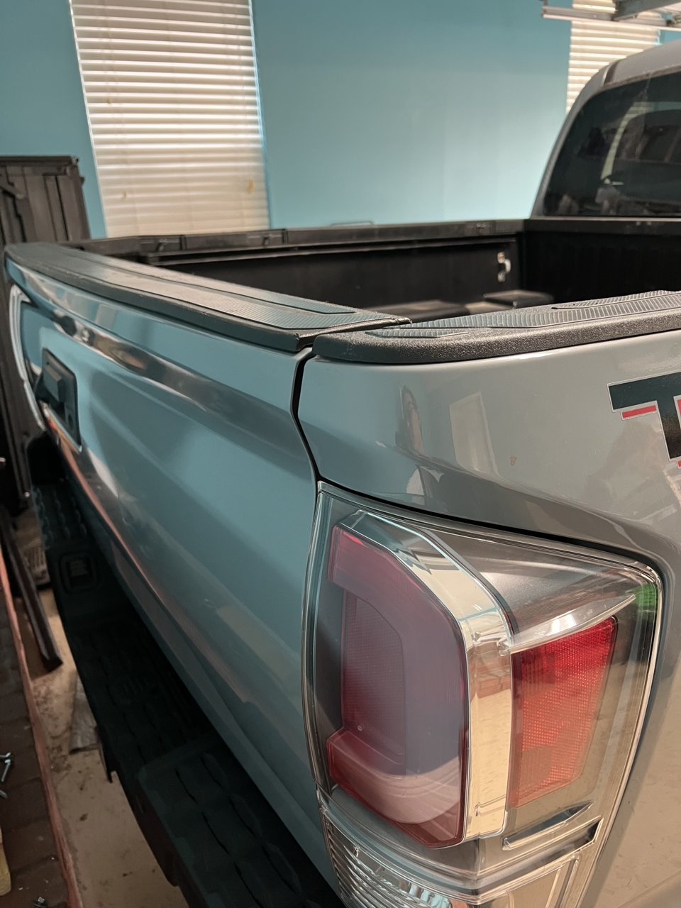

    6F370837-3C03-4F24-B106-0886BF96A123.jpg Well shit, the 2017 bed panel I got from the used tub won’t work and I already had it painted The design is different on the rear 408E9277-D261-4093-AE31-B3E2CC6E6DDA.jpg

    Are the tail lights identical?
    If this is for your personal use and the tailgate operates properly I would just leave it and see how many people notice.
    We have seen pictures where brand new trucks had Off Road decals on one side and Sport on the other, you could tell people it came that way from the factory. :laugh:

    What the, why is the driver side rear fender different from the passenger side? It looks like some work was done to that corner above the taillight.
