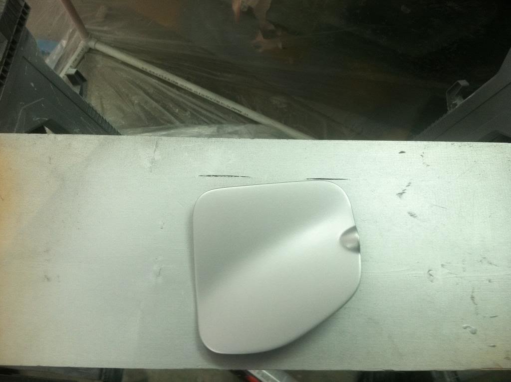

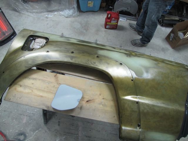

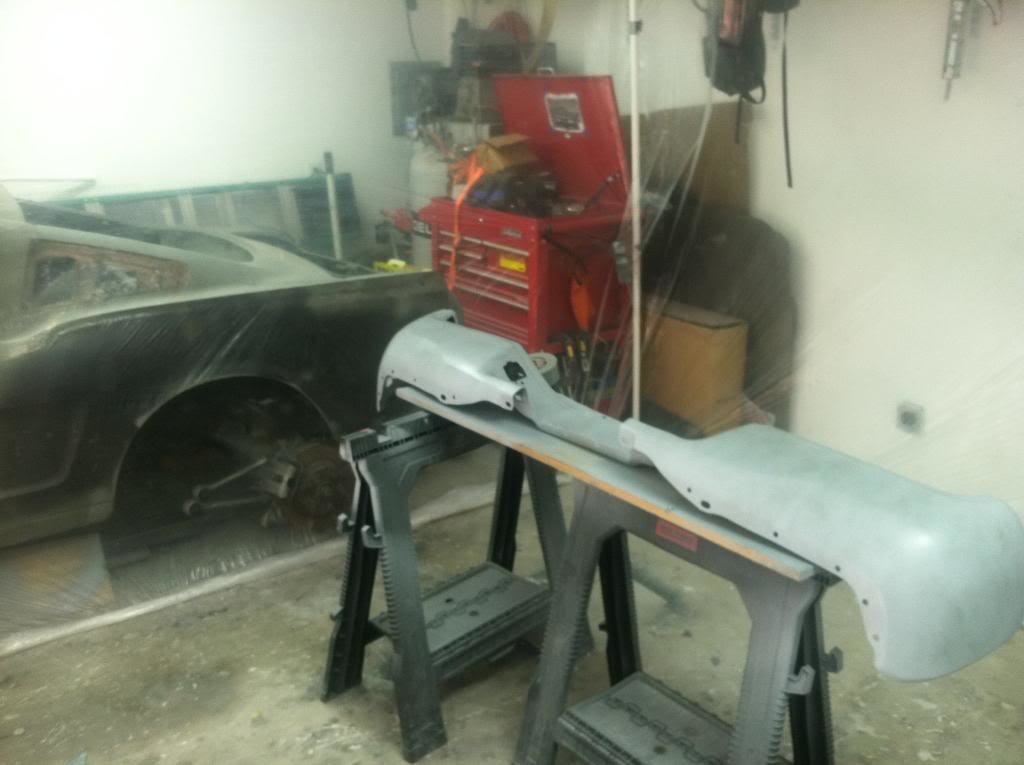

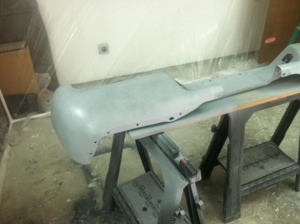

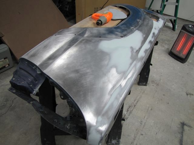

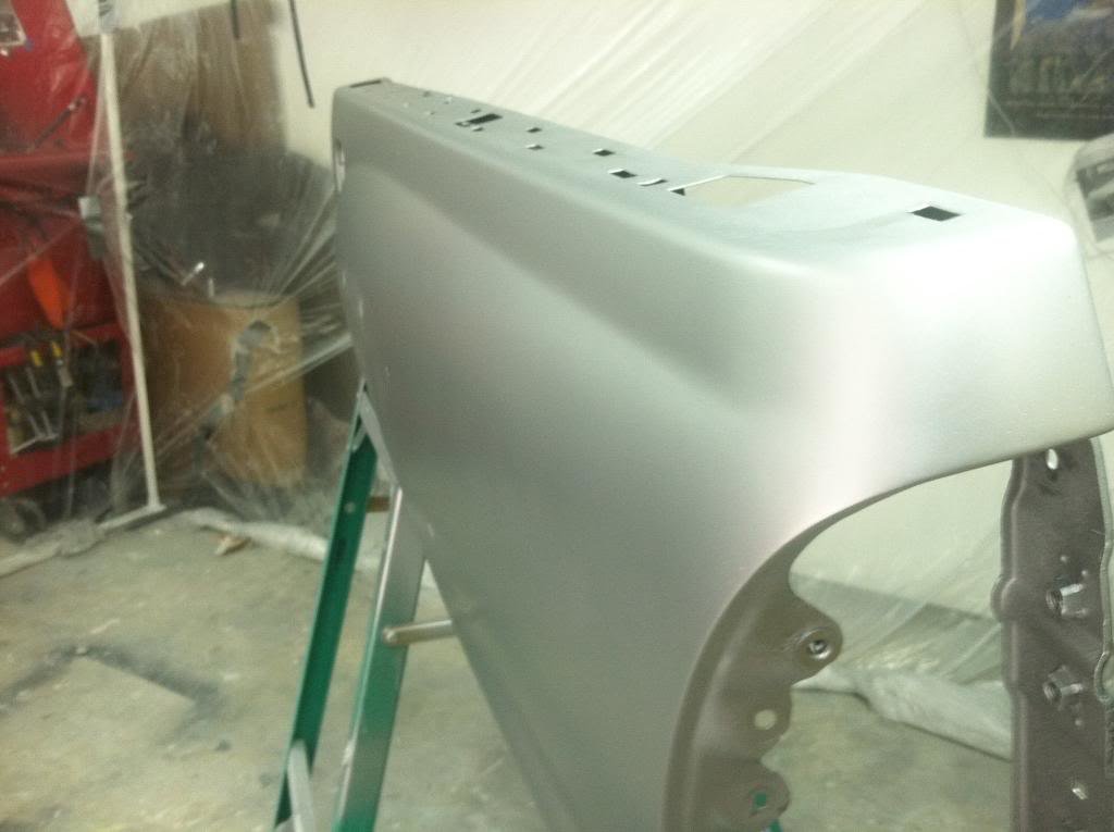

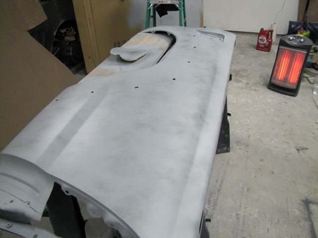

    Got some work done over the long weekend. The paintbooth did not go over as well as I had hoped. If I had to do it over I would go with 1 inch pipe I think.
    Overall though I would say its not too bad for being my first paint job. Really the only thing wrong with it was the little dirt/dust specs from my dirty garage. Anyways here are some pictures.

    Thanks, I am pretty happy with the results. With out a clean professional paintbooth I don't think I could have expected much better.
    In case anyone is interested I used a devilbiss finishline 3 paintgun. It cost around $200 (Ebay) but it came with 3 different tip sizes (1.8mm for Heavy primers, 1.5mm for base coat, and 1.3mm for clear). I am very pleased with it and there is a lot of DIY'ers who use it, so finding tips in forums on how to adjust it and what not is really easy.
