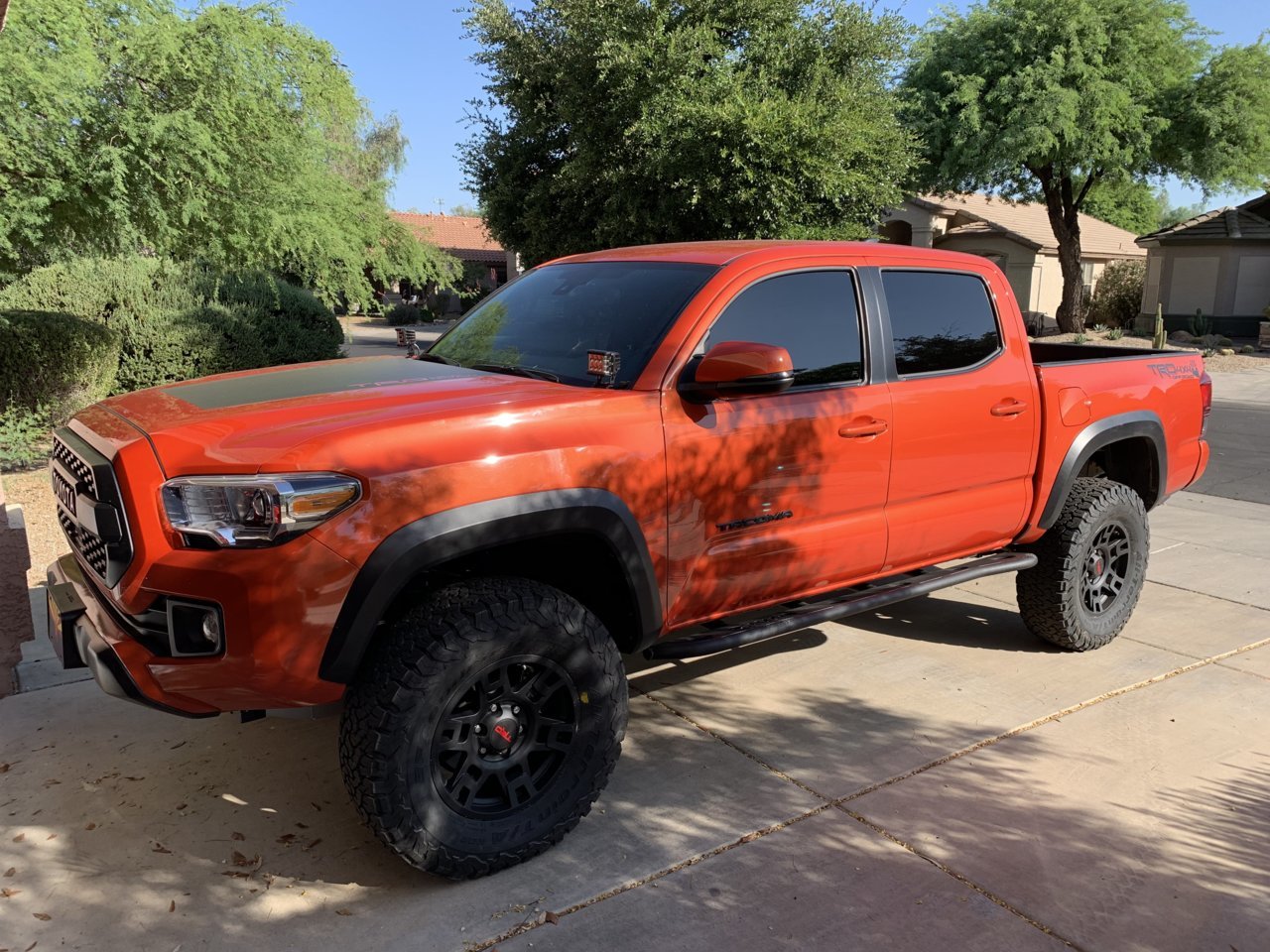

    it’s a work in progress but here it is so far. Not sure I have done enough to warrant a build thread but got asked if I had one so if you have any question or want some instal pics I have that too. Let me know. I add on it today and try and get up to speed. Where is stands so far TRD Pro grill / garnish, Hood TRD off-road decal, AZ Bed decal, Pro skid plate, TRD 17 wheels, KO2 285/70/17, avid off-road Sliders, Blackout emblems kit, TRD exhaust, TRD intake, Painted engine cover, Ditch lights, Tint, Tacoma letters glove box , Off-road wether tech inserts and mats, Lock box console, BlackVue dash cam system, Orange dash trim, Orange cup and cubby inserts, Katskinz seats, oem Bed mat, jack and rotopax spare (both locked), kicker Subaru tweeters, Tire locks,
    Fox 2.5 fronts with 700lbs Kings, Fox 2.0 rears with resi , Icon rxt springs, Icon Delta UCAs, Meso side markers, Meso gashole, joying auto head unit
    Mod pile———-

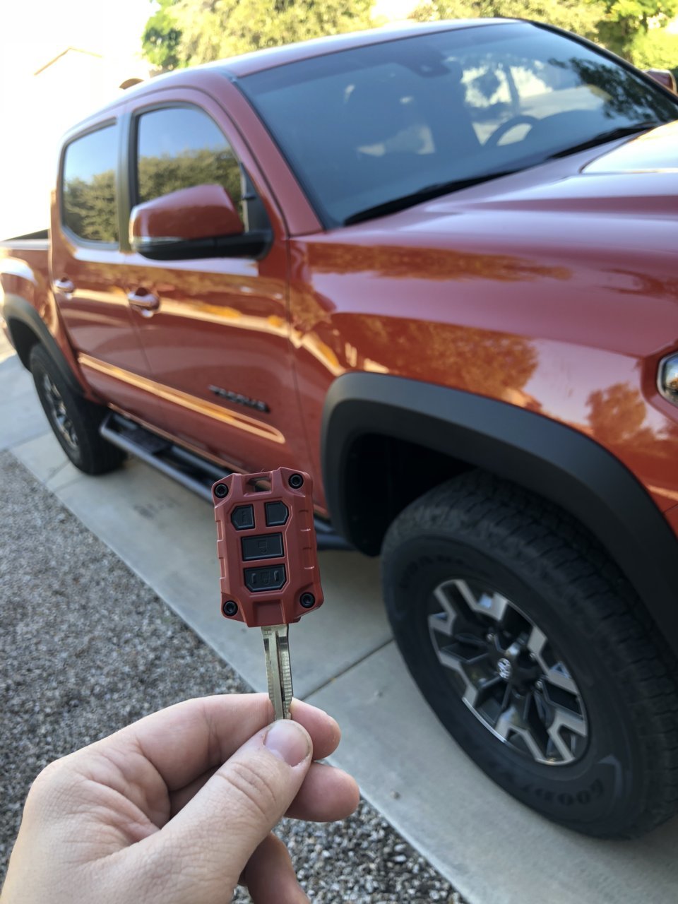

    Trd knob

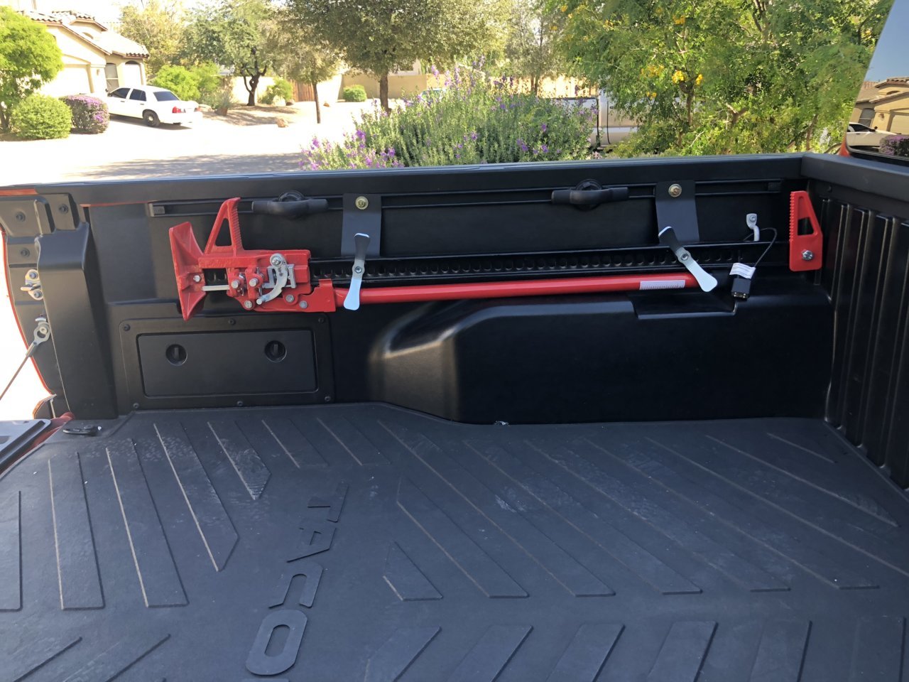

    Jack and pistol safe are on

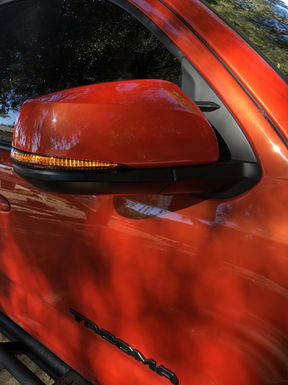

    Meso side marks, on the way to black it all out

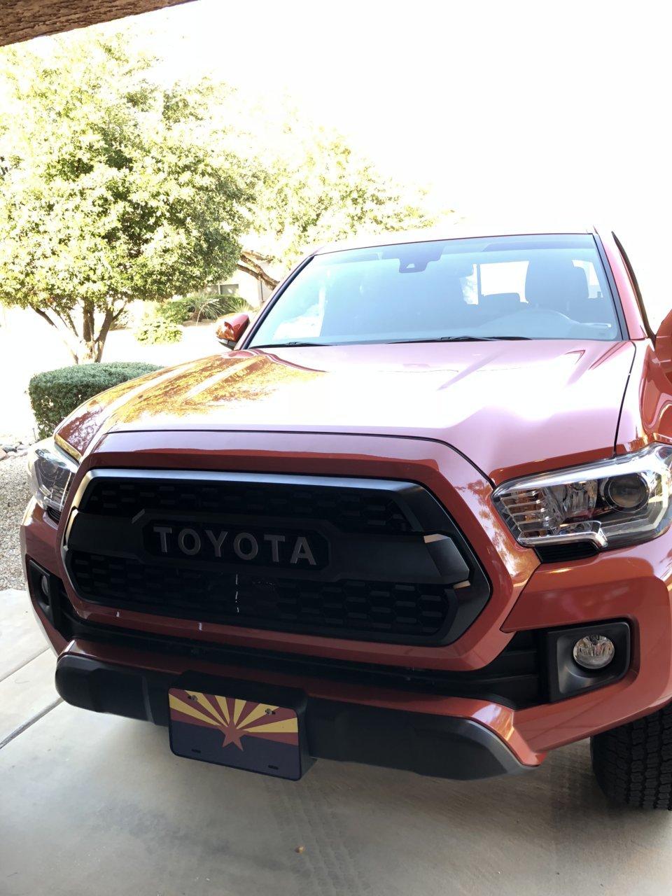

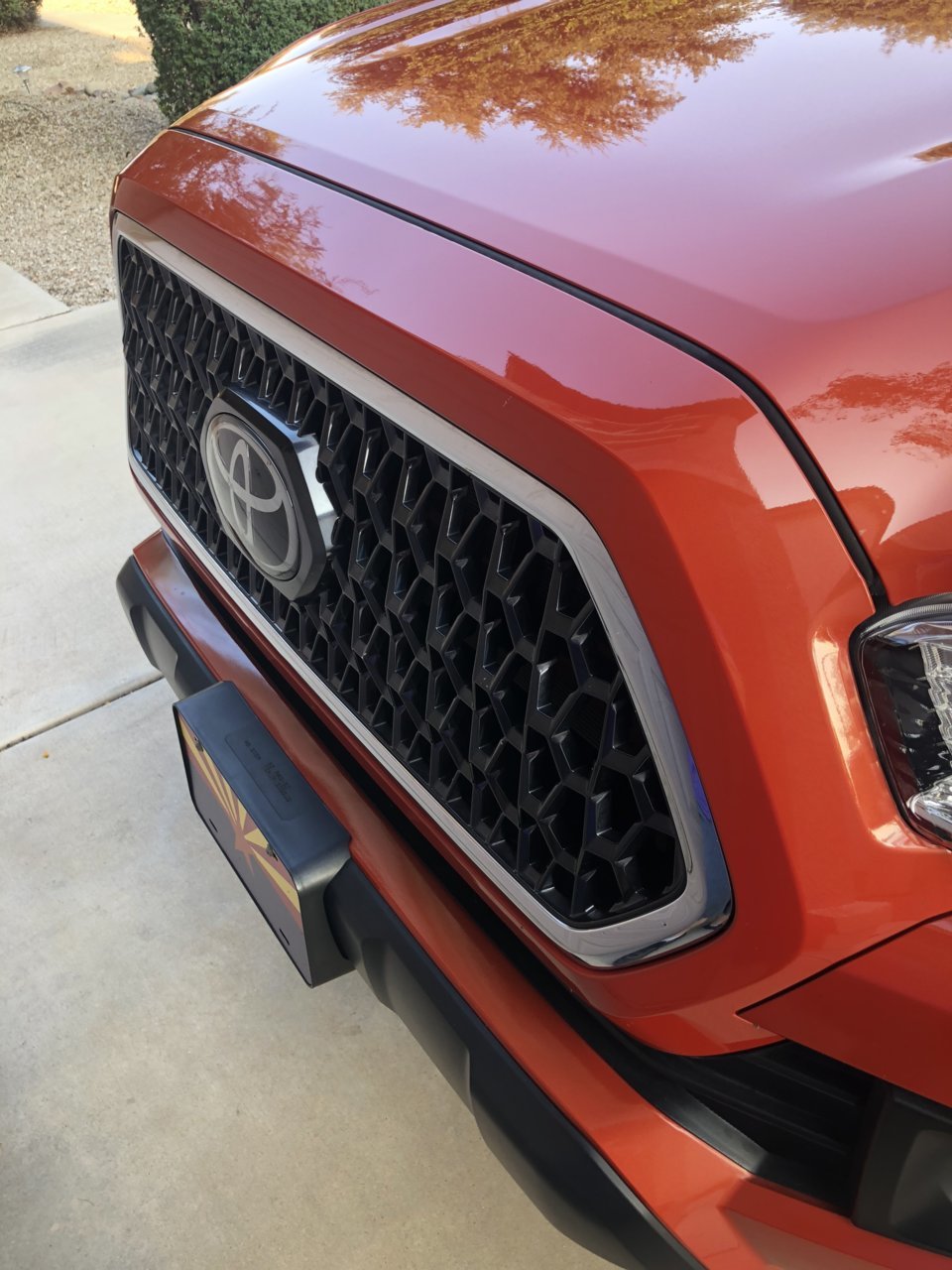

    TRD grill is on

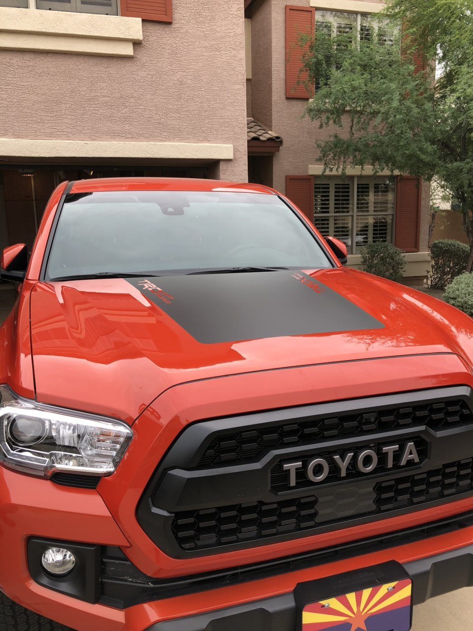

    Hood decal is up. Took awhile but with help it’s easy enough. Tacoma-world buddy and his wife got the bed decals on
    Decided to try out the spray to see how it matches

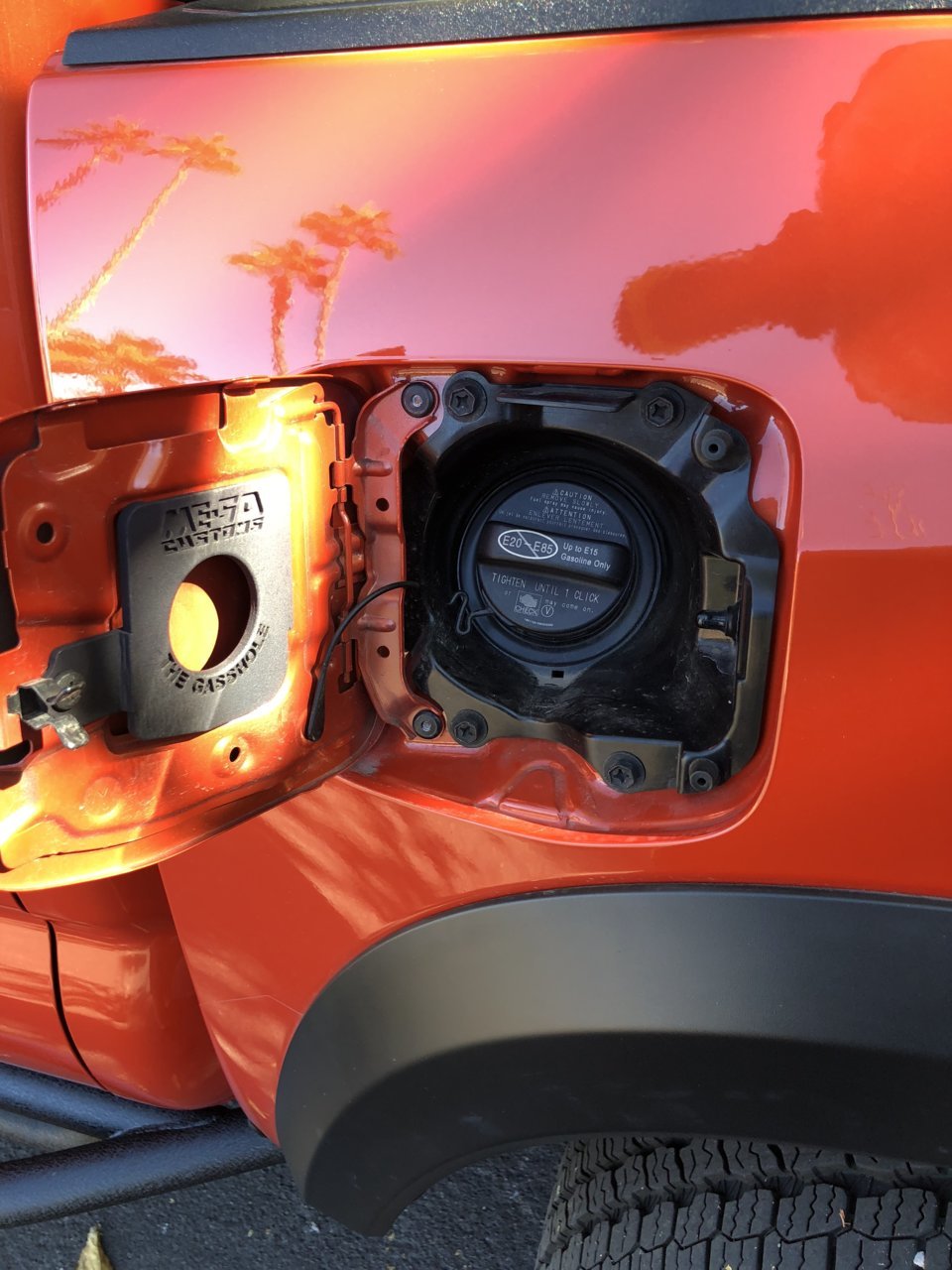

    Meso has hole

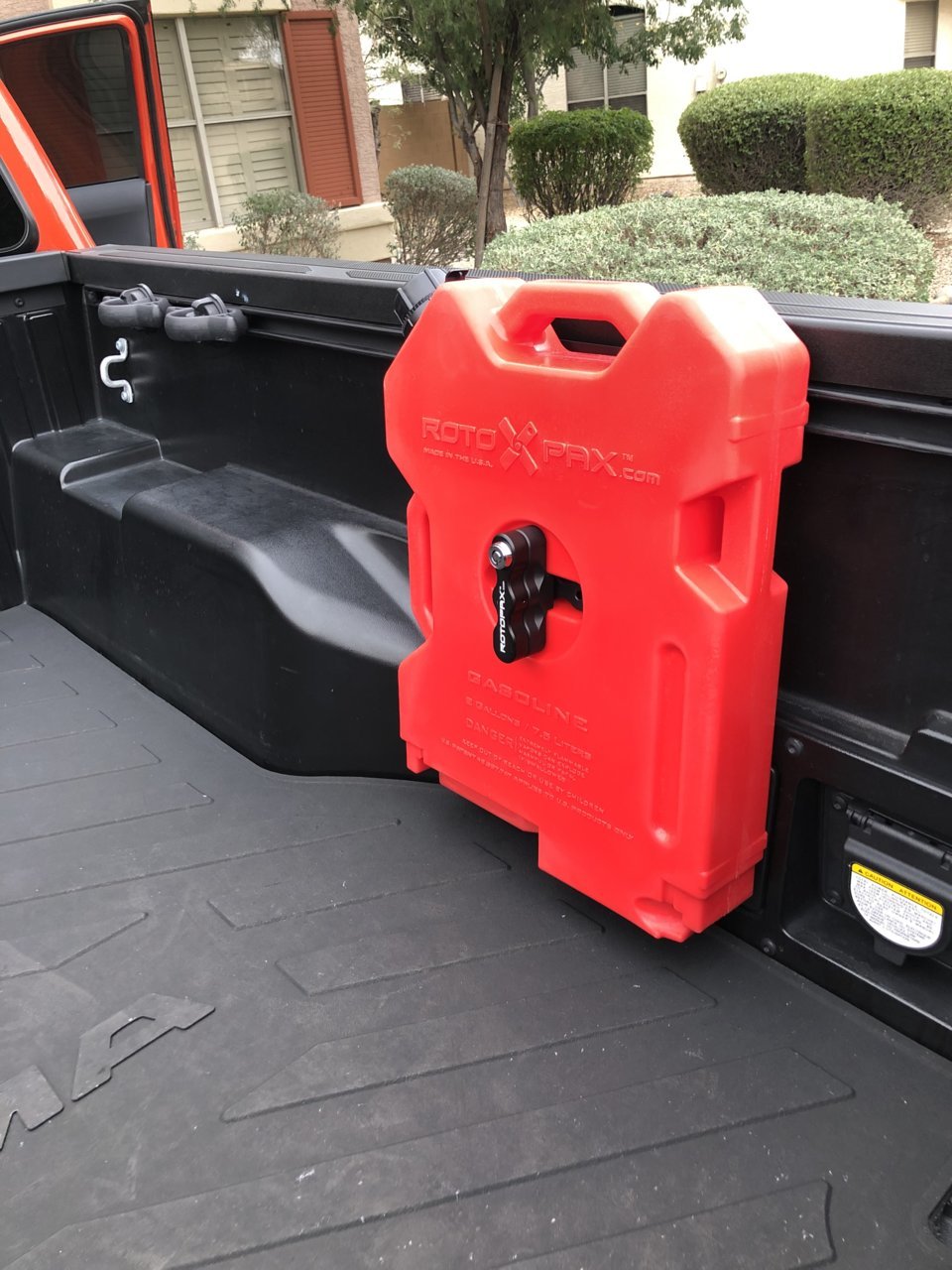

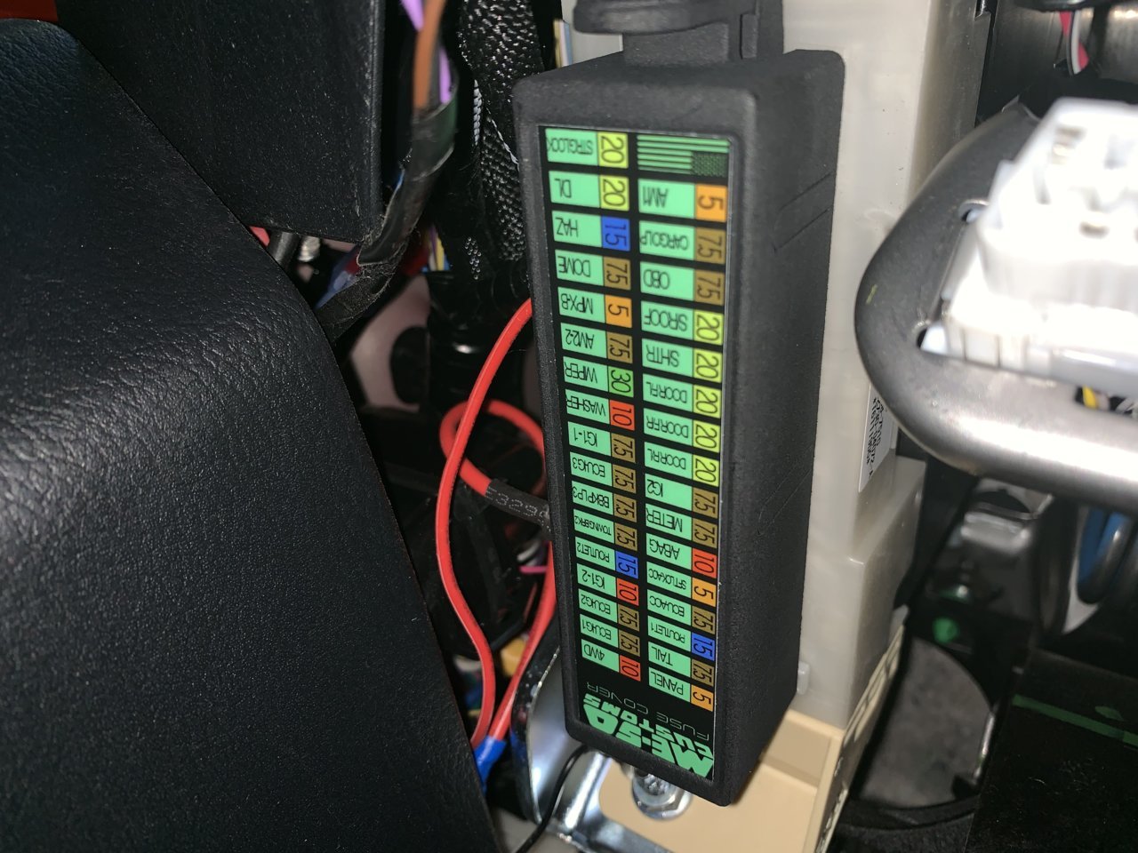

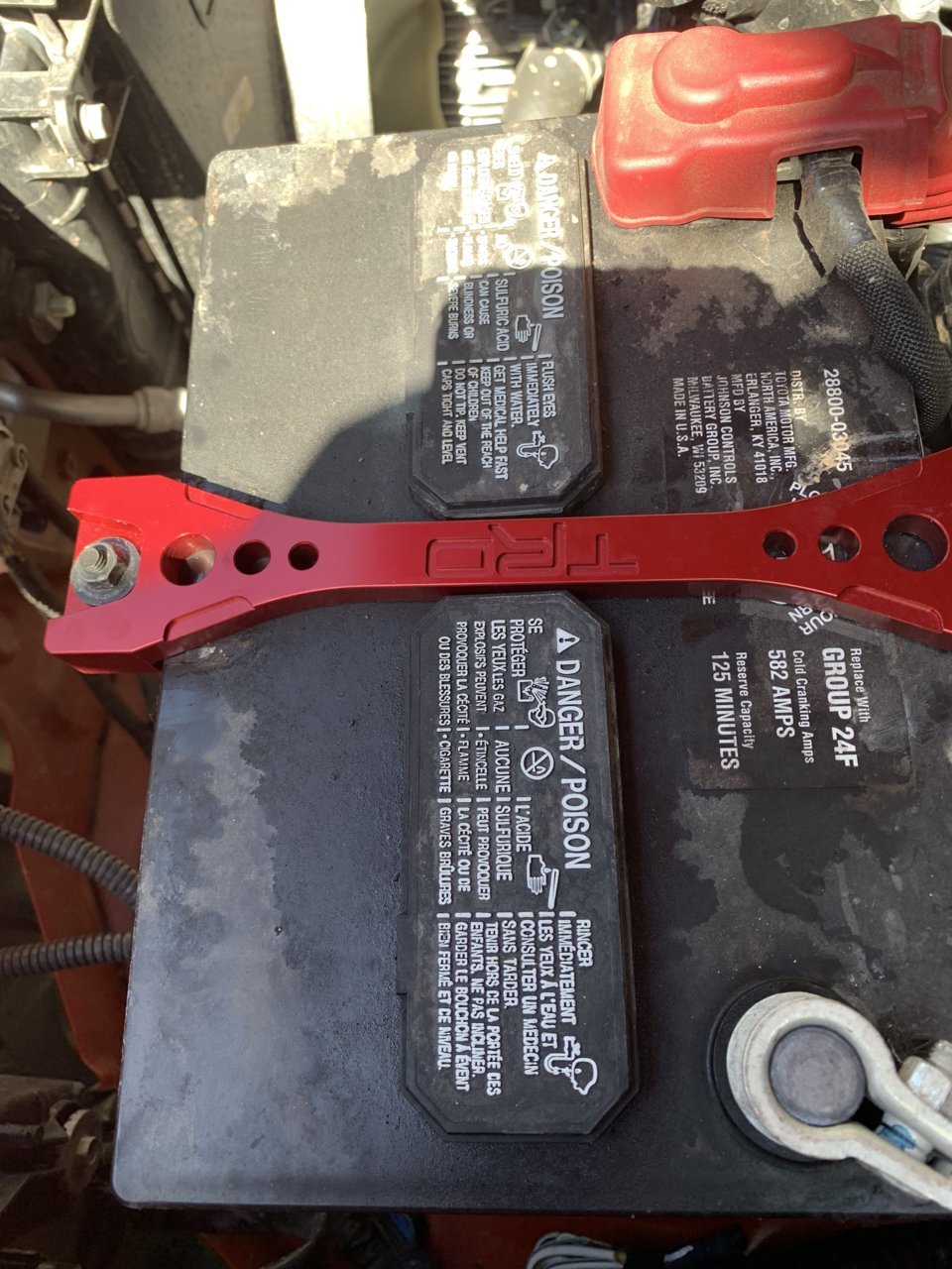

    Got the mod pile down with the fire extinguisher, battery holder, and meso fuse cover

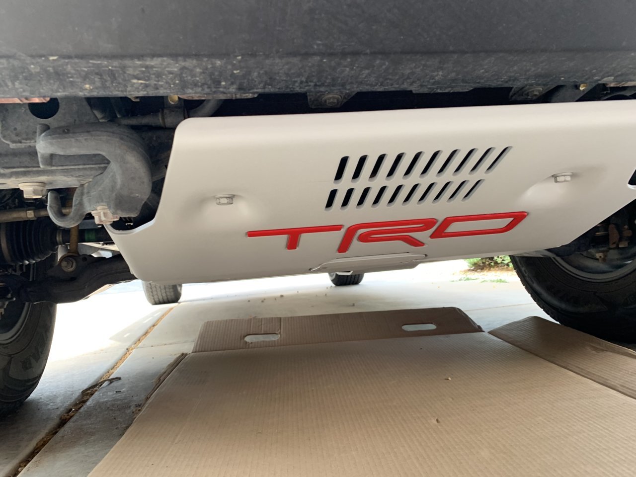

    Trd skid plate went on Thursday, Saturday it took its first dent

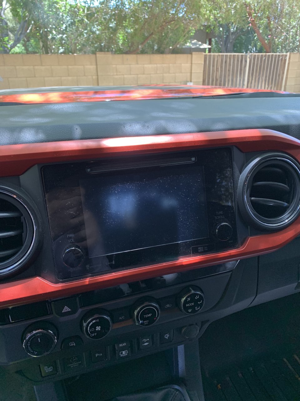

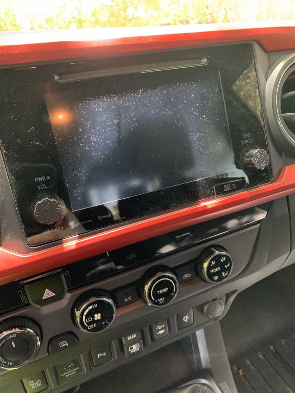

    Got the dash orange trim, matches pretty well
    Also put on some knew knobs

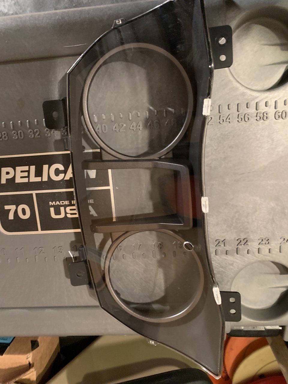

    Ended up scratching gauge cluster so took it all out to replace it

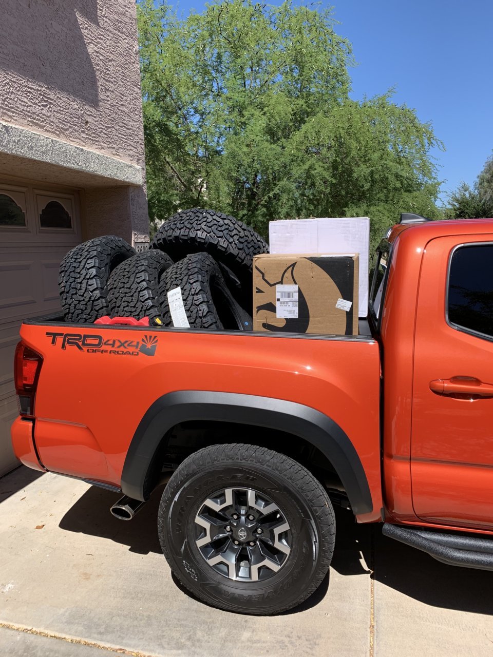

    Icon rxt
    Icon Delta UCAs
    Fox 2.5 extended with 700lbs king springs
    Fox 2.0 w/ resi
    KO2 285/70/17
    TRD 17 wheels
    AVID off-road bolt on sliders

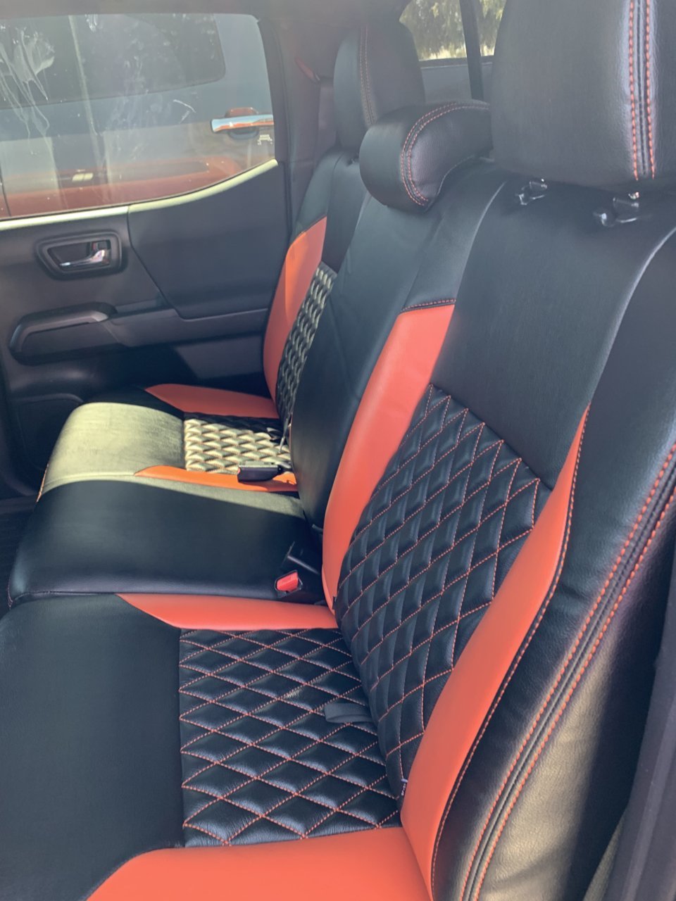

    Those seats though! Nice build so far. Inferno owner myself.

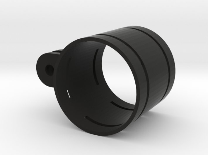

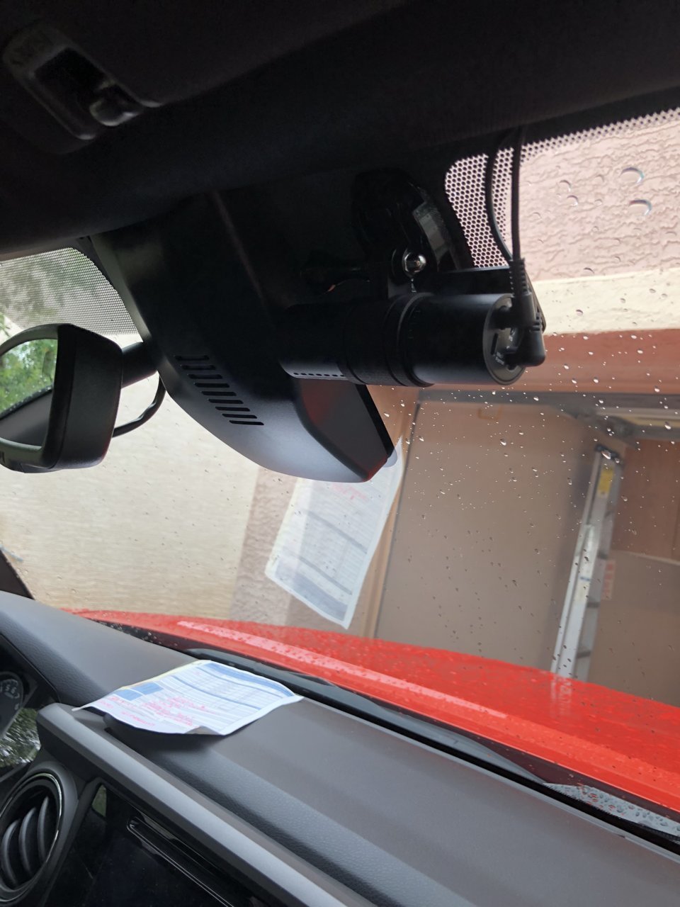

    I just ordered a Blackvue 900S dual channel camera system, to add to my new Tacoma, and see that you also have one installed. Are you running it upside down, and then changing the orientation in the software? From looking at photos of the camera orientation, it looks like it needs to be installed a different way.
    I'd like to install mine on the right side of the mirror, but with the lens at one end of the tube, I'm confused on how it's supposed to be oriented. Also, is that the stock mount that comes with the camera?
    Thanks.

    Hey, mine is right side up with the lens on the left of the tube but I’m also running a older 5900 dual channel at the moment. The mount was one I found on shapeways so I could mount the camera to the go pro mount the truck came with. Regular mount works great, I just wanted to use the mount that was already there. So far it’s been really solid, my wife has a 900 in her car and with the headunit / built in WiFi I might end up doing a 900 down the road, but also saving up for powder coat for s new bumper and bed rack as well as a winch. Here is the link https://www.shapeways.com/product/C...ment-received&utm_content=7&optionId=65462216

    Excellent! Thank you very much for that information, and the link!

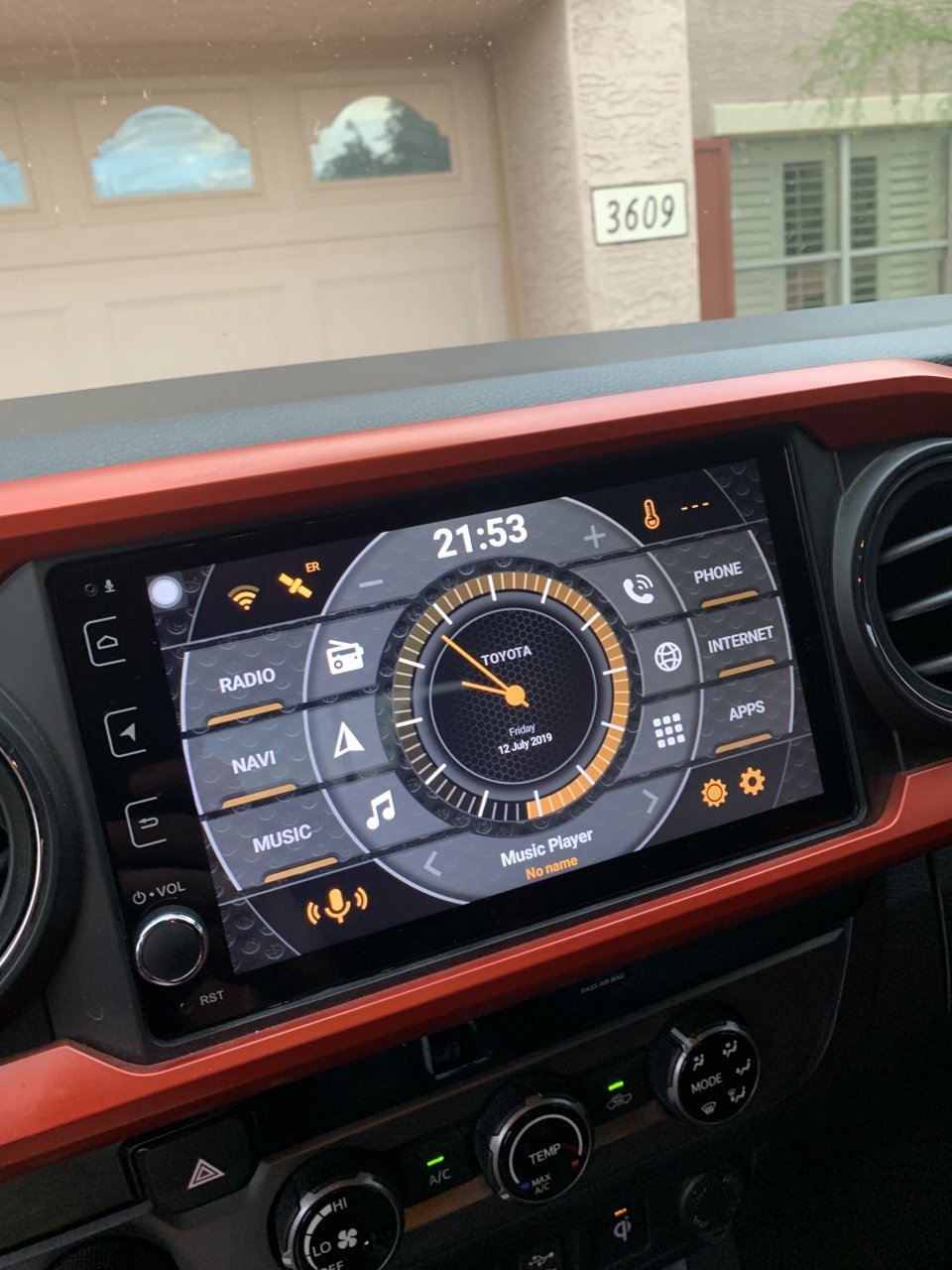

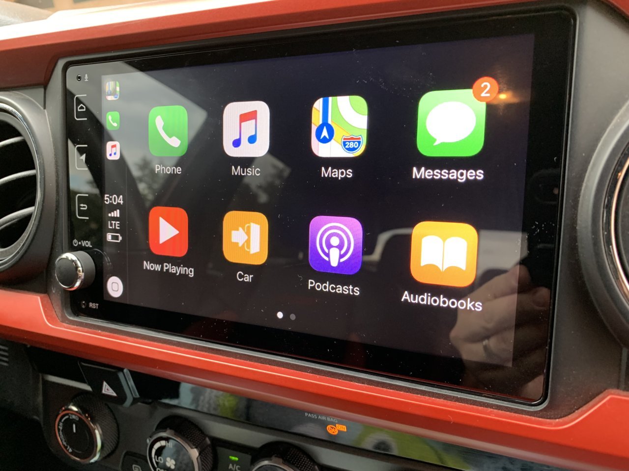

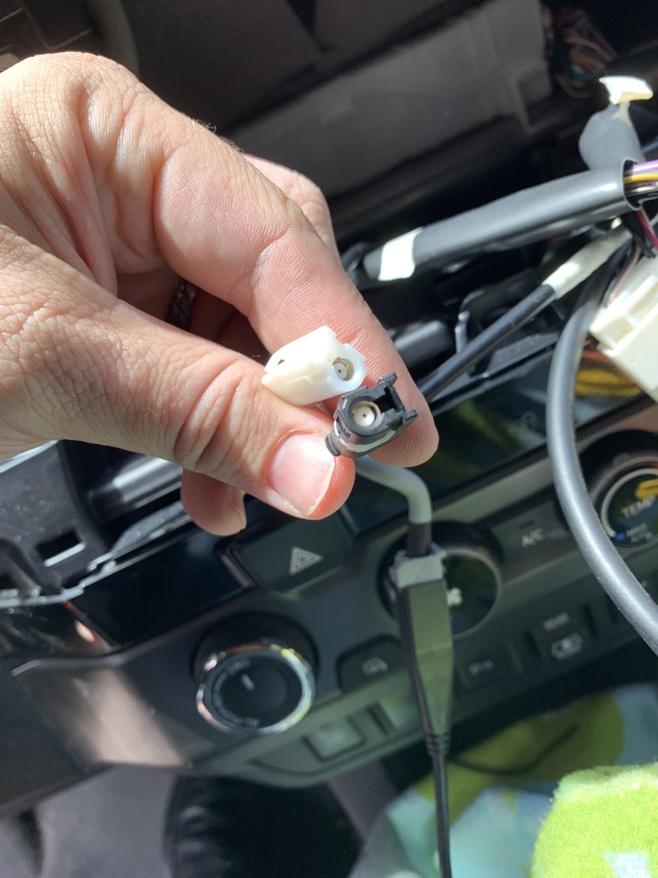

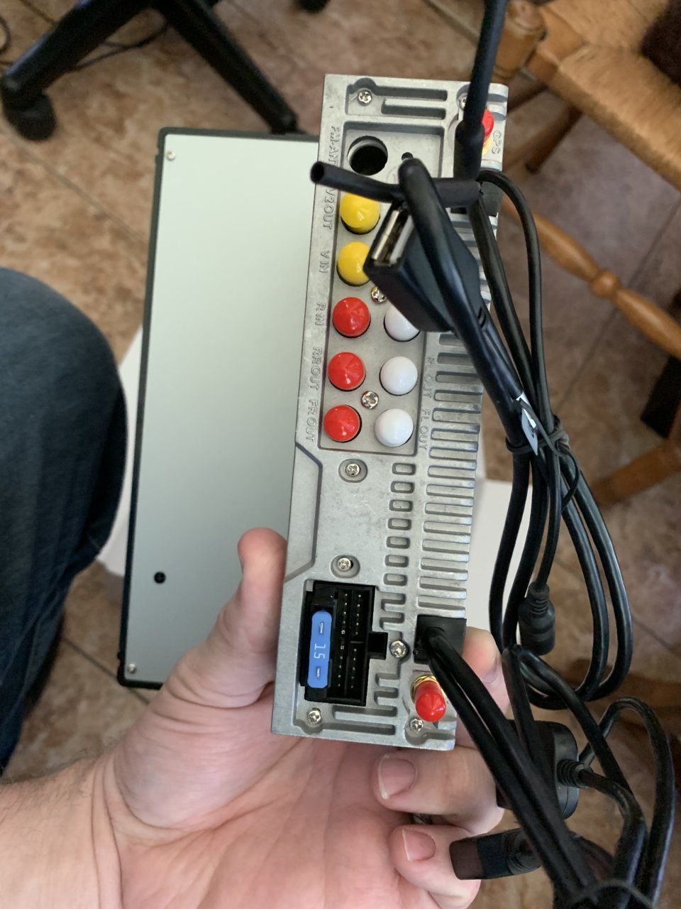

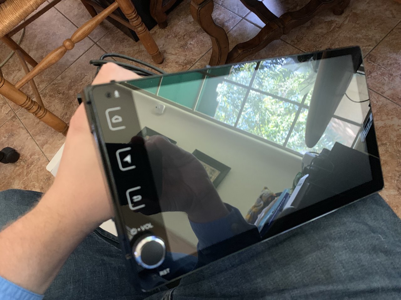

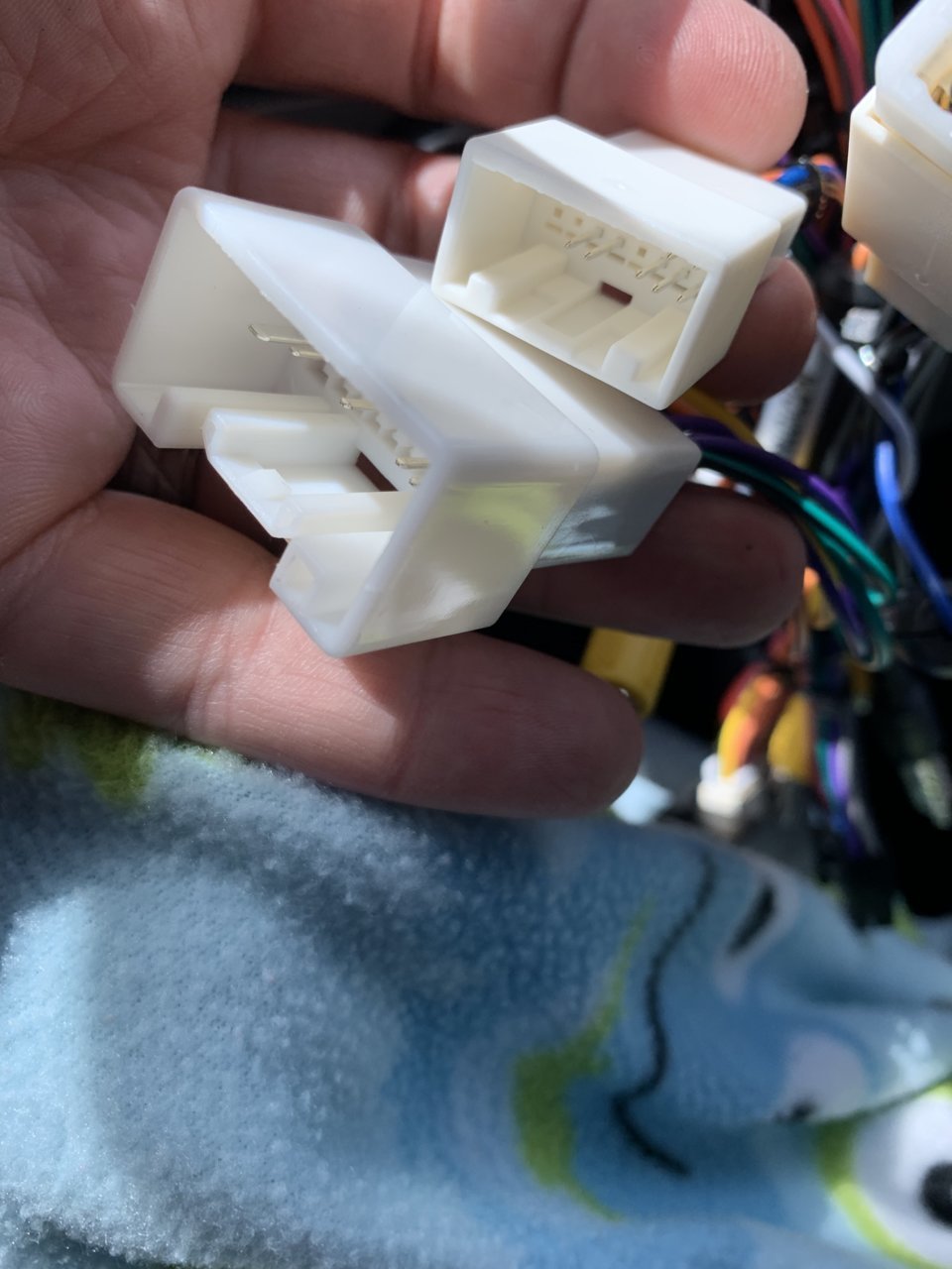

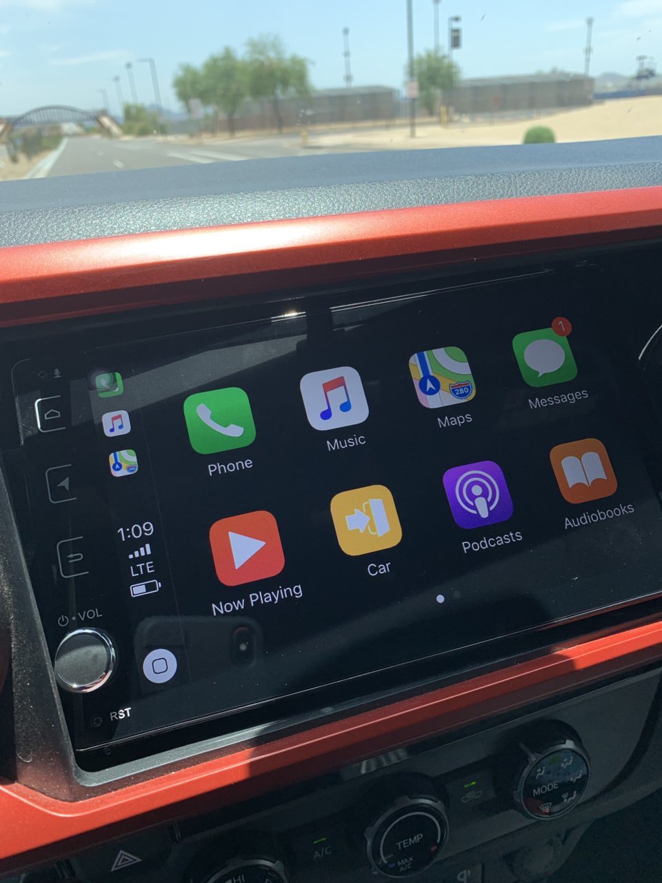

    So new head unit came in. The 2 plugs and two antenna plugs do not connect. 2 atennas are replaced with new ones and original plugs not connected haven’t seem to lose any functionality except navigation and songs on the cluster. Wireless car play works. Big problem is no mounting screws work right now so I’m on my way to Home Depot to pick new ones and get this mounted in. Only thing holding it in last picture is the trim
    (Stereo is not in, needed screws and now to cut mounts but wanted to show CarPlay works wirelessly)

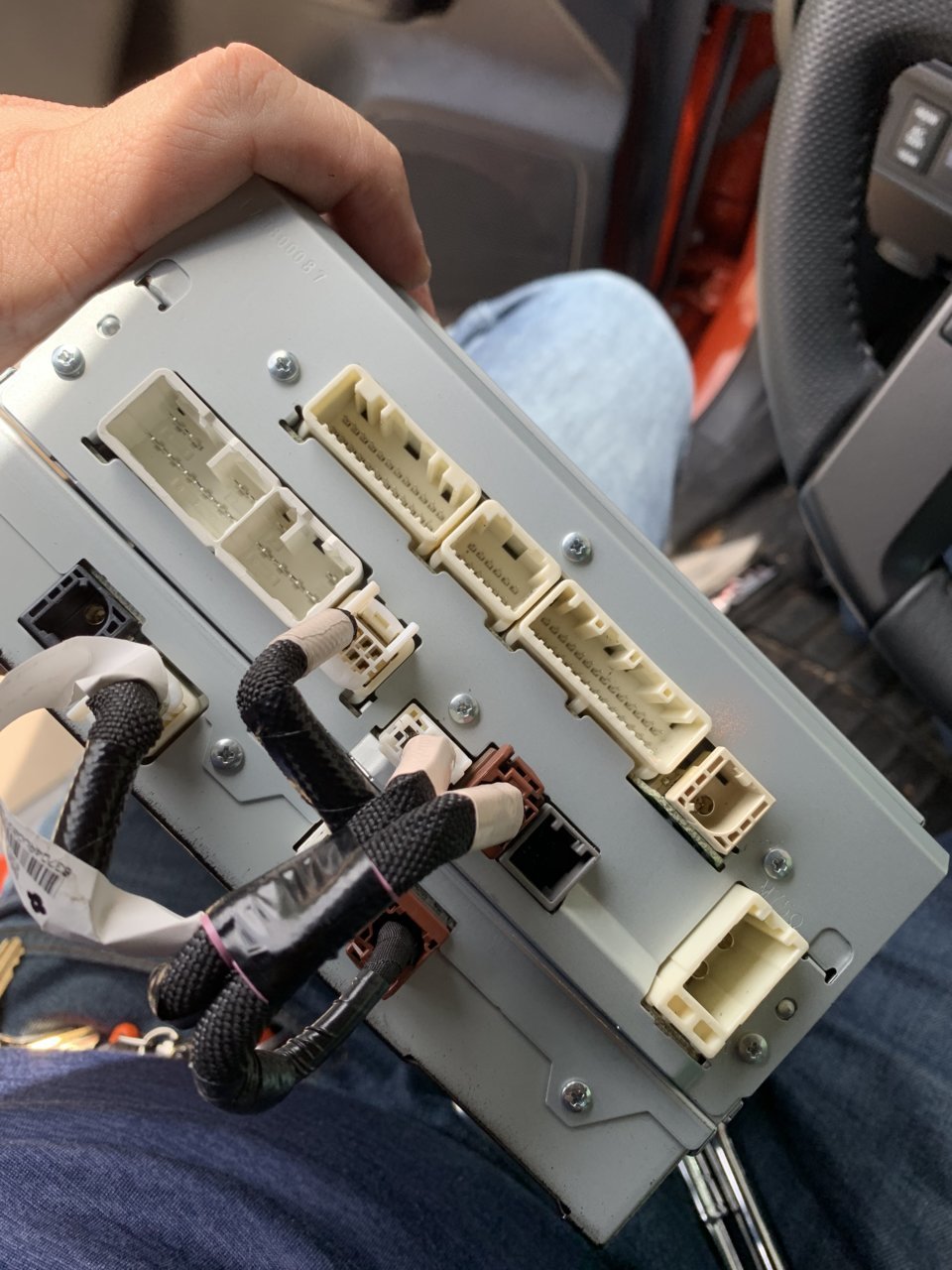

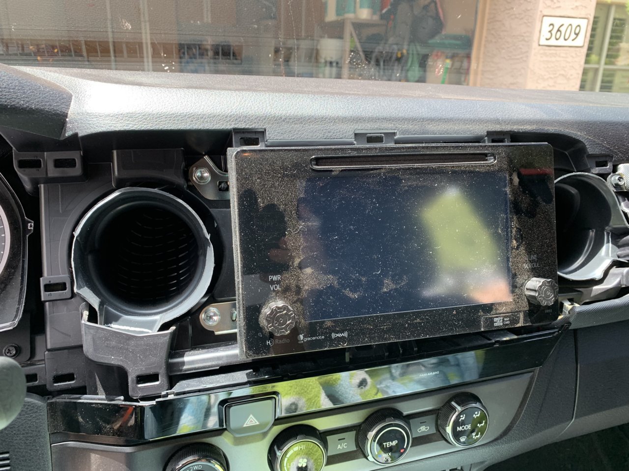

    I’ll try and mark it but 5nahalf is the pioneer here. So far
    Remove dash trim and take out the 4 10mm bolts
    After that disconnect everything until the radio looks like this. From there you will plug everything in except these wires
    Now plug everything in. Cables you should have are these.one is main wiring harness and the other is USB cord.
    RIN AND Lin are aux I believe. The you need to test the reverse camera as there are two rcas labeled and only one works. That plugs back into the wiring harness.usb goes to the usb wire that plugs into brown usb harness.
    Then plug the gps and 4g antenna in. I put these under the dash like

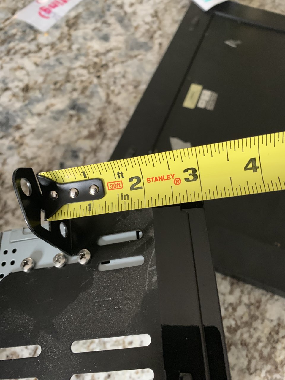

    @5nahalf suggested. I’ll update after I do mounting brackets but these are measurements from scosche kit
    Right now I am going to take off half inch and see where I am at so I’ll update it later tonight. It’s over 100 out right now. Wireless Apple play does work. You hook up Bluetooth and then WiFi between the two and click z link
    Next update, cuts made
    Taking a break for a few hours to make some dinner for family and get the kids bathed. Next is the test fit and measure
    Amchuge and cmntaco like this.

    That little white dot on the left side is the app "touch assistant" you can turn it off there
