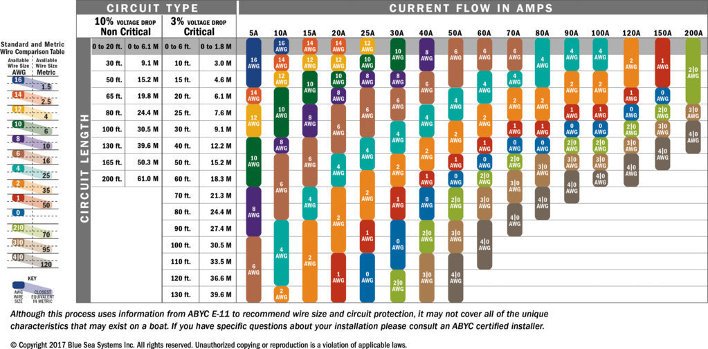

    This chart was posted in another thread recently... Maybe help?

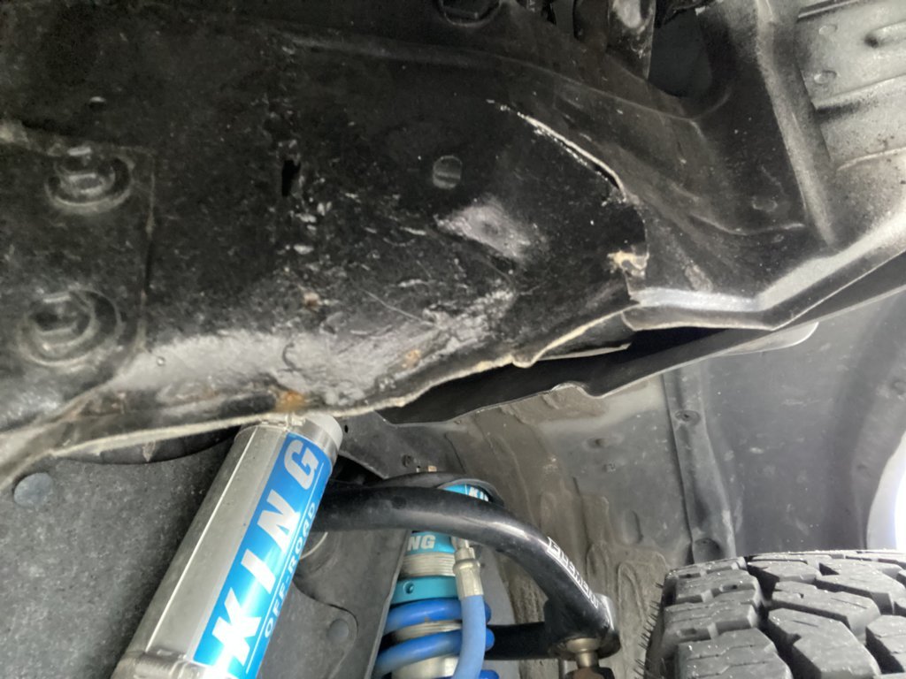

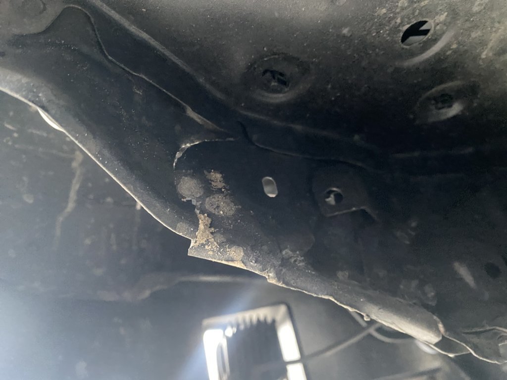

    Op- if you do a dual battery kit(mounted under hood on fender), the inner fender liner and core support will crack with mild off-roading. I have had mine repaired(welded and plated on backside) a few months back, but it seems every trip i spring a new crack. Will be ordering the JD fab kit to relocate the battery to the rear instead of over the wheel/headlight, then fix the fender liners and support. Factory core supports and fender liners are thin gauge, glued and “spot welded” together(most cost effective, but least structurally stiff[likely for crash ratings now that i think of it]). It’s a common issue with the weight of the battery over those “supports”IMG_9156.jpg IMG_9156.jpg IMG_9154.jpg

    Don’t over think it. DC in not like AC, length matters! Determine your load (amps) and length and do the calculation from a chart. Don’t do the jumper cables hook up. They expect short term use and are not rated for heat dispersion long term. Think about making it a short as possible even if you have to reposition stuff.

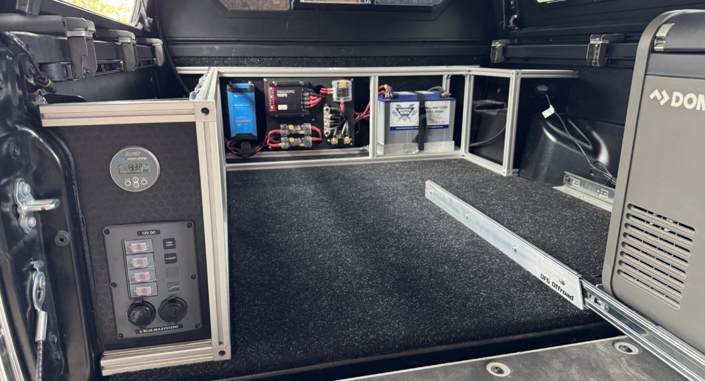

    I put in a 4/0 Marine grade (tinned strands) from front to back. My application is powering anything I may install in the future as well a rear winch. Using the frame as a ground return. Currently on this run is a refrigerator and inverter; while using the winch it won't matter what the other power users are getting as voltage, as winch use is intermittent.

    I went off the Redarc chart which called for 4 gauge for that distance.

    This is largely unrelated to the battery. I only went up one battery size, and my passenger side has identical damage and I've added zero weight over there. It's got a lot more to do with how hard I've been on the truck off road vs the weight of the battery itself.

    This is good to hear, as I have put two Optimas in the original battery position and one over on the passenger side just forward of the firewall. "Knowing" about the sheet metal fatigue I beefed up both sides after hearing about the problems with battery weight.

    Agree as well. That seems more like metal fatigue from flexing of the truck & suspension over off-road undulations (urethane body bushing kits are said to increase the stress on those areas too, which would make sense since they allow less movement between the frame & body than rubber does).
