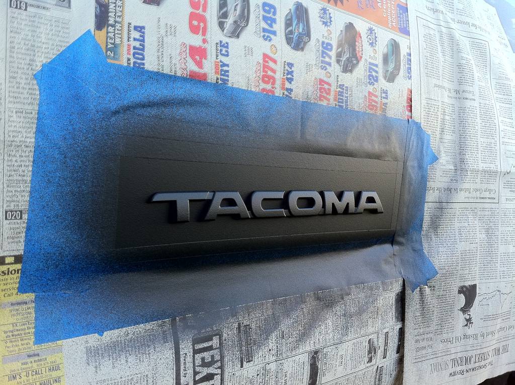

    ryansummit
    ryansummit Well-Known Member
    Mar 19, 2012
    #75173
    51
    NY
    POWERLESS '08 v6 4x4 access cab
    smoke tails, safety rack, coffee stains, caulk, paint, tar, sawdust, foul odor
    sweet effin ride man
    when you sprayed your badges
    it looks like you masked off couple inches away
    from actual badge
    did you just clean/wipe overspray
    or did you tape right to badge
    or am i missing somethin
    got a can of spray
    waiting for your orders

    I taped just as shown and sprayed it just like that. Remove the newspaper and then the tape. You should then be left with a clean rectangle of thick over-spray and your letters. Just peel/pull from a corner of the derp rectangle and it will release off the paint and pull cleanly away from the letters leaving them covered in derp.

    ryansummit
    Mar 19, 2012
    #75173
    51
    NY
    ahh gotcha
    derp meaning plasti-dip
    im gonna use krylon fusion
    so i think ill mask right to the letters
    that other stuff seems nice though
    if it just releases thats awesome
    thanks for the info
    if i can get my ride lookin half as badass as yours
    ill be psyched
