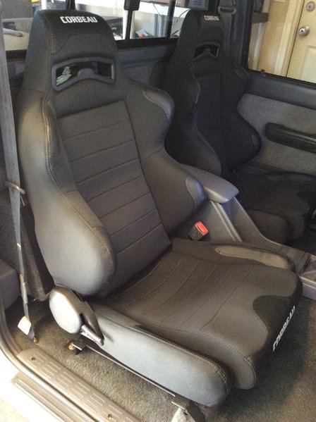

  11. Feb 10, 2014 at 9:30 AM
    Scubatoe
    Scubatoe [OP] Nice Marmot
    Oct 23, 2011
    #65711
    14
    Steve
    Fallon, NV
    04 V6 TRD
    Here you go. I tried taking better pictures this morning, but they actually come out a lot better without a bright, backlit window behind them.
    Quality is great. The GTS IIs cradle you in the seatback really well. They're definitely worlds more comfortable than the stock buckets - especially mine which had 130,000 miles.
    The thigh bolsters are pretty aggressive, as you can see. It requires some climbing over to get in and out of the seat. The rails on my truck come in handy for this. I definitely had to revise my mount/dismount technique with these seats. I haven't done any wheeling in them yet, but they definitely feel like they'll hold you pretty solid.
    My first ride in them, I thought maybe I'd made a mistake going with a seat that was too aggressive. The thigh bolsters definitely let you know they are there, and feel like they may create some uncomfortable pressure points for long hauls. They are definitely breaking in, though. I've had the drivers side in for three weeks now, and the thigh bolsters seem to be conforming to me. If you're a stick figure, they should present no problems - I'm 5'10", 200#. The seat lowers feel like they would be more comfortable if they were tilted up, providing more support under the thighs - my knees hang over a few inches. Further break-in may allow me to sit further back in the seat - we'll see.
    What pushed me over the edge to buy new seats was a 3 day drive in the stock seats that left my back destroyed. From purely that standpoint (better seats for my back), I think I would have done better going with some less aggressive seats, like the sport seats or Moab. However, it was hard for me to justify the expense of new seats to myself if they weren't going to be a drastic improvement over stock. Since very few retailers actually carry any seats in stock, I wasn't able to try out these specific seats before I bought them. Because of that, "drastic improvement" in my mind was driven more by look than by feel of the seats. I was able to try similar seats at Summit Racing, and learned that I did not like the feel of racing seats with shoulder bolsters - which I was VERY tempted to buy just on look.
    Overall, while I think that the GTS IIs aren't the best daily driver choice, I think they'll be a good compromise between improved comfort over the stock seats, and vastly better support while offroading. I'll report back after I've had a chance to bomb around offroad. They definitely inspire more confidence in mountain twisties.:D
