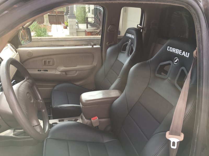

    They fit just fine...you need to buy the bracket for your taco year...got the baja xrs...needed to buy grade 8steel bolts for seat belts...the seat belt bolts on the stock seats are welded to the stock seats. You will need to use a dremel to shave off the excess bolt to fit next to the arm rest...Plus when installing be sure to unplug the battery before unplugging the airbag sensor on the seatbelt...one of the best mods Ive done as you enjoy the comfort every time you get in the ride. Took about an hour...its worth it to get the lumbar support IMG_4457.jpg IMG_4459.jpg

    I have the Baja XRS as well....fit great, perfect height like @Prayn4surf stated just buy the correct brackets and you are good to go! Don't waste your money on reupholstering your seats will still be stock uncomfortable seats.....trust me I know

    Yeah no worries, I was worried about that too, but the sit identical to the stock...just getting up here in Cali

    I assume you mean Baja XP??? That's a fixed back seat...aka no adjustability, not sure your gonna be happy going that route. Just my .02 but if your even considering Corbeau seats, save up enough money or go the PayPal credit route...etc and get what your are gonna really like in the long run. The Baja XRS are great seats and fit like stock seats....I mean if your 6'8" and that worried your heads gonna be on the roof then get a Honda Element :rofl:all kidding aside I can get your measurement later but if you look at the pic he posted you can pretty much tell the height by looking at the passenger seat in reference to the seat belt.

    Actually, I meant the Baja RS. From the pic the XRS does look pretty similar in height, compared to my stock seats, when looking at the door. I am guessing the RS will be the same. I am 6'1" and I am sitting as high up in the truck as I want to be, right now

    The height of wear your arse will be resting is 4" from the floor...measured by the base of driver side door, head rest is 9+ inches from the ceiling...don't pay for a recovering of your seats, and like log cabins said, the non reclining seats will not be comfortable...save your money and get new ones...I'm 6'1" and 185 lbs n wish I did this six years ago
