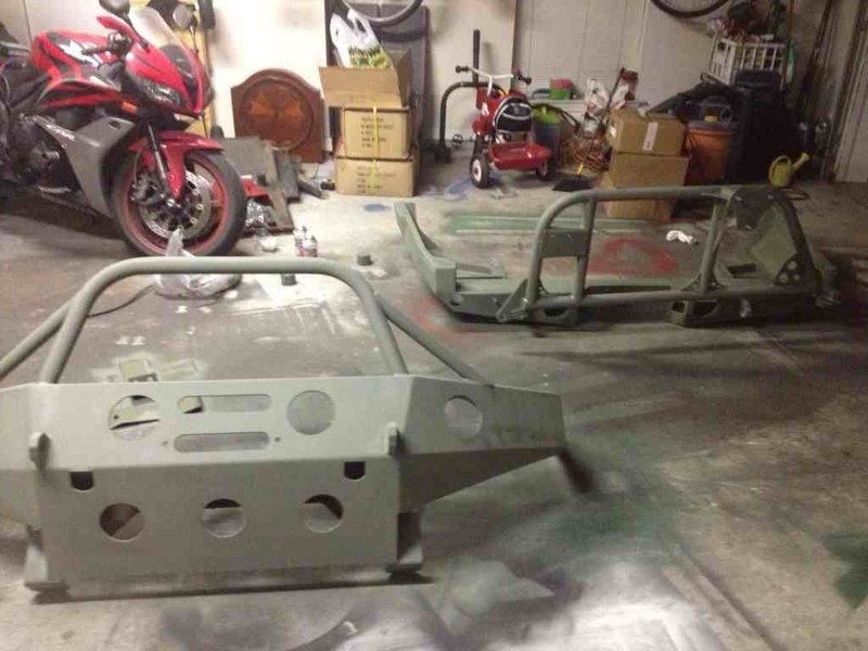

    Self etching primer - First coat. One more can oughta finish up what is left.

    Thanks - I'm pretty stoked myself. Might be next week before I can get into the paint booth tho...Primer I'll do rattle can in the garage...the satin black is going on with a compressed air set up...just gotta wait for time to jump into the shop. Might redo the wheels too...And the grille.

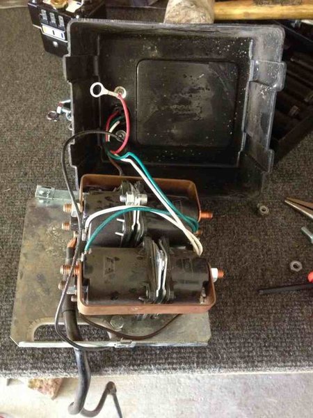

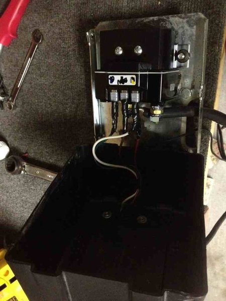

    Working on winch set up today. Ordered an accessory cutoff kit - Offroad lights, winch, eventual OBA and locker systems will all run off it. Started working on the solenoid pack for the 9.5xp I've got.
    Started here:
    Ended up here:
    I have to wait to figure out where to mount the box and mount the bumper to cut the high-load wires for the contactor to the motor.

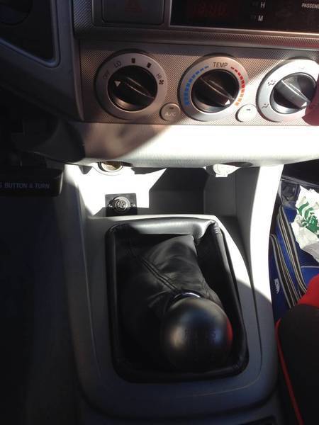

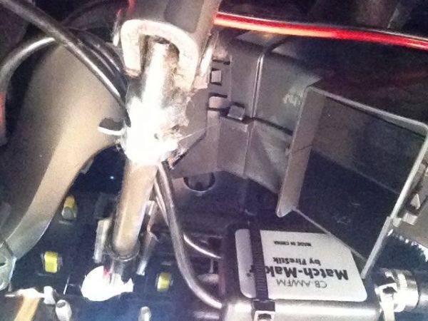

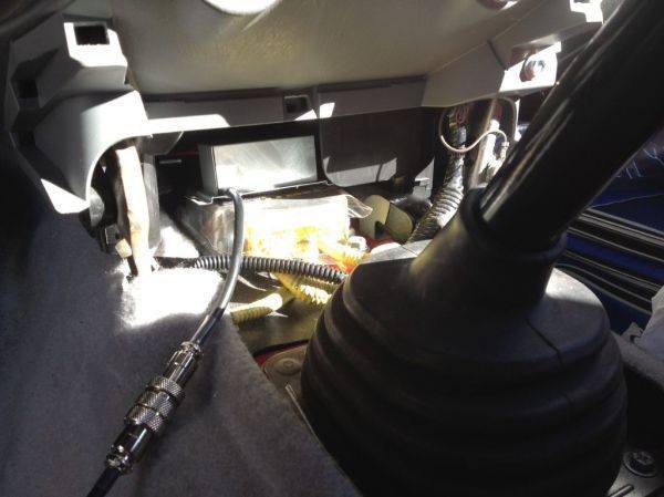

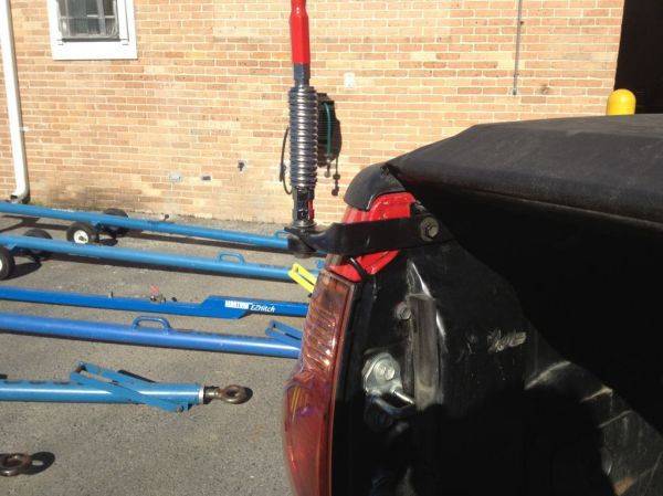

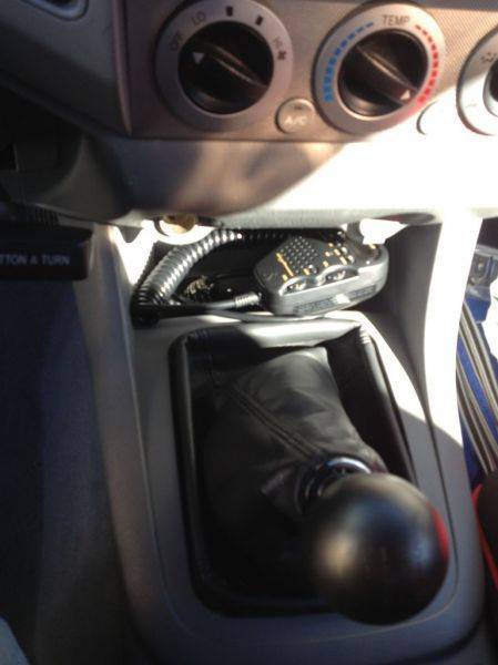

    So in the meantime - I did this:

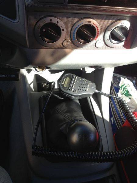

    Cobra 75 WXST under the radio: [​IMG]
    Going to have to move the transmitter box to try and attenuate some of the static when the truck is running.
    Matchmaker Box:
    FM radio sounds GREAT and the CB is good too.
    Final product plugged in and tested:
    Works great and for temp storage that cubby is awesome.
    And for when I'm not using it:
    DWrecks mount is awesome:

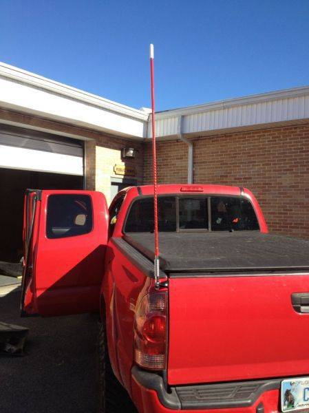

    3' Firestik, HD spring, FireRing coax.
    It all came in at 1.0 SWR without any changes or work on my part. There is a bit of static when the truck is running that goes away immediatly upon killing the ignition - So I'm sure it's because of how close I had to route wires and place boxes to other eletrical system items. Any one built or bought shielding for CB components??

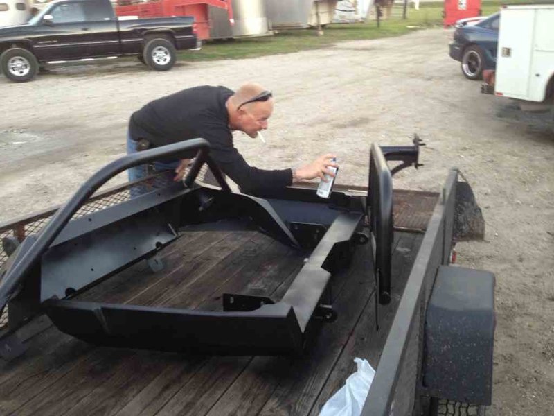

    Getting them painted. Not exactly what I had in mind for a spot, but my buddy (pictured) couldn't get us into his shop. Going back to finish up today and hopefully hanging the front this weekend w/ the winch. Gotta find a set of tin nippers to cut the bedsides in order to install the rear.
