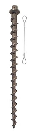

    We started using 46" earth anchors for setting tower guy wires. They are basically large screws, like this:
    We use a 1/2" impact driver to set them.
    I originally thought that the Milwaukee numbers must be inflated (model 2967, 1600 ft-lb), so I compared it with my Ingersoll-Rand (1200 ft-lb) 1/2" impact driver for one installation. The IR got the anchor within 4" of completion and just couldn't drive it further. The Milwaukee was able to finish the last 4 inches. I was amazed at the power!
    The downside of using the 2967 is that it will chew through batteries. It used two 5AH batteries to set one of the anchors.
    I no longer use my IR impacts. I have switched to using the Milwaukee (1/2" and 3/8").

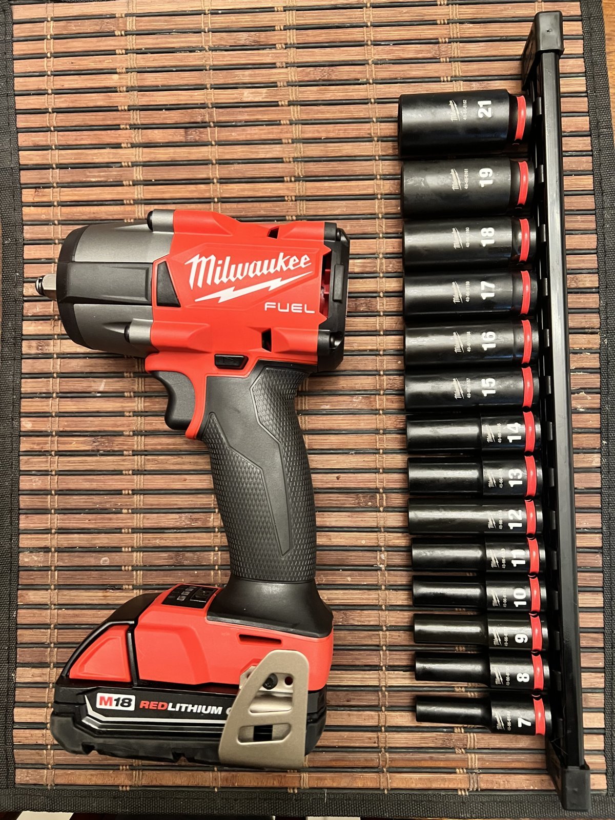

    Sockets arrived
