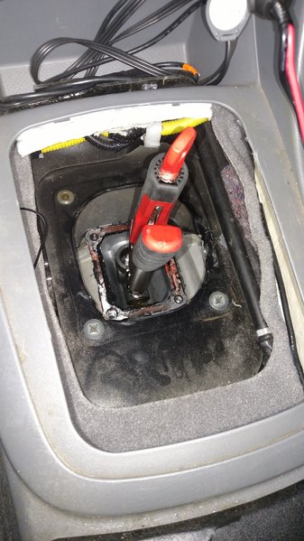

    IMG_20150430_061203035.jpg this is my short shifter after my urd one broke the stock one off rite at the neck down

    That sucks. Replacing it with a Core shift kit?
