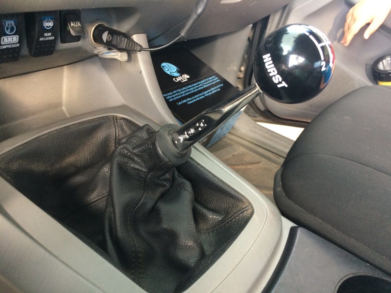

    I installed the core/hurst on my taco today. The noise is negligible. I ordered it 2 weeks ago, it shipped to me in 10 days.
    I can confirm it came with a stick relocation bracket already installed. The stick is dead center in the boot like the factory and it angles towards the driver. What a difference in feel! 1,000 times better. Reverse is slightly harder to engage but not bad. The install was easy, fitting the console over the new shifter was not a problem whatsoever. Thanks for all of the previous write ups, I did have to give the old shifter a good whack with a hammer to break it loose.
    I used Moly grease on the new plastic shifter bushing-it wasn't greased very well out-of-the-box. A box cutter's razor blade made quick work in prepping to remove old sealant on the old shifter.
    So far I'm happy with the purchase and thrilled the install was so easy. It took me 3.5 hours but most of that was me cleaning interior bits that were newly exposed (previous owner must have decided to pour out a coke all inside the console area!)

    Just finished installing the Core shifter on my 06 reg cab. The feel is much better than stock. The one thing about the R155F is the breather that was installed on the stock unit and the lack of one on the Core shifter. I contacted Core and they said their shifter is vented internally so there is no need for an external one.

    I don't have pics yet. Just installed mine on my 07 xrunner. I did cut the bottom boot per the instructions and it was difficult to get that part back on. The shifter handle, I didn't use the cheap lock washers that it came with. Instead I used thick washers and red locktite. I haven't really driven it yet other than to pull it down the driveway. It seems like the knob height is higher, and reverse took a hard slap to get in. I'm contemplating swapping to a weighted knob.
    I've been waiting to also replace the gear oil, used redline mt90. With the shifter off & trans drained, I was able to dump it in through the top instead of dealing with those pumps.

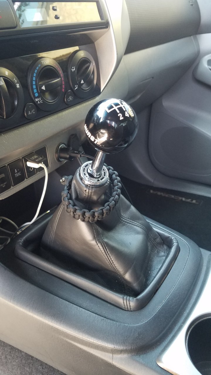

    Last week, I did the hurst core short shifter install, also dumped gear oil and filled with redline mt90. 4.0, 6 speed manual 2007 xrunner.
    Overall it definitely feels better. I thought my stock shifter handle had mushed epoxy. The handle wasn’t perfect but the white bushing was totally destroyed.
    The new shifter is taller. It feels nice and firm, notchy, short throws. I did the acumulator delete mod months ago, replaced the leaking clutch master cylinder a few weeks ago, then the hurst shifter and gear oil change recently.
    Here’s my question. I’m getting what might be described as a grinding noise that’s closer to sanding, similar to a really bad vacuum leak. If I rest my hand on the shifter knob, I can tell the noise is coming through the shifter. Yesterday I drove it about 15 miles, the noise seemed to go away as it got warmed up. Today the noise is still there but, not as loud, again as it warmed up the noise subsided. Should I be concerned about this noise or is it normal?

    The stock shifter has sound deadener within the stick. The Core-Hurst stick does not so you will hear gear noise . You can stuff some type of insulation around the base of the stick or wrap the base of the stick with something like an old bicycle tube.

    Thanks, I like the tire tube suggestion. One of the reasons for going to the hurst was my stock sound deadening epoxy was failing, or at least so I thought. My white bushing was completely failed, the stock stick was going but not as bad as I thought it would be. If Gadget had a stick to trade with me I would have done that along with the urd ss kit.
    My concern was that the noise isn’t normal. I’ll give the wrap it in rubber idea a try.
