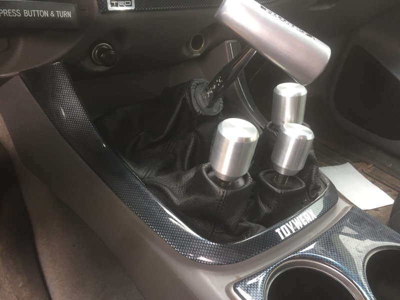

    Thought you guys might find this interesting and/or weird.
    I cut and welded the Hurst arm to make it about 4" shorter, leaning toward the driver's side a bit more, and a little more erect. Note this shifter is combined with the URD short shifter, for ultrasuper shortness. It literally feels like a race car shifter now.
    I accidentally posted this on the 3rd gen shifter thread first, and the guys there said I should make a video showing the throw distance. I'll do that sometime this week and post it on my youtube channel...

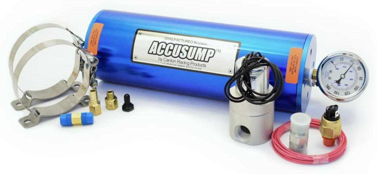

    What is the "oil accumulator solenoid?" A mod?
    (As we speak, I'm trying my google-fu too)

    The device is more commonly known as Canton's Accumsump. Mine is a Moroso device though. My accumulator solenoid valve is operated manually through the center console switch, so I turn it on right before startup to flood the galleries with oil. I could also turn it on if I was going to floor it to pass someone on the highway, or at the drag strip if I manage to make it out there.
    Oh I don't know... I put some LED lights under there... :D
    If you're interested in the laundry list check out the build thread (link in my signature)

    I do the same, give it a smack to the left. My wrist is jacked up so it hurts every time. I swapped the hurst ball with a sick speed ball. It’s a little bigger and makes a surprising difference, less painful.
    The first one sick speed sent had a ding on it like it was dropped so they sent a replacement not asking for the bad one back. If interested I’ll send it to anyone who wants it along with the adapter, which fits the 3/8-16 pretty poorly. It’s the glow in the dark blue no shit pattern one. I used blue locktite so mine is on tight.
    Some reason the pic makes it look tiny compared to my finger

    Google hurst core shifter. There it is.
    Now that you have their kit, you’re stuck with a shifter that takes a 3/8-16 knob. There’s a few knobs out there but not many. The knob that comes with it is small, too small to me. It comes with a replacement bushing so no need to buy a new white bushing from Toyota.
    Another option is the urd kit which retains the stock arm and knob. Contact Gadget, and he’ll hook you up with a shortened re-epoxyed shifter arm if so desired. The rubber epoxy provides some cushion effects which I believe should also eliminate vibration noise the hurst makes. You should also replace the white shifter bushing.
    Several people here have one or the other. There’s others made but those 2 seem to be the most popular. It doesn’t take a ton of skill or special tools to install. There’s a couple videos you can find here. I utilized the opportunity to replace the gear oil at the same time. Far easier to dump it in from the top than trying to pump it in from the bottom.
    My defective ball from sick speed is spoken for already. I can’t knock them for sending me a defect, it happens, and they quickly sent a replacement without me having to jump through hoops.
