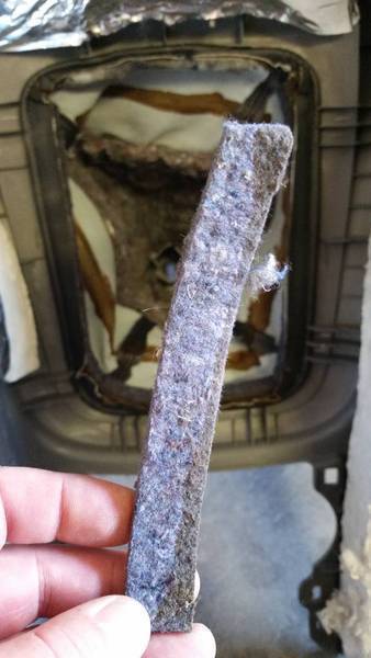

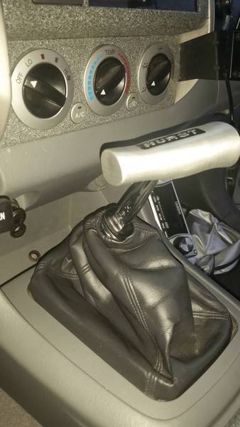

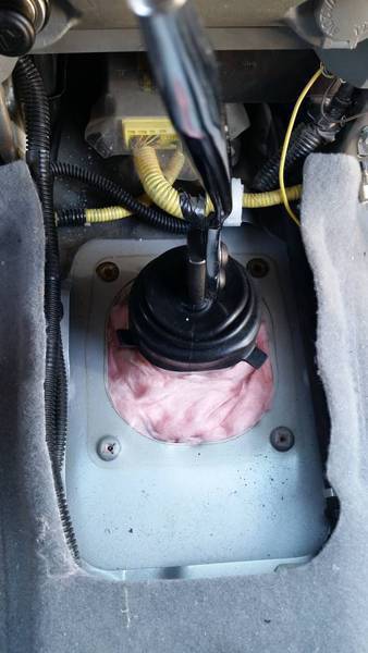

    I thought I'd provide a review of the shifter after over a month of use. Shifting was quite stiff at first, but is quite smooth now after breaking in. The notchiness of shifting before install is practically gone. The shifts are deliberate and smooth. 1st, 3rd, and 5th gears didn't feel like they were fully engaged so I removed the padding from inside the shifter boot to allow more room for the shifter to move forward, and now it is perfect (see photo below). I didn't mind the added gear noise, but decided to try to eliminate it by stuffing insulation around the the bottom of the shifter and into the cutout (see photo). Gear noise is almost entirely gone. The T-handle is awesome. I can't imagine ever using anything else. Nor can I imagine ever going back to the original shifter. Quick downshifts while offroad one of the biggest advantages that I have encountered. I simply love this upgrade.
    The piece of padding that I referred to[​IMG]
    And how I stuffed the insulation to reduce trans noise[​IMG]

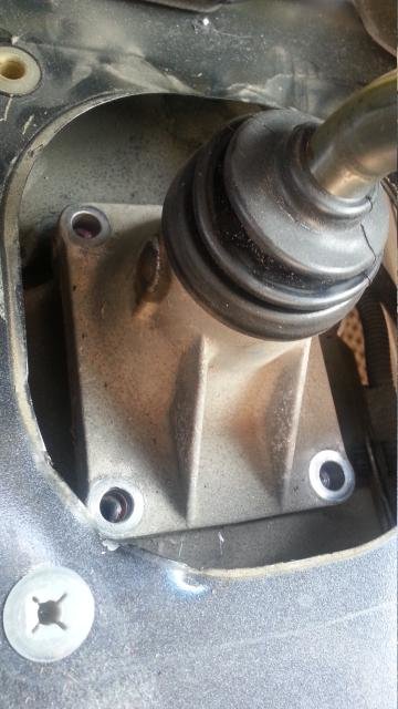

    Send a pic of what your shifter looks like right now. Mine came right off once all the fasteners were off.

    I got this far
    i took a break and installed some switches and ran out of time for the shifter so i can go to work.
