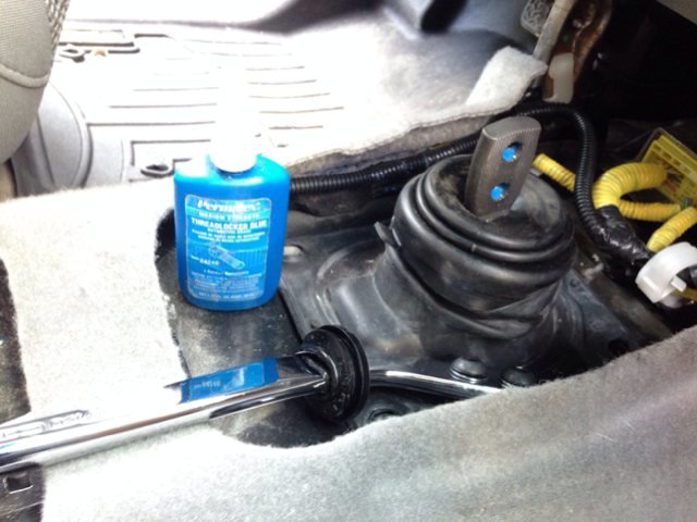

    Shit. Lost a bolt in the shifter today. I didn't use a torque wrench but I figured I had atleast 40. Gonna use thread lock, off-roading may not be too good for them. Upside I know what the click was.
  5. Sep 20, 2014 at 7:00 PM
    #165
    samiam
    samiam Always here, never there
    Apr 7, 2011
    #54533
    3,151
    Sam
    Stinky Vegas
    2008 TRD OR DCSB 4.0 6MT 1E7 Alu Cab
    Workin' on Workin' on it
    Threadlock is a good idea. I almost lost the shift stick one day. So what do you think the click is?

    The shifter moving in and out of those location grooves when the bolt backed out.

    I've got mine installed for about 2 months now, within the last 2 weeks, i've heard the "click" when in gear 4 & 6 and it's getting louder and louder. Also the play seems to be greater as well... It's making me nervous, gonna check the bolts now...

    Put some threadlock on while you're in there.

    That's how much treadlock I put on mine. lol. Mine hasn't backed out at all since the install.

    yeah! i only used threadlocker on the 4 bolts for the assembly, but torque the crap out of the 2 bolts for the stick. i guess that wasn't enough. The top bolt was tight but the bottom one was almost all the way out. I put some threadlocker on now, hopefully it'll stay in. 2 days gone by and so far so good!
