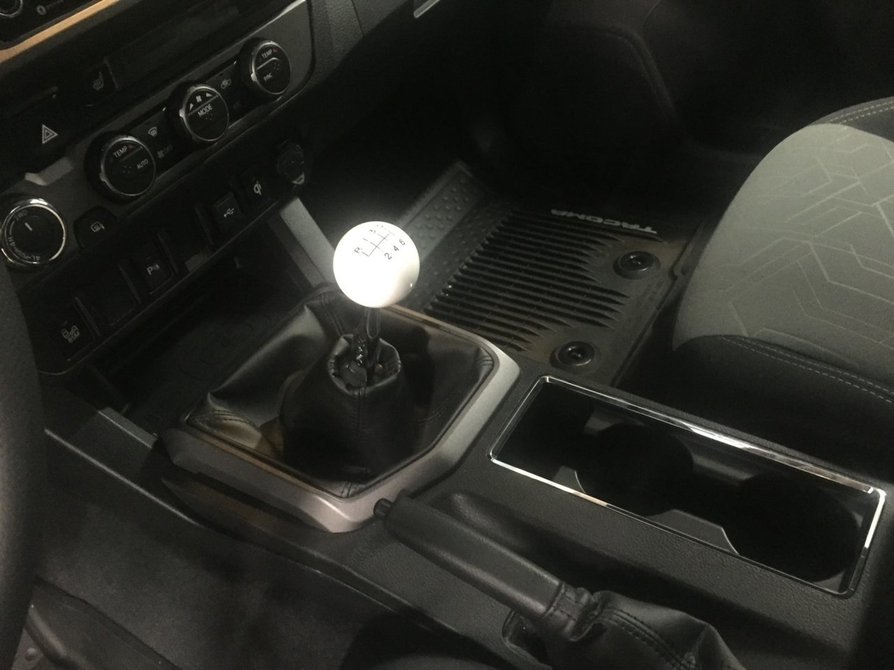

    There was a LITTLE bit of cussing involved but not TOO bad.

    nice knob. which one is that?

    Man! If I had a nickel for every time I’ve been asked that!!!
    It’s the white engraved with plain sides that I ordered with the shifter. I’ve always been partial to a white shifter ball.
    And this shifter ROCKS!
