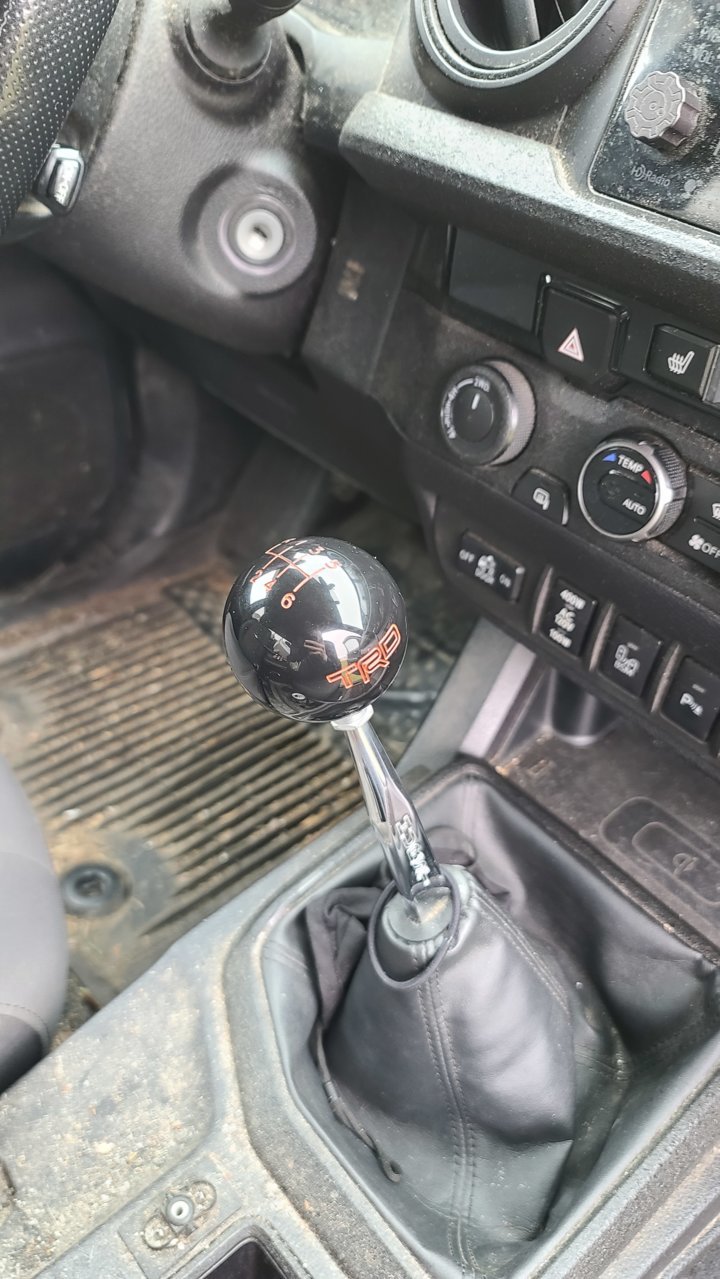

    Finally got my adaptor made so I can mount my trd ball to my core shifter. Love it. Wish I would have bought the core kit sooner lol.

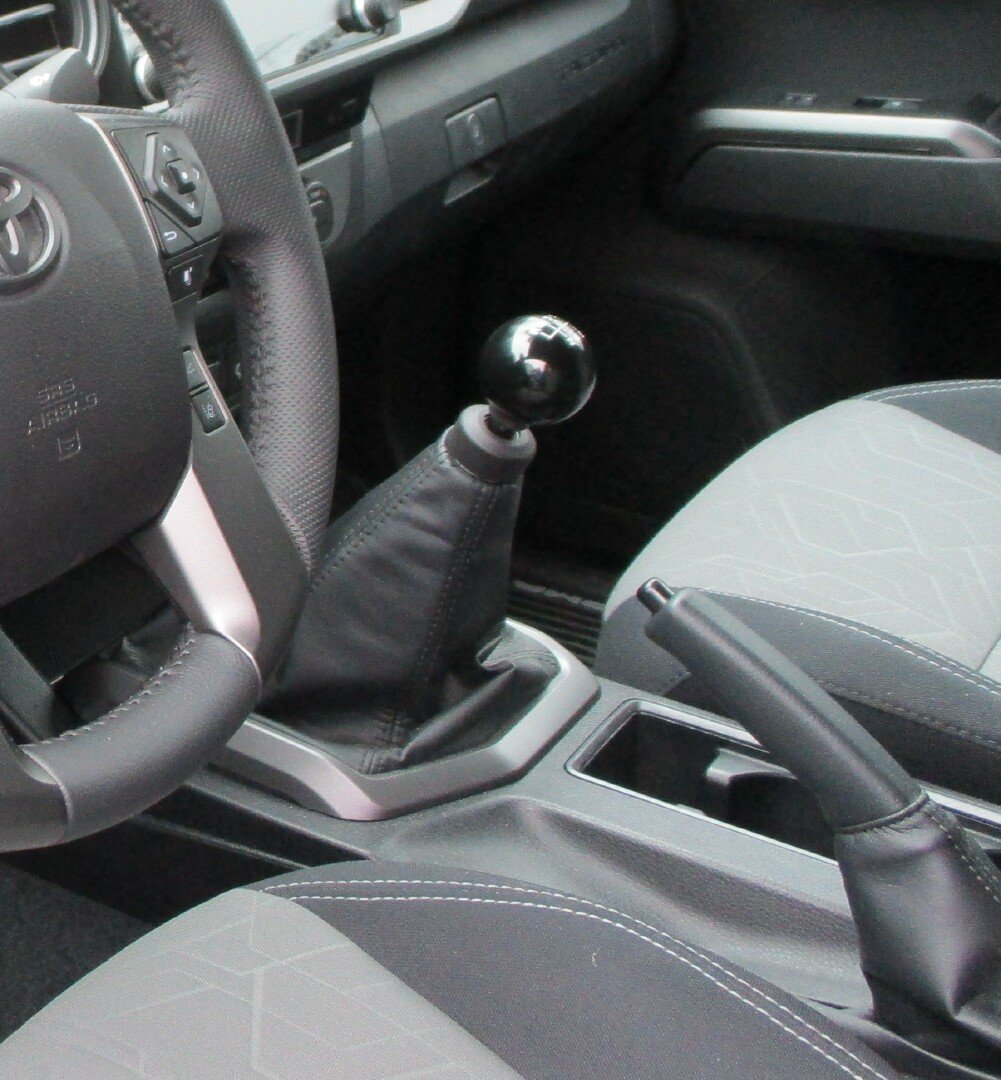

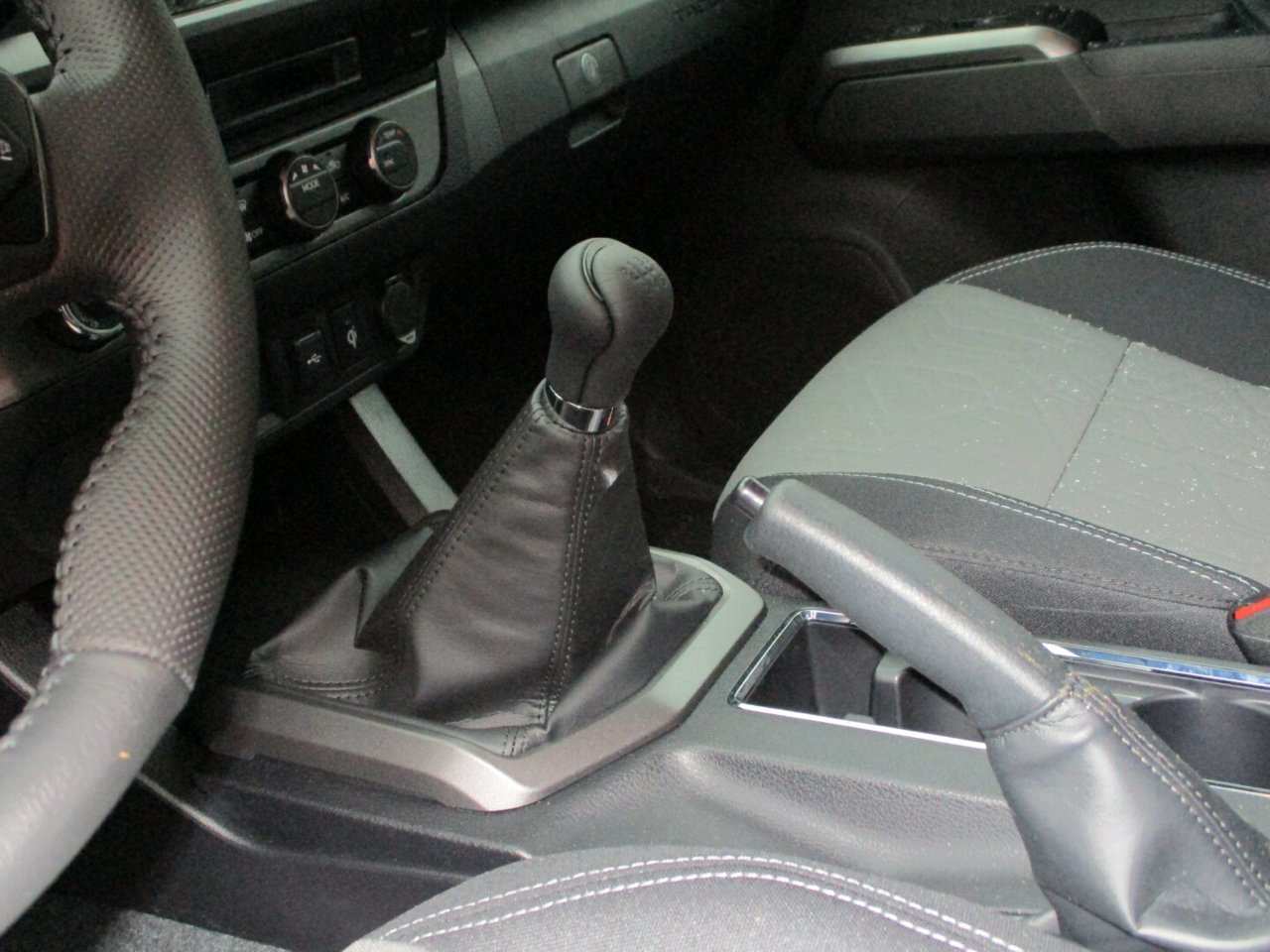

    I got the knob (only) from Core-Shifters. $40.21 including tax and shipping.
    Before:
    After:
