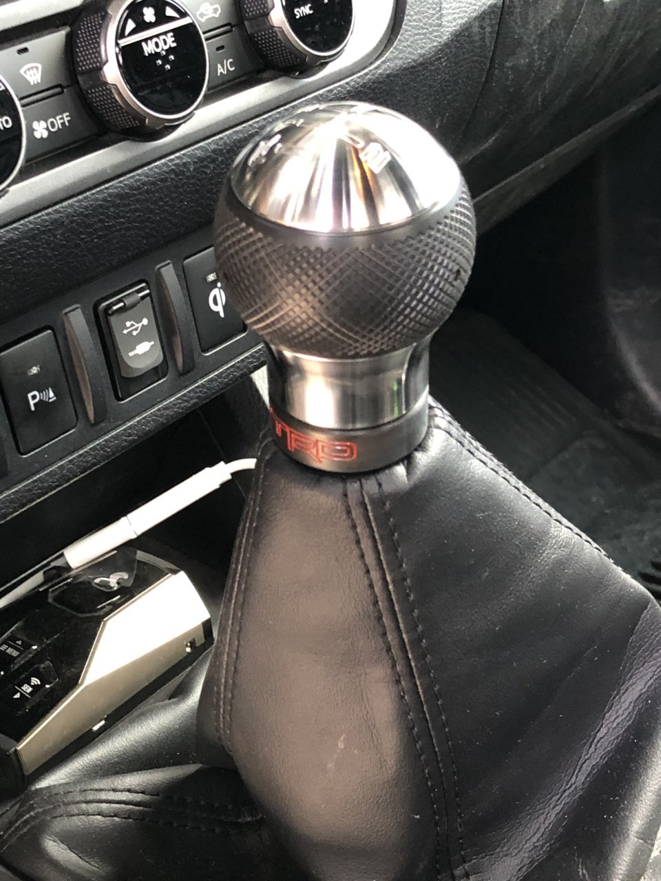

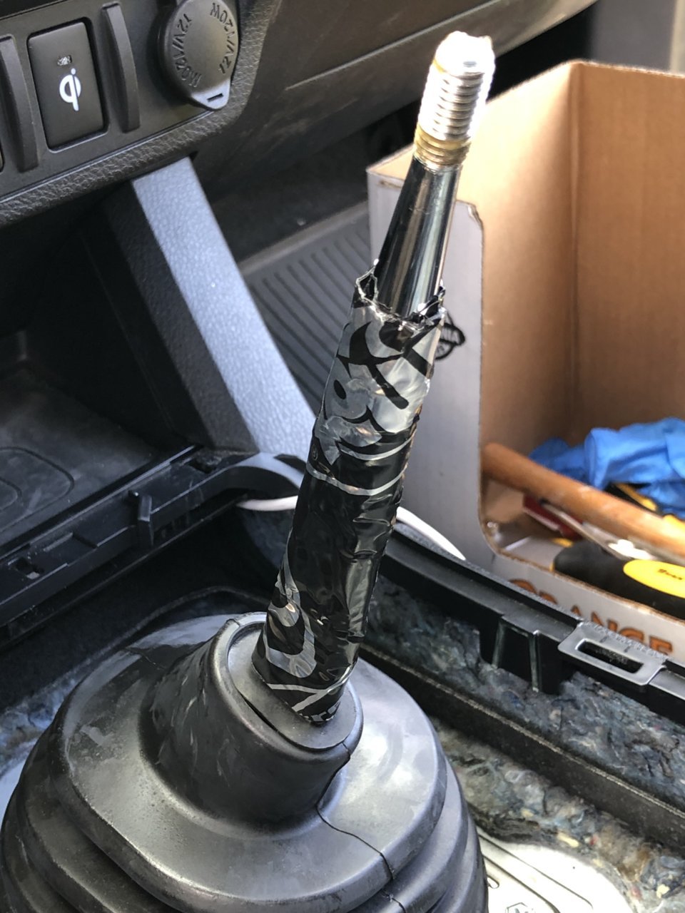

    Installed mine today. A few notes:
    1.) the updated design no longer comes with a rubber boot.
    2.) the stock inner boot can indeed be stretched around the core shifter however, I found it the easiest to remove the stock inner boot from the outer boot first.
    3.) This low profile all-in-one universal joint 12mm socket and a ratcheting box wrench (with swivel) REALLY made things much easier with the two back bolts. TEKTON 1/4 Inch Drive x 12 mm Universal Joint Socket | SHD08112 https://www.amazon.com/dp/B07R88T1NT?_encoding=UTF8
    4.) It’s near impossible to get a torque wrench hooked up to torque-to-spec those two back bolts so it was a “RFT” strategy there. Torquing to spec the front two bolts was easy. Regardless, that shift tower isn’t going to move.
    5.) I must have gotten lucky as the factory rubber gasket and dowel pins all stayed put and no prying of the stock shift tower was required. I was super happy about this as it made removal much easier.
    4.) Use a little oil on the breather fitting to make re-installing of the breather hose a breeze.
    5.) Make sure to mount the stick to the shift tower smooth side-to-smooth side before torquing to Core’s recommended spec. Use blue loctite on both bolts.
    6.) The install took me 2 hours total. After reading through the instructions and browsing through installation tips both on URD’s instructions and Core’s instructions, I felt fully prepared. The installation was very straight forward but doing things right and taking your time are important. I think 2 hours is a good estimate for how long this installation takes.
    7.) Noise/sound/vibration: This seems to be the million dollar question. Here’s my experience. First off, owning an SS stainless steel weighted knob with a delrin core (trailbreaker) I fully intended on reusing it especially with there being a cheap adapter to be able to install it on the Hurst stick. With that said, I proactively decided to cover the stick in Dynamat sound deadening material (pic below). I’m not sure if the Dynamat combined with the ss/delrin knob helped but the extra sound in the cab is negligible. I was actually surprised it wasn’t louder. The sound can best be described as some very quiet static. Vibration can be felt much more with the Core version while holding the knob. This doesn’t bother me. For someone who has two very picky young passengers, the extra sound can barely be heard from the front seat and I don’t think my kids will even notice the extra sound. I do think there’s something to be said with a weighted knob that uses a few different materials to quiet down the shifter. Again, this the only setup I have used and I’m completely fine with the extra sound volume this thing puts out.
    Here’s a pic for attention. This was with the stock shifter but as I want to keep the factory shifter boot look where it attaches to the knob, the picture here pretty much looks the same after the Core installer.
    At the end of the day, the shorter throws and the extra effort required to move into reverse are all great! It will take a few drives to re-program my brain but shifting just got a lot more fun!
