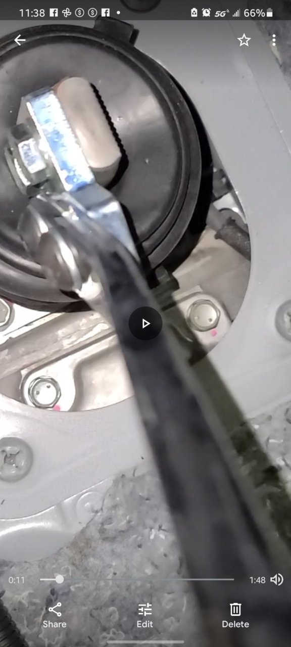

    So, I think I just realized I mounted my stick "wrong". Is the stick supposed to connect to the sub lever on the shifter on the smooth side or the tooth/ridges side? Because I definitely mounted it up against the "tooth" side. What are the ridges on the right side for? I thought they were intended to help keep the stick in place. Honestly, I like the position of the way the stick is a little more to the right... any issues keeping it mounted this way?

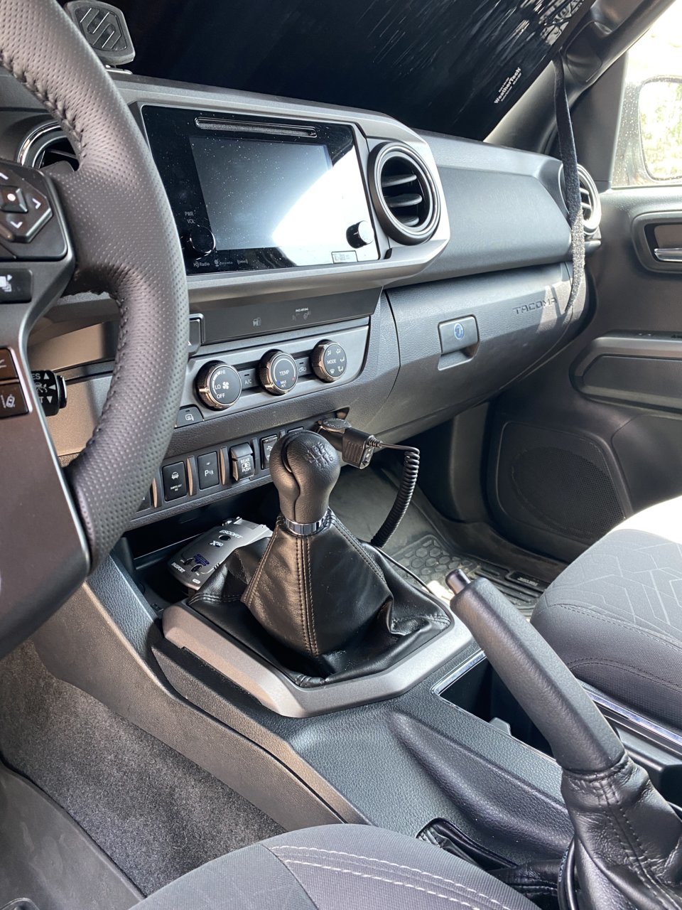

    I think it's supposed to be tooth to tooth or ridge to ridge. I don't think it'd be a problem.
    I added a picture of mine to this post

    I had my stick mounted on the serrated side, the right side (opposite of yours). I contacted Chris at Core and he said this...
    Whether or not that would actually happen, I didn't want to chance it so I re-mounted it on the smooth, left side (like your picture). Didn't take long to do an allowed me to add a little more sound dampening to the stick (not sure it did much).
    Thanks for the pic! This helps ease my mind that I did indeed have it mounted on the wrong side for this stick.

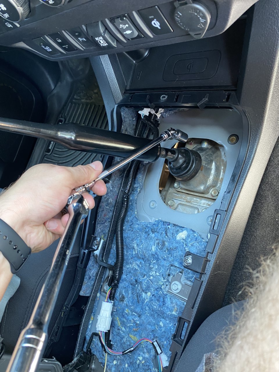

    Thanks again to everyone on here that helped me decide to pull the trigger! Just installed it yesterday, super straightforward besides those two front bolts. I bought a crows foot set, but instead used a 12mm on 1/4” drive with a Kobalt u-jointed wobbly to get the front two bolts broken loose and torqued back in. Worked like a charm!
    Little noisy but it really doesn’t bother me. It’s loudest to me in the city, and generally my truck is loud in the city so no harm there. I may try and add some sound deadening and add a gasket between the shifter base and the hurst stick. Love the short throws, the feedback that the stock one deadens so much, the slightly more driver-centric position, and how much easier the shifts feel! Also the reduced wobbliness will be a huge huge help off the pavement - hated the amount the stock one would move on bumps. Here’s my install - stock shifter with the Scott Drake adapter from Holly:

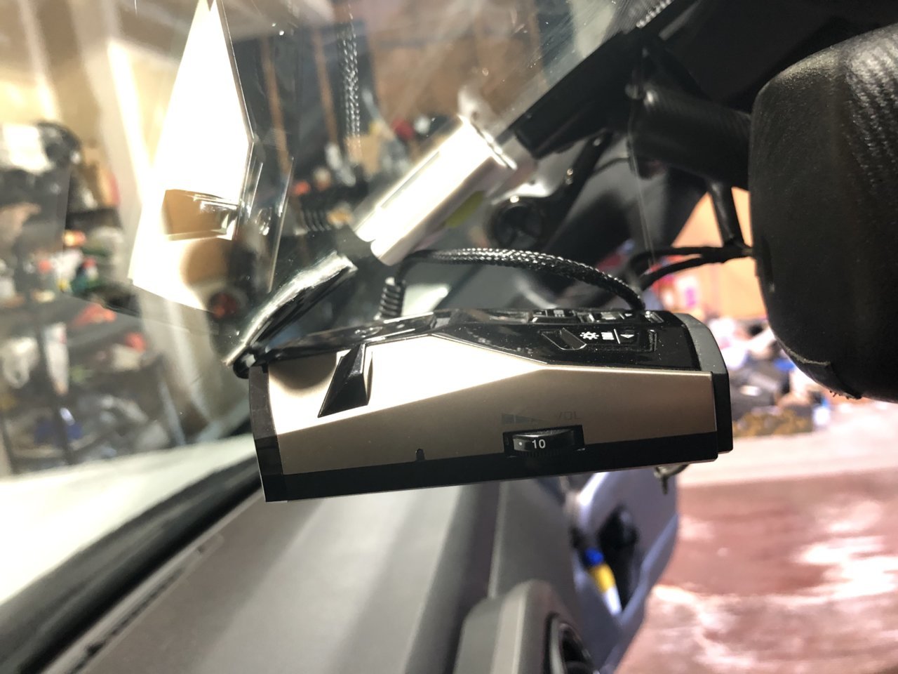

    Nice work man! Total side subject... I assume you have a powered rear-view mirror (has a compass and auto dims?)... they sell some wire taps to tap into the power of your rear view to power your radar detector. They work quite well and really clean up the placement and install of radar detectors.
    Anyways, glad this thread has been helping people getting the right equipment for the installation. I can't stress enough that having the right tools (especially for those two bolts at the back) makes this installation so much easier than it can be.

    Yes, auto-dims and has the dash compass (2019 TRDOR). I’ll look into that, would definitely be nice to have the cigarette outlet for other things. Sad it doesn’t have two outlets like my 2nd Gen did...
    Is it this thread? Seems stupid simple!
    https://www.tacomaworld.com/threads...-my-radar-and-tapped-the-mirror-power.427388/

    Yup! That's the one. They sell those cables with the pins for pretty much every radar detector. They even sell some mounts too. I have a dash cam mounted up there as well and had to get creative with tapping into power. I have my radar detector using those pins and then actually tapped into the same power wire under the upper console to get some more power out of there. Everything is super clean. You will lose the mute button on your cig-lighter adapter but I'm not sure that's super important to you. Here's a couple pics and then let's get this thread back on track....
