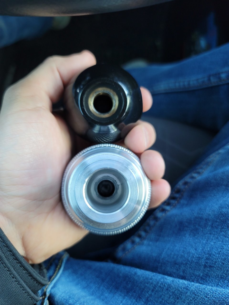

    I may potentially install it tonight to compare for everyone

    Bad news everybody, the B&M has larger threads than stock. I didn't measure them but they are larger

    That isn't horrible news as we could re-thread the knobs.
    Can you tell if it is Science or Freedom Units?

    What's the thread size on the B&M shifter? Is it the same as the Core shifter? 3/8"-16

    No it is larger than stock. I did not have any tools to measure the threads, I am sorry about that

    For reference the B&M threads for the shift knob is 9/16-18
