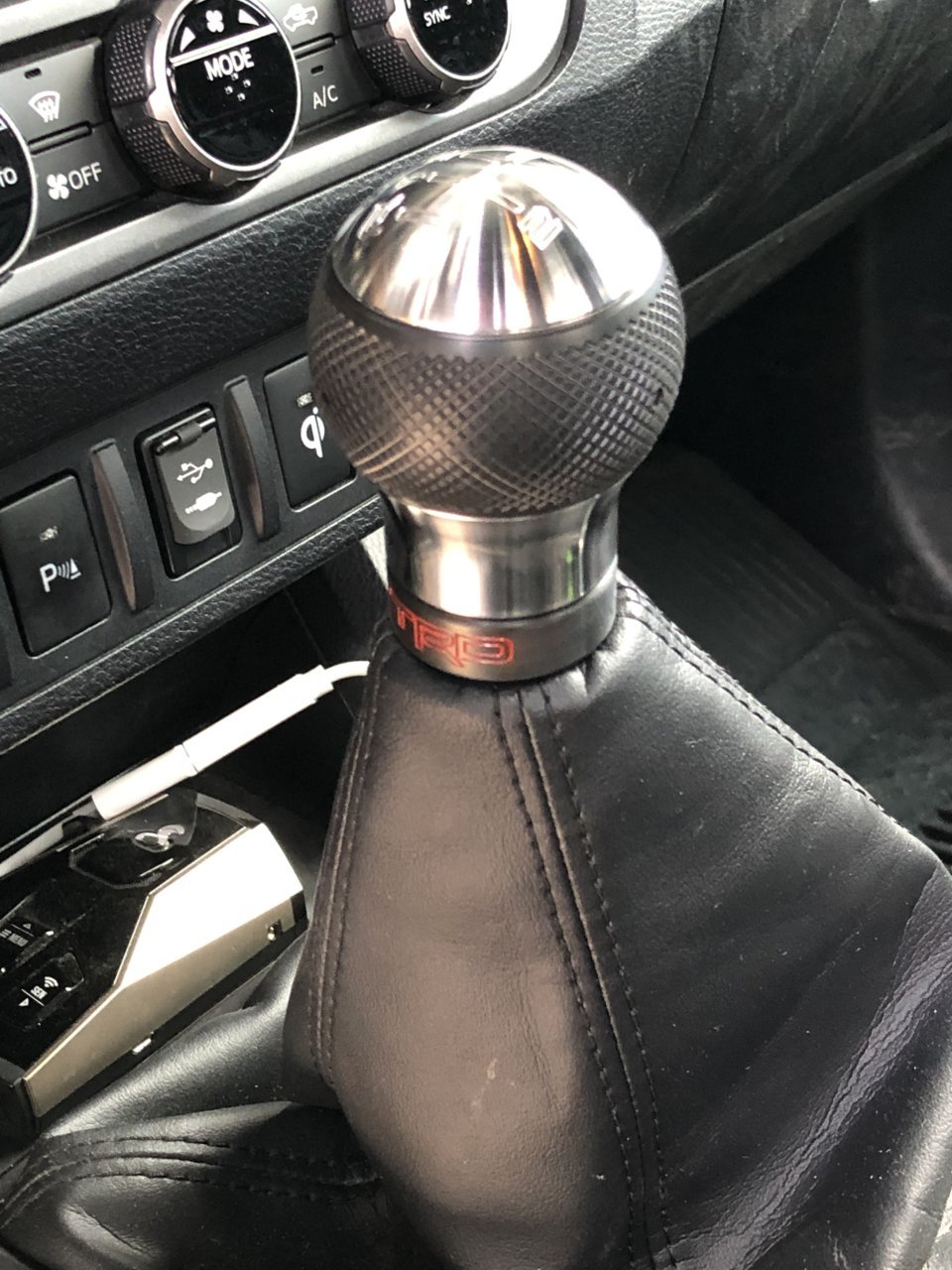

    I have probably 30k miles on mine with a Ti shift knob and an adapter with zero issues. Just don't go 300lb gorilla on it and you will be fine.

    Chris is cool and all but he definitely has a “my way or the highway” stance. How in the world would the threads snap using one of the brass reducers that convert the threads to Toyota threads??? It’s metal on metal. Anyways, I have a weighted stainless steel/delrin hybrid knob and have never had any issues with the knob or shaft cracking. I’ve even shift pretty hard at times. Use the adapter and enjoy whatever Toyota threaded knob you like.

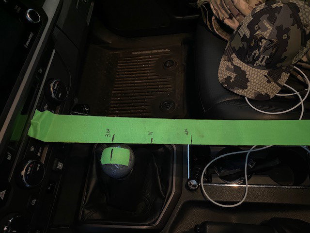

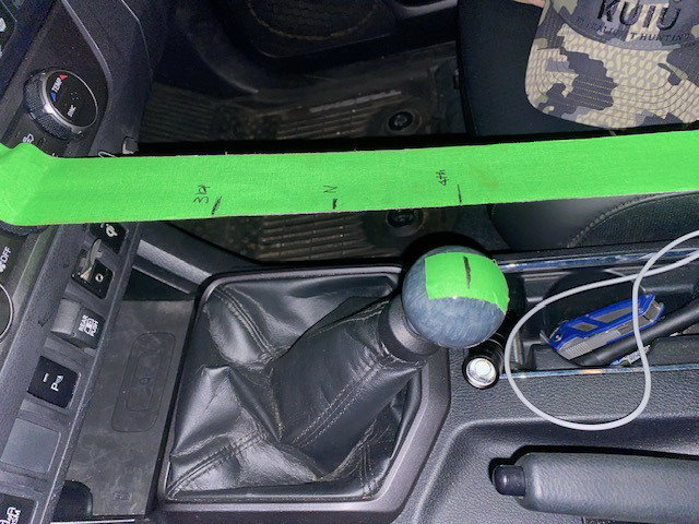

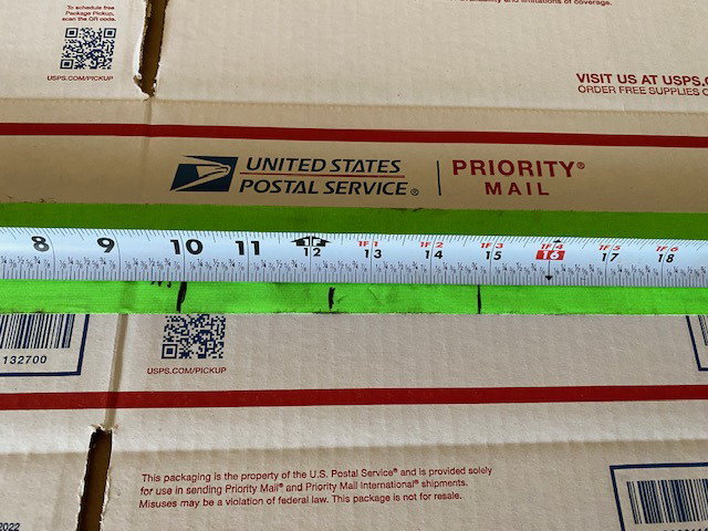

    There aren't exact measurements. The throw reduction is nice, but the real advantage is that it seriously tightens everything up.

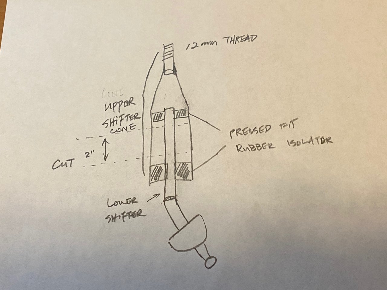

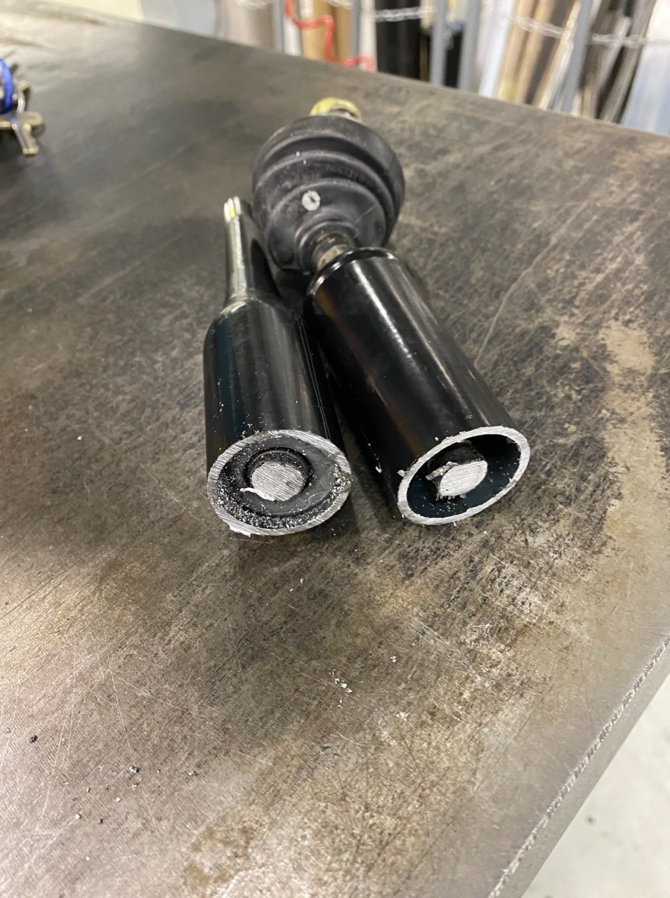

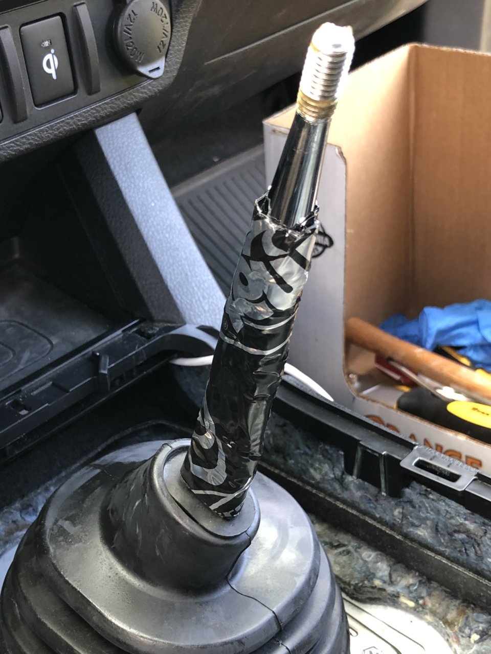

    Toyota actually built 2 rubber isolation rings in the shifter to reduce the noise. I found that out when I cut mine.
    Shortened the OEM shifter by 2" and welded it back, any muffler shop guy would do 60 seconds of welding for 20 bucks, it doesn't need to be pretty.
    I don't have a measurement for the "before", less than 5" after the chop.

    Lastly, I kinda agree with previous comments by @su.b.rat that a lighter, smaller knob feels better. I didnt have an adapter to transplant my TrailBreaker knob so I just used the provided Hurst knob and it feels really nice. I'm thinking I may try to get one of the white TRD pro knobs which have more size/weight than the Hurst and that would be a really good spot for it. Plus my TrailBreaker knob I have serious regrets with (my own fault 100%--not knocking the product), so I may try to offload it anyways.
