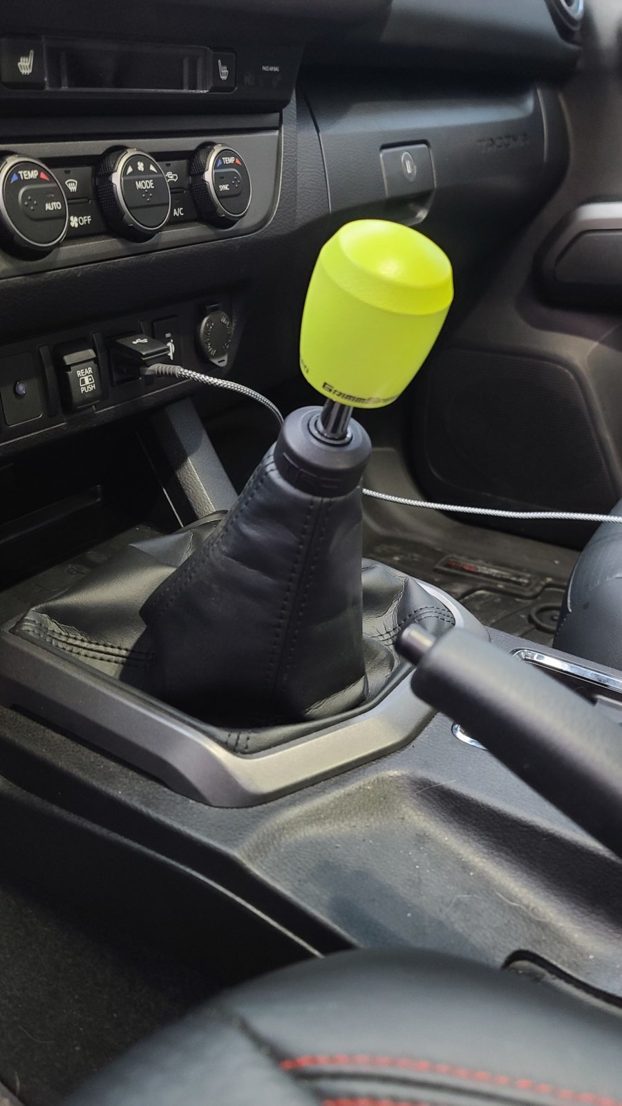

    My shifter showed up and I got it installed today. I'm very very impressed, install wasn't hard at all. Honestly I don't know what all the noise complaints are about, I can barely hear mine. I love it.20231212_155940.jpg

    Just installed mine too. That TEKTON 12mm 1/4" drive universal joint socket was the key for me, ha. That and reading and rereading this thread. Took about me about an hour to get it done. I do have a question for @7r41lbr34k3r how does one get a replacement collar? It cracked when I was finishing up.

    Just got back from a test drive, ha, its a completely different experience now. I do understand the comments about mechanical noise when shifting now but I don't hear anything else. I also did the sound deadening wrap just as a precaution though.
