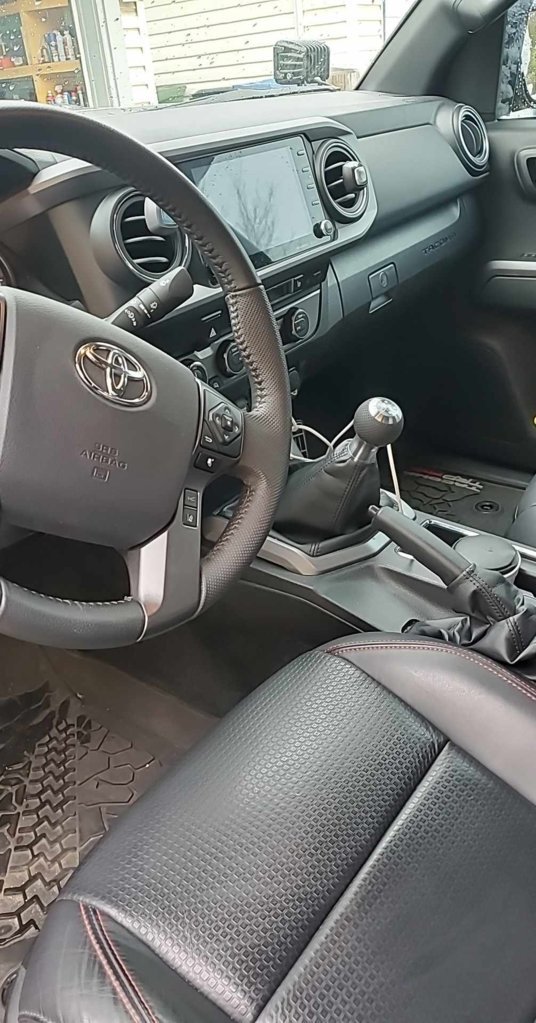

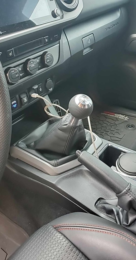

    Thanks to your post, installation went well, well, other than spending 90 minutes trying to break the 2 bolts lose, but I got her done without any cutting.
    Not sure how other vehicles are but, on my 2023 Tacoma, the OEM Shifter had a metallic gasket, which I assume it's reusable as it wasn't at all pressed or deformed.
    The Shifter is stiff, at first I was worried tgat 5th gear would be hard(er) to get into, however while driving, it goes easily into the groove, without any extra effort to push the Shifter to the right.

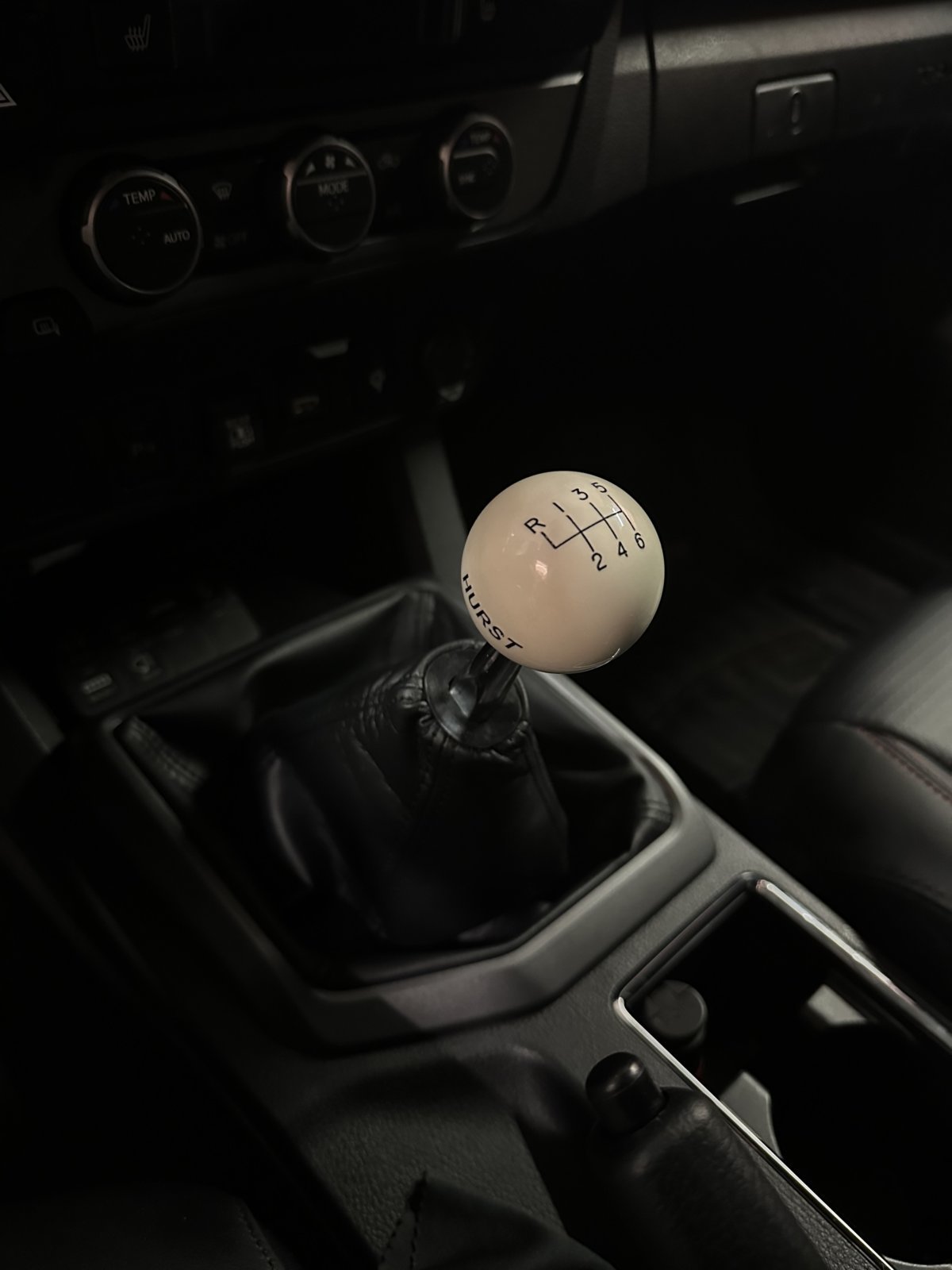

    I ordered the GT6 Custom shift knob from www.sportshifters.com , and Roy, the guy I've chatted at length has been very accommodating on making a few small changes for me.
    It's now in production, and, after driving with the TRD knob, I decided to ask for the weight to be at around 325 grams instead of 400 as I initially asked.
    He also changed the thread pitch fir me to accommodate the Hurst 3/8×16 thread.
    In all honesty, I actually enjoy the CORE/TRD knob combo, but I was a little w9rried that I might need more weight and ordered the new knob before installing the CORE so that's that
    To recap.
    Love the mod, the shifts are crisp, Reverse is a tad harder to get into but also hard to go into unintentionally, transmission is louder but is a nice sound, I now drive with my radio off just so I can hear it.
    If you're on the fence about it, go for it it's money well wasted, as I'm sure many of us spent a lot more on less useful mods.
