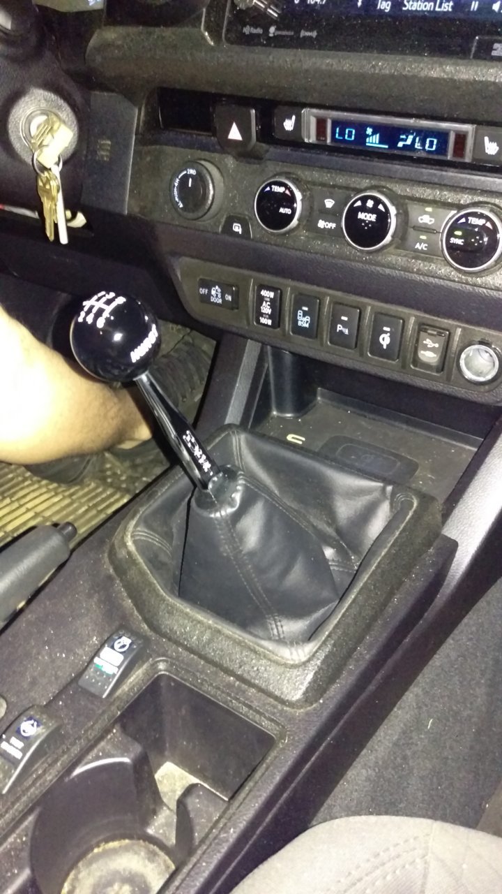

    It's pretty hard to say, but I think you have the old style bracket. Did you request the new one? Here is the only picture of the brackets that I took and its not a very good one at that...
    Old on the left and new on the right:
    I finally installed the new bracket on mine. It lowers the shifter and makes things feel a little more natural for me. The shifter sits where my arm naturally rests when I put it down. I don't feel like I'm reaching like I did before.

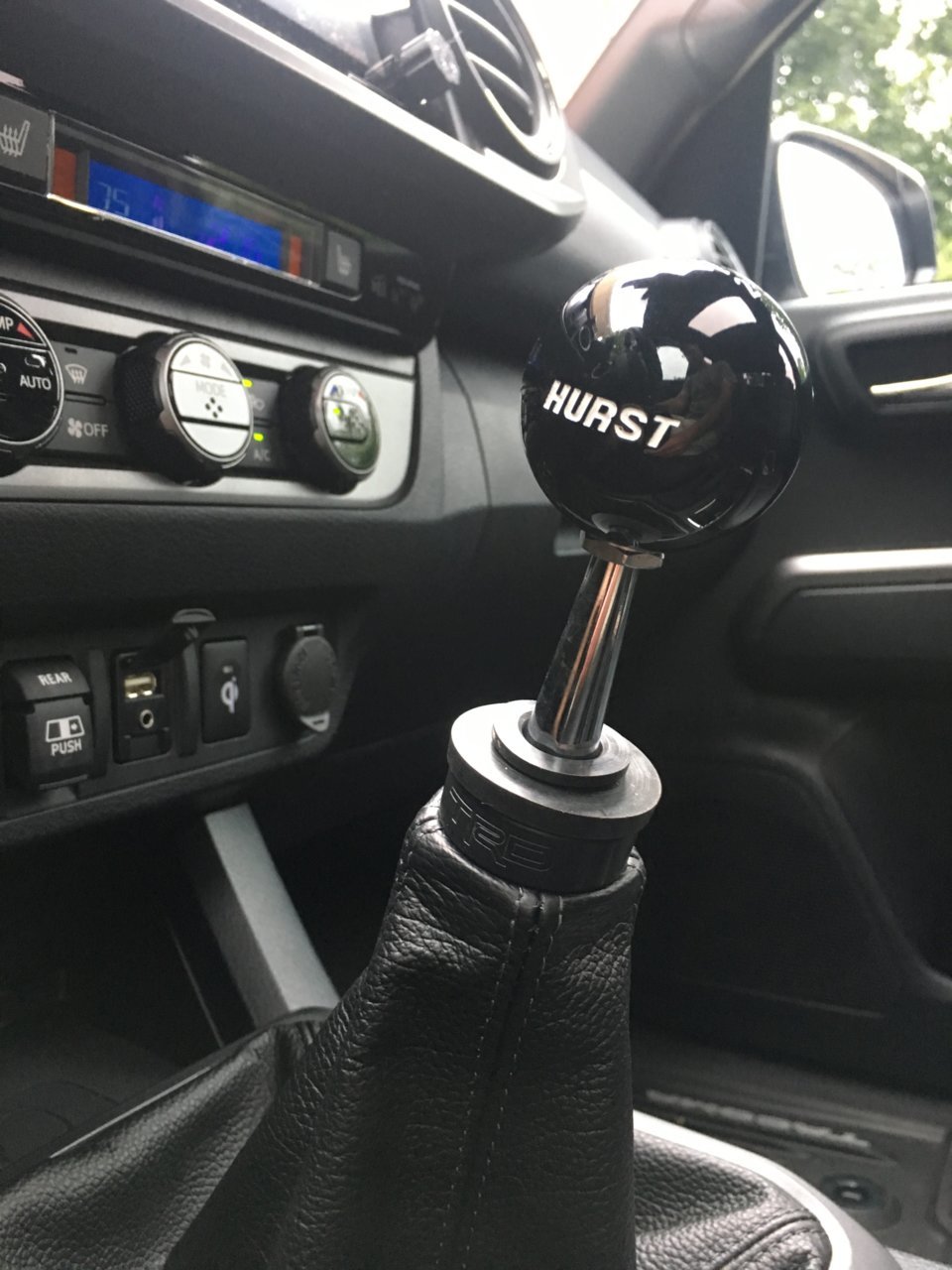

    Well I finally got my Core Shifter short throw in and installed a couple days ago and holy s#$%!!! I love this shifter now, absolutely 100% better then stock in every way possible. I would recommend this to any manual owner. IMAG1373.jpg

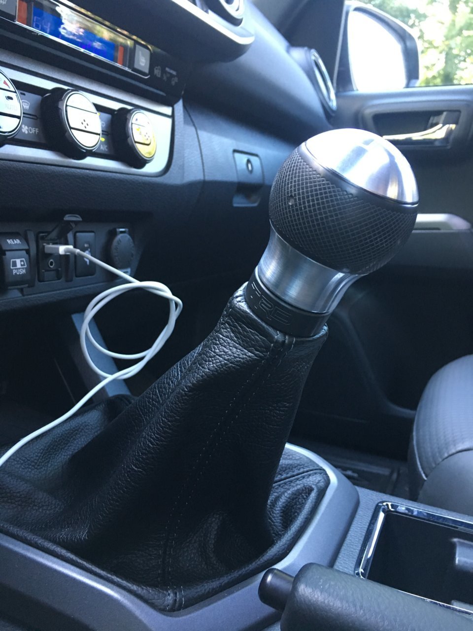

    I feel like the arm needs a slight curve to it. It looks kinda goofy being straight. I loved mine in an old ranger I had but the look of this one just seems so out of place

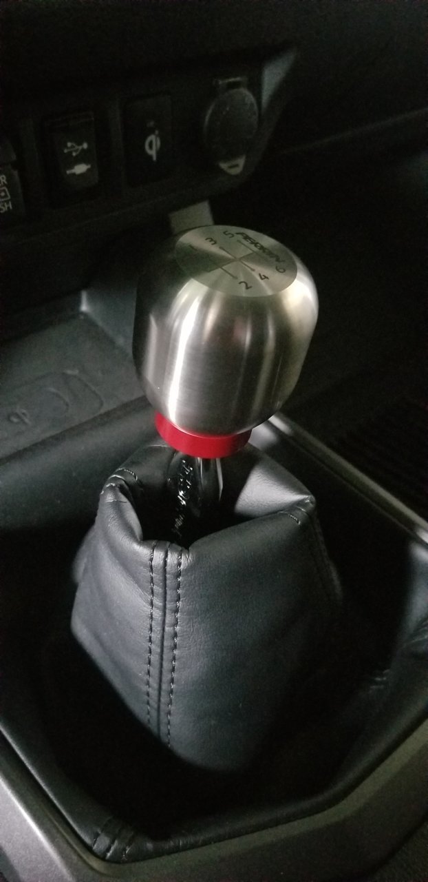

    Scored a new Core short shifter from a member. Installed today, this is a seriously sweet setup. Front to back and side to side movement is the perfect distance IMO. The first to second shift was a slight annoyance to me with the stock setup. Especially in traffic with the short first gear/wonky factory tune. No more, 1/2 is quick without abusing the transmission.
    More noise is transmitted through the solid mounted stick, You can hear the syncros working and some gear whine :burnrubber:
    Some may consider this a drawback, if you’ve driven older manuals your used to it. Doesn’t bother me one bit.
    Now I need to figure out how to mount my @7r41lbr34k3r shift knob.
    Still using his Delrin boot ring and a couple of rubber grommets.

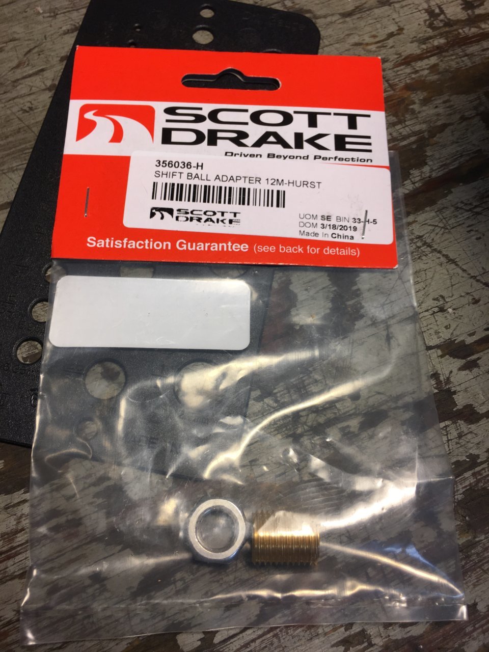

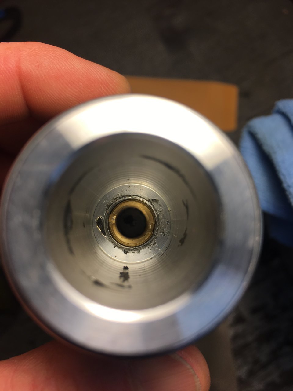

    Alright folks found a easy solution for the @7r41lbr34k3r shift knob on the Core/Hurst shifter.
    Looked around for a few days for a 3/8 16 to 12 x 1.25 adapter, nothing.
    So I planned on machining out the knob rethreading and installing a time sert, really didn’t want to go this route.
    In searching for the Hurst thread size to double check before ordering the time sert this popped up.
    Wait...what... all the searching why didn’t this come up before? Whatever who cares. Ordered from Summit. Turns out 2004 and up Mustangs have the 12 x 1.25 thread and have the same issue when using a Hurst shifter.
    Oh yeah, back in action!
    Even better than before
