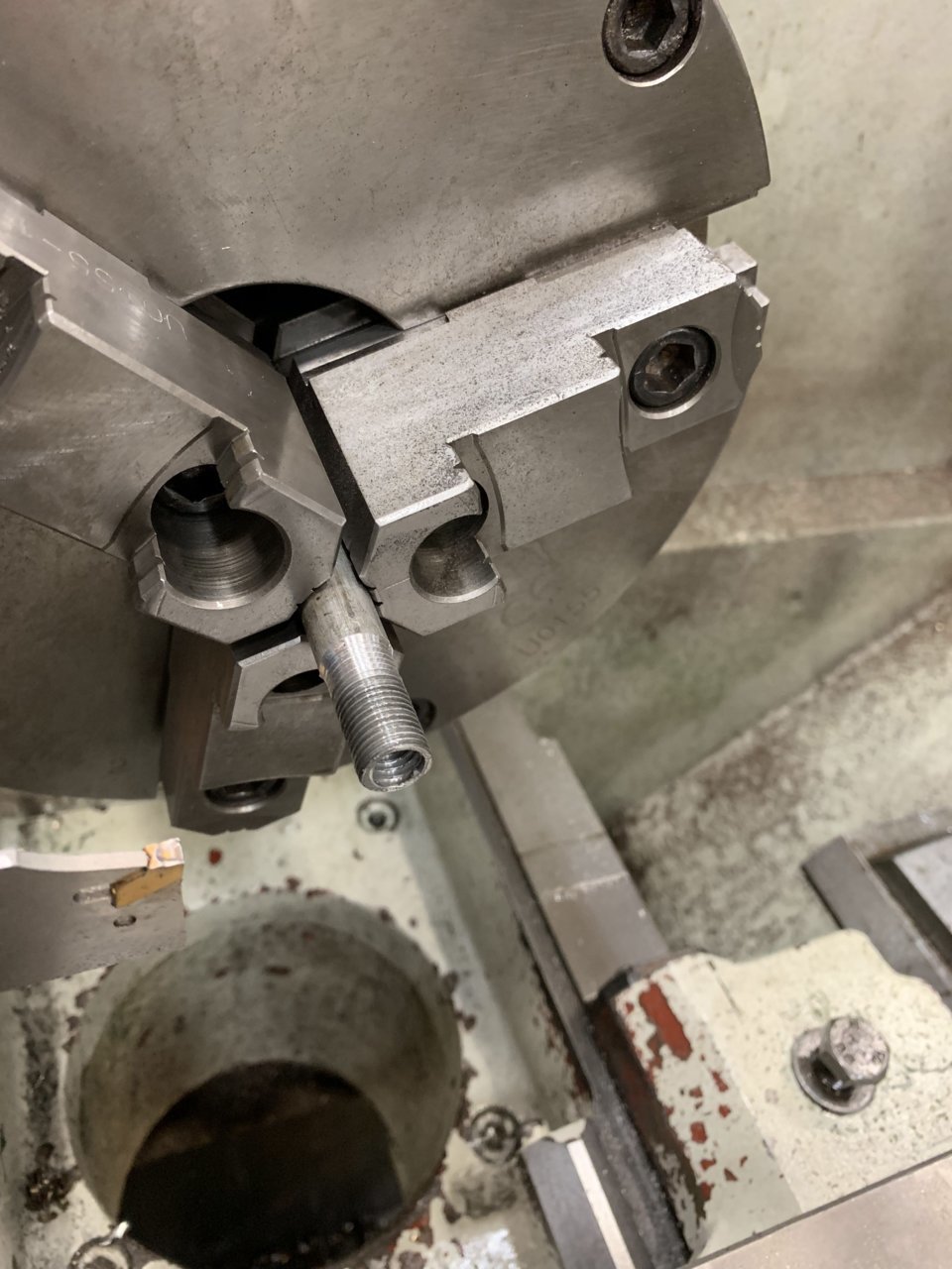

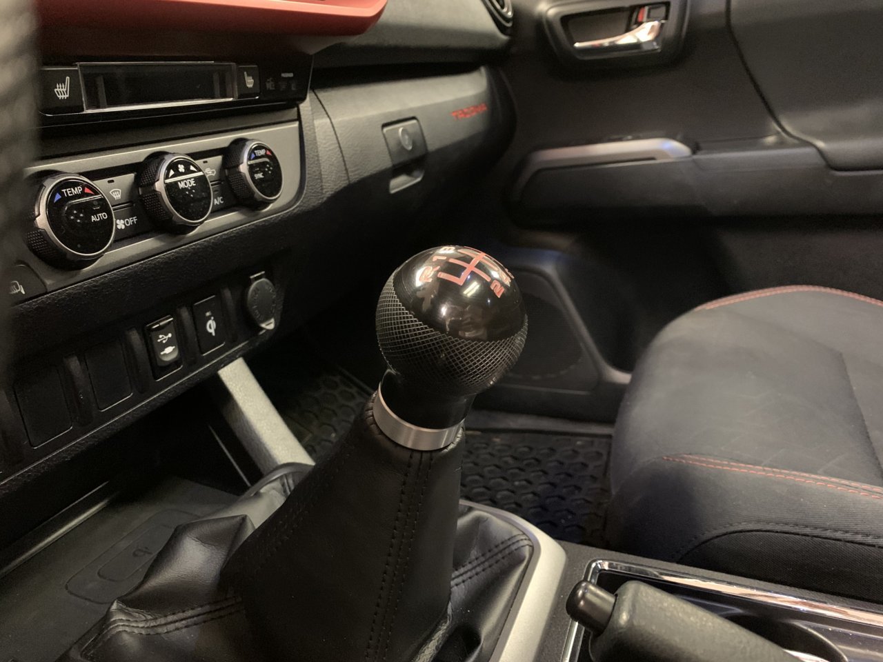

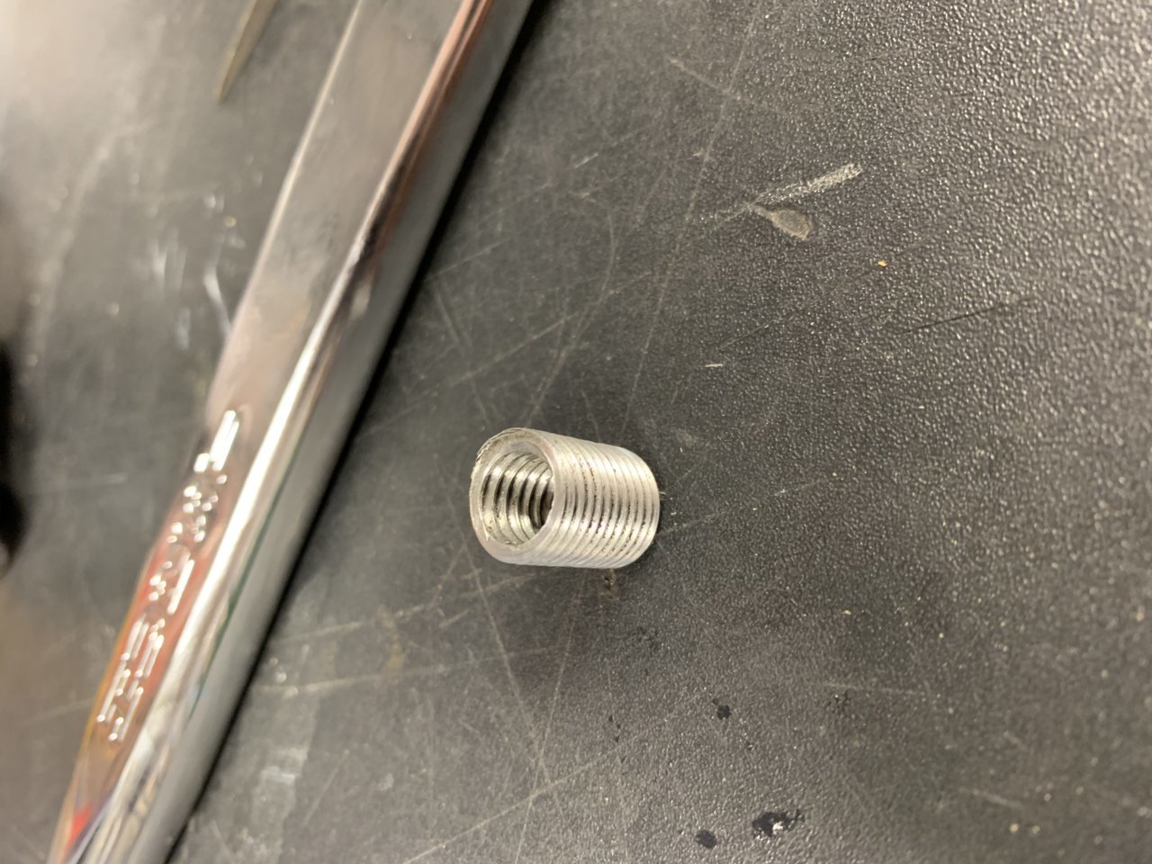

    I got my Core shifter Installed a couple of weeks ago. Amazing difference! Much more fun to drive. Shift throws are greatly reduced, much less play when in gear, more positive engagement into each gear. Definitely a worth while upgrade.
    NVH is increased, without a doubt. You can always hear a hum coming from the shifter area. And the shift knob has more vibration when holding on to it. The noise can be drowned out with music though, so it doesn’t bother me too much. Just something to note.
    Also, Shift know is moved closer to the drivers side of the vehicle. I like this, as there is less reach for every gear. But some may not like the lack of symmetry.
    I had a guy at work help me build a bushing for my @7r41lbr34k3r shift knob. Took him like 20 mins using some aluminum bar we had laying around. Worked perfectly. Note from the photos, i did not end up using the nut below the bushing to lock to bushing on, it was bottoming out on the nut before the stick was bottoming out inside the knob, not allowing me to use shims to straighten the shift pattern.

    I'm liking that Delrin and that the chrome shaft is hidden. Assymetry is cool in my book.
    :cheers:
    I still wish we could get this thing with just the Core base and bracket. No shaft or knob. :pout:
