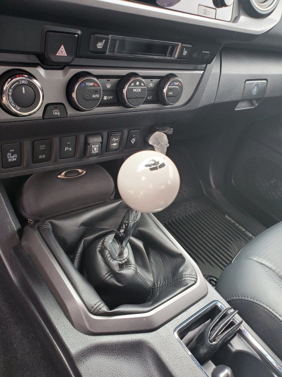

    So basically for the core shifter, you remove shifter knob, remove console trim, remove inner boot. Disconnect bent line, pull off old shifter base, put new shifter base on. Reconnect vent line, bolt down new shifter base reinstall boots and trim and you're done

    :thumbsup: Basically. There is some minor pre-assembly on the Core assembly, but you got 99% of it. Its an easy install if you take some time.

    So i had an interesting thought for shits and giggles. Im sure if i put the chrome piece back into the boot and had an adapter for the oem knob i could make it look oem and i bet it'd fool the dummies at the dealership lol
