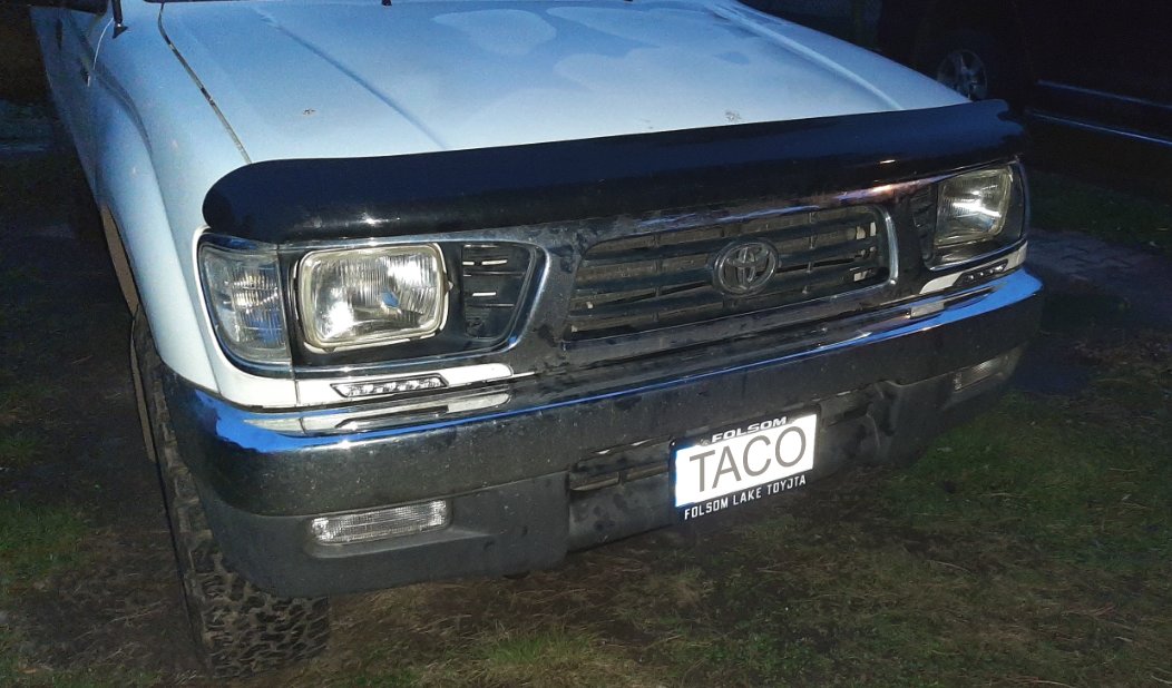

    And adding to that in that year Toyota did not invent Pr-runner yet, so definitely 2WD is always 5 lug and different suspension, body and such from 6-lug which was only 4x4. On the pictures in on-line stores it is hard to notice difference between 4x4 and 2WD corner lamps, but they are different shape, and 2WD lamp will not fit into 4x4 body.
    So you need to look for specific Tacoma (not "Pickup"), year 1995 or 1996 4x4 corner lamps. If seller does not specify all three parameters, it is a chance you will buy the wrong one. Luckily e-bay is full of them quite cheap, but quality is always unknown (unless pricey OEM) so some may not be fully sealed and can fog in the rain (In the set I bought some time ago, one lamp had to be treated with silicone around the edges because it was leaking. Basically it is hit or miss (like with most cheap stuff). In my case I had to replace my "perfect OEM" corner lamps because in Poland orange corner is not allowed and I had to have clear lamps with white bulbs.
