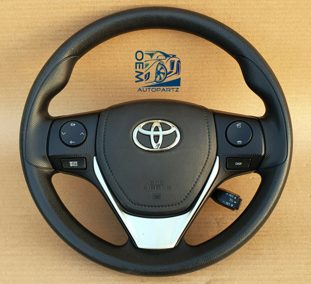

    Do you have a picture of your wheel, I know different models have different button layouts/amounts.
  4. Nov 19, 2021 at 9:22 PM
    #24
    Pearson
    Pearson [OP] Well-Known Member
    Aug 21, 2021
    #374865
    736
    Elliott
    Lexington Texas
    Black 2012 2.7L Prerunner
    [​IMG] This is what it looks like but the pic is from Amazon, sorry about the size.

    Is that the same button layout? that's what really matters.

    He will need to do a repin/ swap ground/ add wiring from connector at the steering column to his stereo in order to get full 100% functionality from his steering wheel. That layout was how mine was. AU3 circuit is not present in the 2012's so it needs to be added in. Not that it matters if using an aftermarket steering wheel control module/ stereo because the modules do not support AU3 circuit (Back, left, and right buttons).

    I agree, but if you get a steering wheel with less buttons you may not need the SW3 wire. This would only require repinning to get it to work.
    OP, are you using the stock radio?

    I am running the stock radio, and I would like to keep full-wheel control button use.

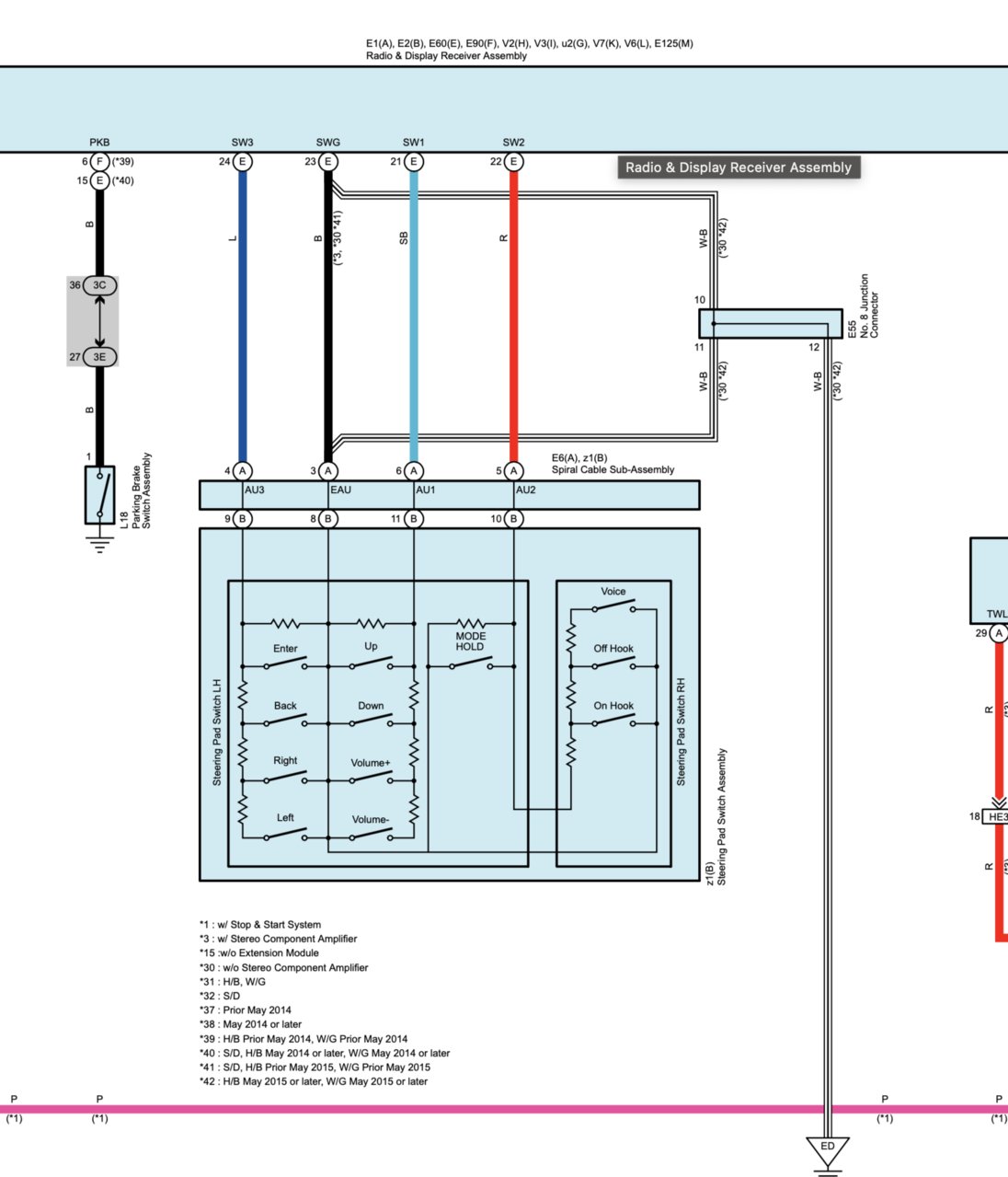

    Do you still have the 2014 corolla wiring diagram? I can't seem to find the one I used when I originally figured everything out.
  13. Nov 20, 2021 at 9:07 PM
    #33
    arcenik
    arcenik TRD
    Aug 12, 2017
    #226644

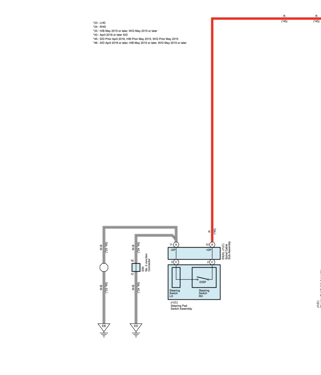

    I would like to see if I can do something with the DISP button.
  14. Nov 20, 2021 at 9:27 PM
    #34
    12TRDTacoma
    12TRDTacoma Powered by Ford, GM, VW, and Mercedes
    Aug 20, 2012
    #85133
    16,671
    Rob
    Concordia
    12 TRD Sport DCLB 4x4 Supercharged
    Boosted
    I checked the night of my initial post and I still kept the 15+ pages I highlighted and worked to make more convenient to read and to answer your question, if you have an aftermarket display (which I know you do) you cannot do anything with the display button, as it is a limitation integrated into the steering wheel control module itself. Now I understand your unit is mostly plug and play, which MAY expand your possibilities for utilizing the display button, but for others using an aftermarket stereo and steering wheel control module, to my current knowledge, there is no capability to utilize the DISP button. Matter of fact even the Corollas and Camrys of those years which use them lose that functionality as well to my knowledge.
  15. Nov 20, 2021 at 9:30 PM
    #35
    arcenik
    arcenik TRD
    Aug 12, 2017
    #226644
    853
    Jon
    2015 X-Runner
    My android radio has 2 extra key inputs for steering wheel controls. I was thinking I could run a wire from the DISP wiring to one of the extra Key inputs. I just don't know what kind of signal it sends (resistive, gound) Im sure I can do something with it, I just need to track down the wiring for it.

    Do you want the photo of the diagram for the 2014 Corolla or the 2015 Tacoma?
    arcenik likes this.
  17. Nov 20, 2021 at 9:40 PM
    #37
    arcenik
    arcenik TRD
    Aug 12, 2017
    #226644
    853
    Jon
    2015 X-Runner
    The corolla, I have the 2015 tacoma.
  18. Nov 20, 2021 at 9:43 PM
    #38
    12TRDTacoma
    Aug 20, 2012
    #85133
    16,671
    Rob
    Concordia
    Boosted
    I'll get back to you on those. I have them in the garage and that would require I dig them out. I should have them to you by tomorrow.
    arcenik[QUOTED] likes this.
  19. Nov 20, 2021 at 9:49 PM
    #39
    arcenik
    arcenik TRD
    Aug 12, 2017
    #226644
    853
    Jon
    2015 X-Runner
    Just found the corolla wiring.

  20. Nov 20, 2021 at 9:56 PM
    #40
    arcenik
    arcenik TRD
    Aug 12, 2017
    #226644
    853
    Jon
    2015 X-Runner
    Disp button wiring. Looks like it's just a gound signal.
