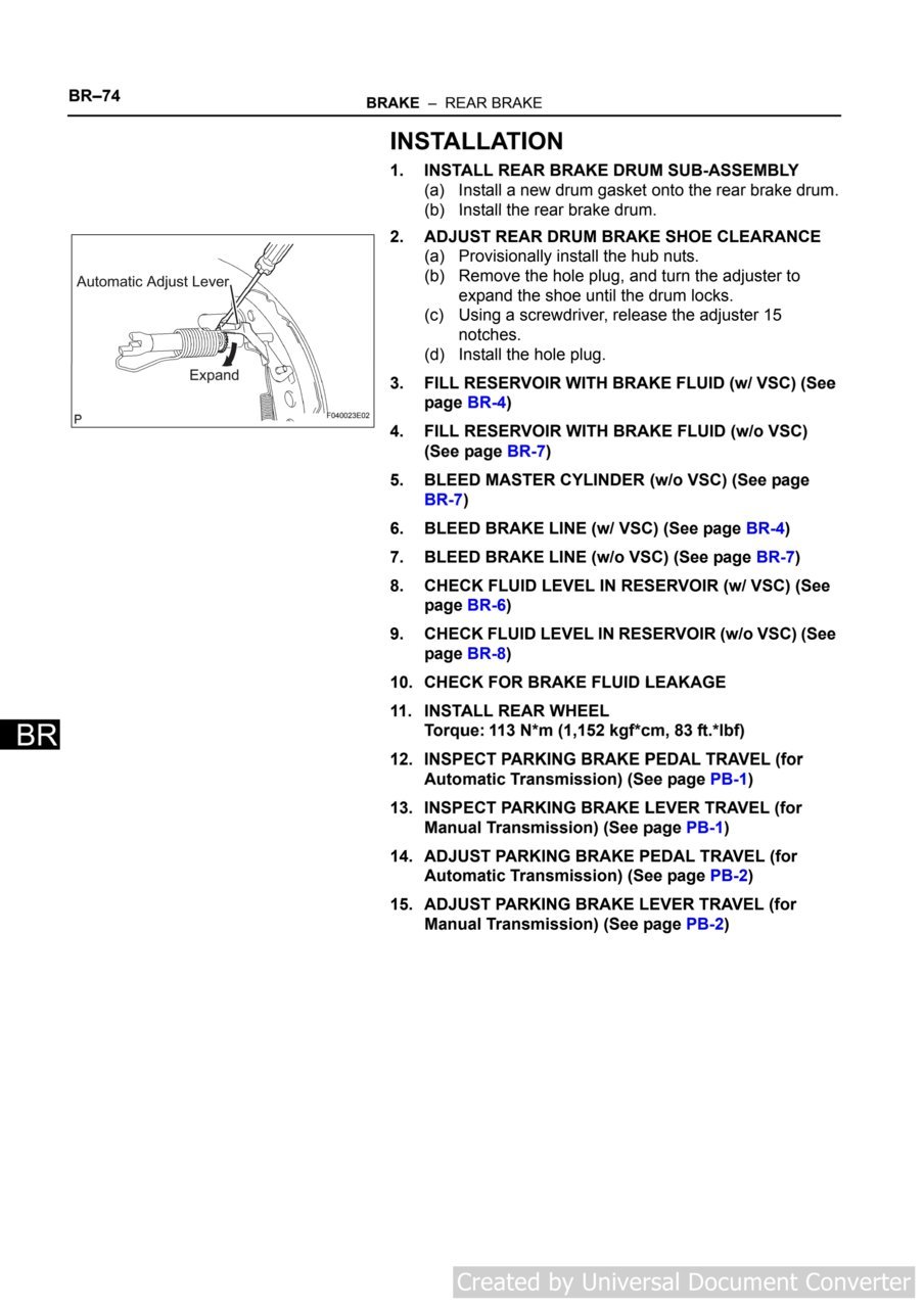

    I just replaced the rear pads and drums today. I had adjusted the pads out until they started scraping slightly. I noticed my brake pedal does not feel as solid as it used to. What is the correct amount to tighten the adjuster for the rear pads?

    Per the FSM:

    Usually with new shoes/drums they need to be re-adjusted after break in. This is due to the ever-so-slight out of round nature of shoes.
    When I install new shoes I set them super aggressive, barely turn by hand.
    Just re-adjust to slight drag, it will feel better.
