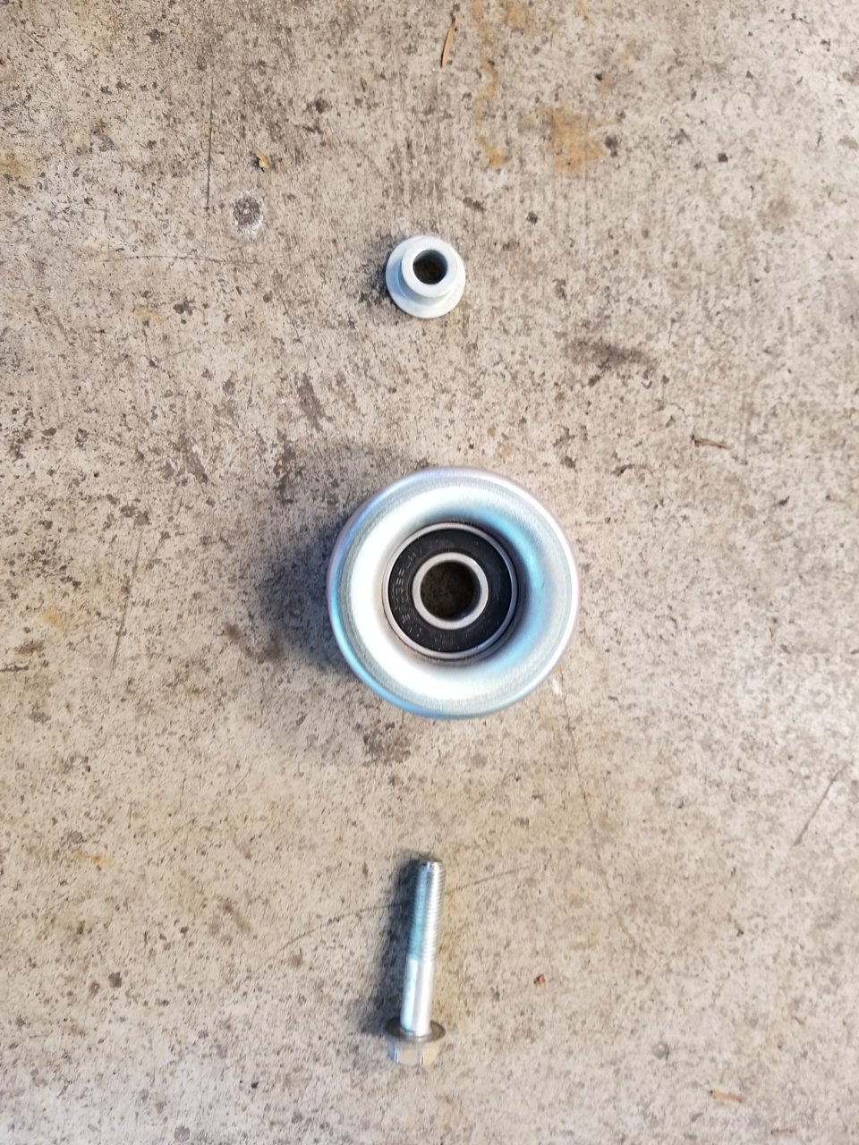

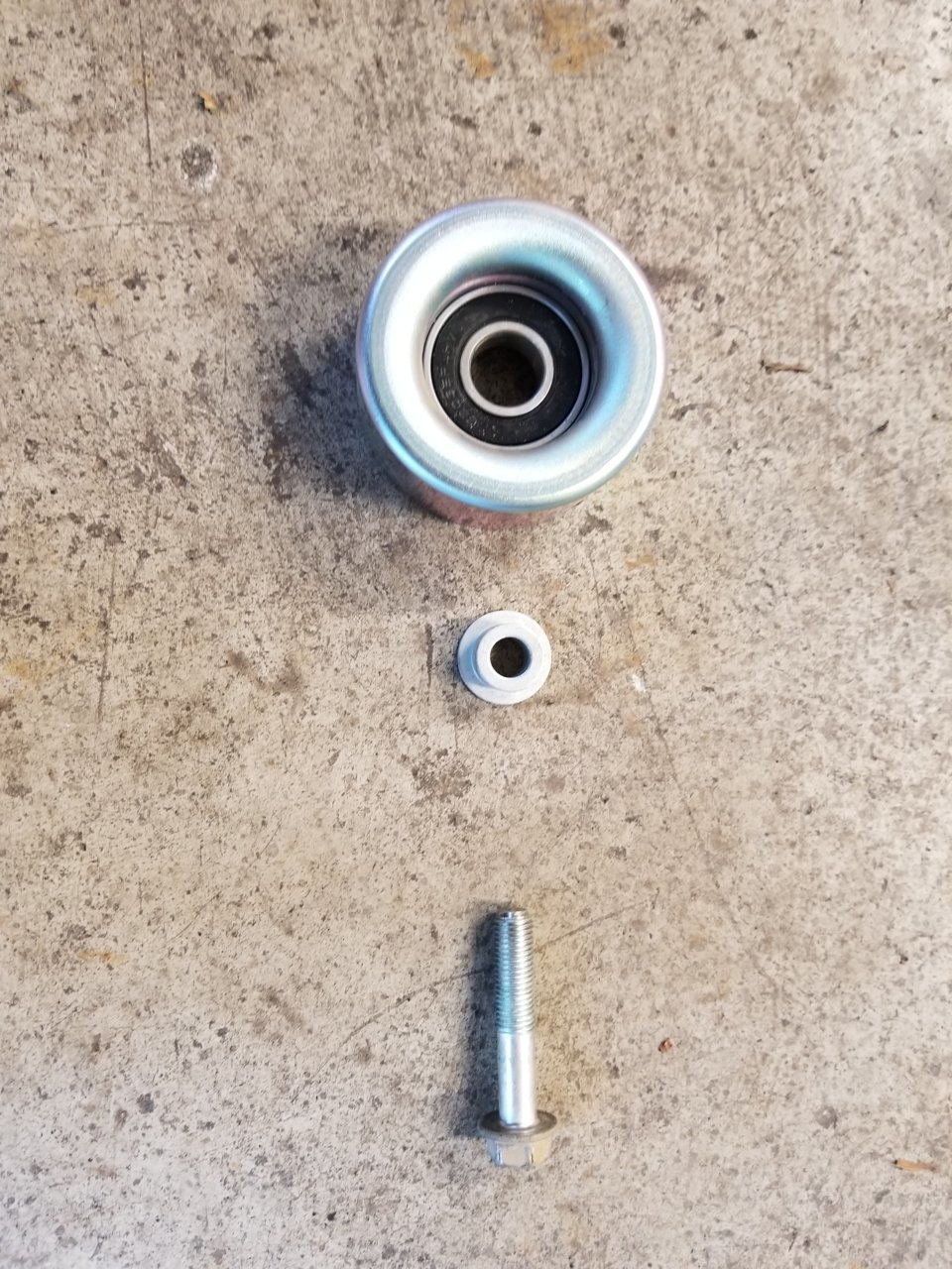

    When assembling the Gates idler pulleys (part 36173), I couldn't find where the shim is supposed to go.
    Do they go together in this order, with sleeve on outside (EDIT: From responses below, THIS IS CORRECT)
    Or this order, with sleeve on inside?

    I put it in the first way.

    Bushing should be on the outside, I do believe.

    Absolutely the first picture.

    Thanks all, and thanks for the quick response. I also verified with a FJC post where someone inspected both possibilities. If you put the sleeve on the inside, the belt doesn't visually ride as well on the pulley.
