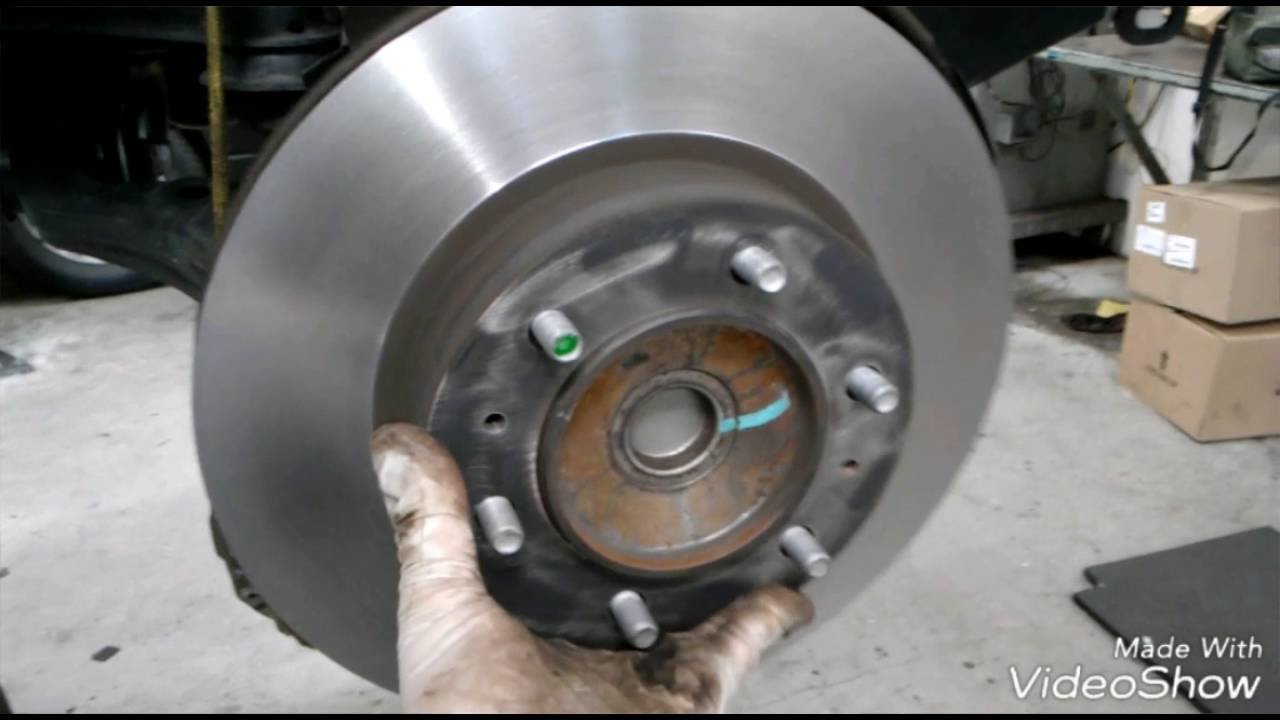

    What? Stock rotors are NOT vented, they are flat and smooth, nothing done to the surface of the rotor. I have a 2016 TRDOR
    Went from this:

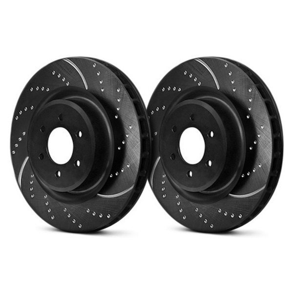

    To this:

    Yes stock are Vented but not slotted and cross drilled which is what yours are.

    :rolleyes: The aftermarket rotors you pictured are "drilled and slotted." Again, drilled and slotted rotors do nothing for cooling. The OE rotor is a blank rotor--the vents are around the outer perimeter of the rotor. All front rotors are vented. If we had a rear rotor, they'd most likely look like the first one in the picture below (non-vented, solid).
