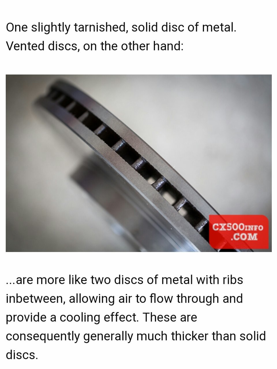

    Those are cooling vains, not vents. His are dimpled and slotted for brake gas escape.

    His are dimpled and slotted because people think it looks neat. It doesn't do anything besides degrade your braking performance.
    Dimpled is slightly preferable to drilled, though. All drilling does is make the rotors crack faster.

    The only way to make your rotors cool better is to duct air to them in some way. Sorry, but them's the facts. Bigger/heavier rotors give you a larger initial heat capacity, though.

    Why would engineers design/make they make them if they didn't cool better, why have them at all? Isn't that why the grooves are called "cooling veins"
    To answer your question, I don't think I glazed them. I just couldn't stop going downhill with the pedal all the way down, I was creeping and I could light a match off my rotors. They stop fine now, I am just looking for a little more without spending big buck$

    Because engineers like to make money like everyone else? It's like you're asking about the entire history of marketing, all in one go. I hate to break it to you, but there's a lot of products in the world that do not do what they claim to do.
    Spongy pedal to the floor means you boiled your brake fluid, by the way. Buy better brake fluid and/or actually change it every six months/year like we all should.
    Brake "outgassing" is also not a thing on brakes. People thought it was what was screwing up drum brakes, so they drilled the brake shoes to let them "outgas." That didn't do anything about the fictional outgas, but it did frequently help because it let air flow through the drum better, letting them cool.
