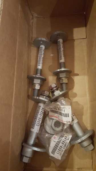

    120.00 shipped for my box of goodies. Has all the stuff you need to put in a new Cam System

    Very nice Rick. I'm going to try sanding mine down a bit. I'm certain I can get mine out but I believe they are a bit seized and pop/break loose when the truck is being turned into a parking spot or such. I'd imagine it's similar to what 58 Siesta was saying above. I suspect it's time for bushings too though. What I'm trying to figure out is if I get these bushings pushed out, do I need new metal sleeves or do the new ones just pop right in and I'm done?
    Edit: Just saw the video on the energy suspension website. He says make sure NOT to remove the metal sleeves in the OEM control arms. If I get them pressed out, will the sleeve stay in there and only the bushing come out?

    @Large do you have any calipers or might know the diameter of the Cam Bolts??? @Bobber Bill maybe he knows and can help.
  13. Apr 26, 2016 at 11:06 AM
    #133
    Large
    Large Red
    Sep 10, 2011
    #63268
    22,457
    Diameter off hand? No. If I had to guess I would say 3/8" but don't quote me.
