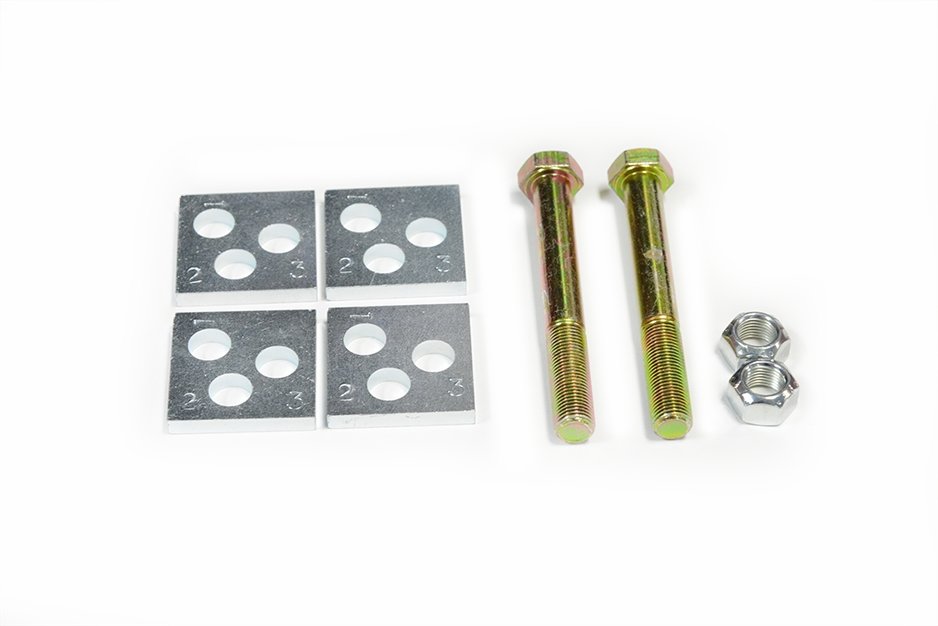

    Has anyone run across a kit like this one to "lock" the alignment? This one is made by Global West - but it is intended for use on an old Mustang, not a Toyota. I had a set on a '67 Cougar I restored. First you align the front end with the cams - then measure the position of the bolt centerline and use the square plates to lock into the retainers. Unless you seriously whack something - the lower arm pivots stay where you wanted them.
    Global West Kit for '67 Mustang/Cougar
    https://youtu.be/6-_IgY6EapU
