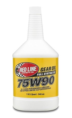

    Hey, I have a 2008 Tacoma SR5 V6 in a six-speed manual. I have the TRD Sport. I was planning on changing out the differential fluid in the rear, front, and transfer case. I bought some of the Redline 75w-90 for all three on the recommendation of the guys at O'Reilly. Just wondering, will this fluid work for my particular truck or do I need to return it and get something different/with additive? Any help or recommendations would be great!

    Redline is a great product, you got good advice, should be good to go as far as oil but remember to replace your crush washers and loosen the fill plugs 1st

    The rear diff should be a LSD so you would need additive for that, the front diff and transfer case take regular gear oil, not sure about the standard trans I have an auto.

    The Redline apparently already has friction modifiers added for a limited-slip differential in the 75w-90 so I guess that will work with no additional additive needed. Contacted the dealership just out of curiosity to see what they would say. They recommended 80w-90 in the rear, 75w-90 in the transfer case, and 85w-95 in the front. Also said I didn't need an additive (although this truck should be an LSD so I don't think that is correct).

    I have a 2008 X-Runner, and the Redline has worked just fine for me without any added "friction modifiers." But make sure it's their GL-5 gear oil. Their GL-4 oil is made for manual transmissions, so it doesn't have it. If you buy the wrong one, you just have to buy a tube of LSD additive and squirt that into your diff pumpkin.
    For my X-Runner, Redline recommends:
    4 quarts of 75W90 GL-5 gear oil for the diff, &
    3 quarts of MT-90 75W90 GL-4 for the manual transmission.

    597FEC2E-AE60-46C4-BE3C-BDB4E4C519C9.jpg I bought my 2006 Tacoma Pre-Runner DCLB 2yrs ago and according to Car Fax records it’s time to change my Rear Differential Oil. Note: LSD Only sticker is seen on my truck.
    After reading several threads, I have just returned the Mobil 1 75w 90 LS back the local auto parts store and now have order Red Line 75w 90 (GL-5) online since no local auto parts carries it. Red Line is currently $23.53 per bottle and ordered 4 just in case I spilled on the floor.
    I am not going to add any additional additives only the gear oil itself as I’ve read that Red Lines 75w 90 already has the LSD additive and several people with 2008 Tacoma and lower have no issues.
    I will report back on here with an update.

    I've been using that in my 2008 X-Runner for about a decade, and you are correct. RedLine's GL5 gear oil already has the LSD "friction modifiers" so nothing else is required.
    To piggyback on what winkel said above, always use GL-4 in the manual transmission.
