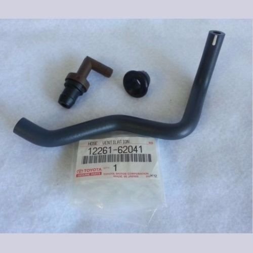

    Look into the PCV valve. And try cleanin the air filter. Its only a five minute job.

    With the PCV valve, change the "formed" hose also.
