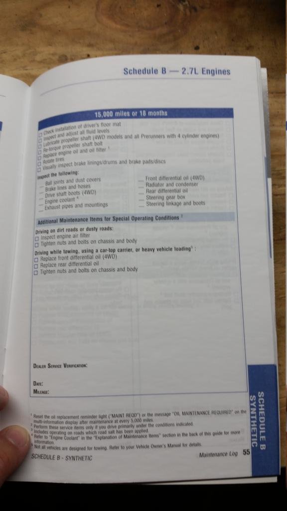

    Is states its in the maintenance manual. Schedule A for 4.0 V6 and Schedule B for 2.7 4cyl. Notice lower right hand side along the edge of page.
