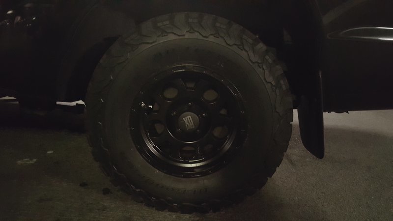

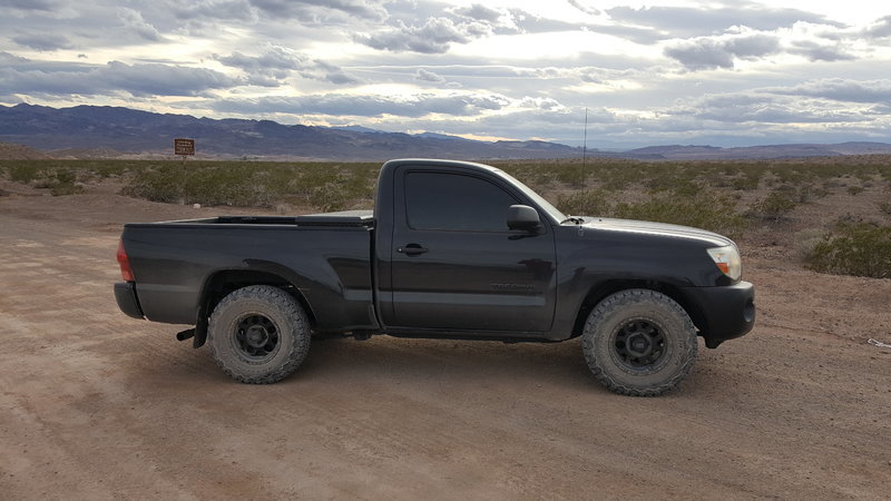

    20170201_004708.jpg 20170206_155002.jpg I'm running KMC XD Enduros in 15x7 on my truck. I love them. Best part no wheel spacers needed. SleazyPetey is running Procomp 31 series wheels in 15x8, 3.75 inch backspace, -19mm offset, and 5x4.5 lug pattern on his truck no spacers needed. MountainDrew has the Procomp La Paz. Hope that helps ya.
