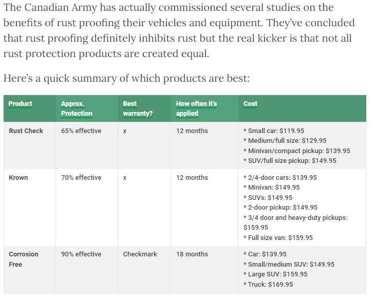

    As Will mentioned Krowne is used by the CAF on all their military vehicles. I live 1 hour away from Petawawa and I see a lot of new Military trucks coming to the depot there and then are sent to a Krown dealer in Killaloe, Ontario which is 18 Km from my place and also the dealer that I use. Just had my Taco done last week and ready for the winter.
