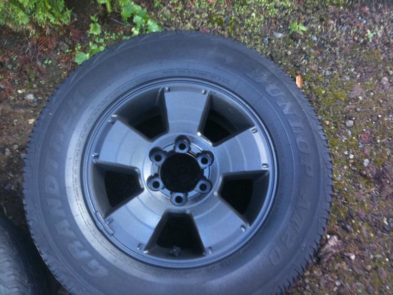

    All 4 of mine have blistered and corroded. Nothing too serious but noticeable. End up sanding rims down and painting IMG_1973.jpgwith bed liner
