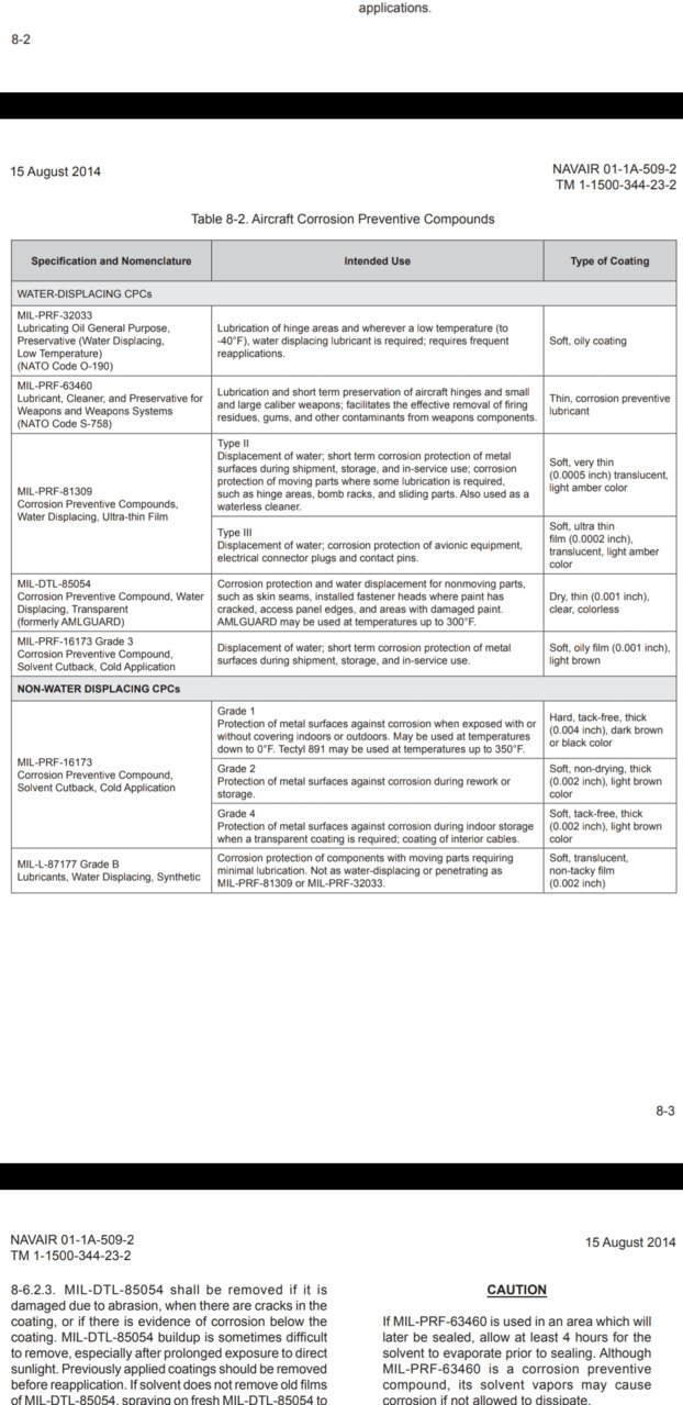

    This type of Corrosion X conforms to MIL-SPEC MIL-PRF-16173 Grade 4. Soft, tack-free, thinner brown coating. Used widely on Navy/Marine Corps aircraft as a corrosion prevention compound.

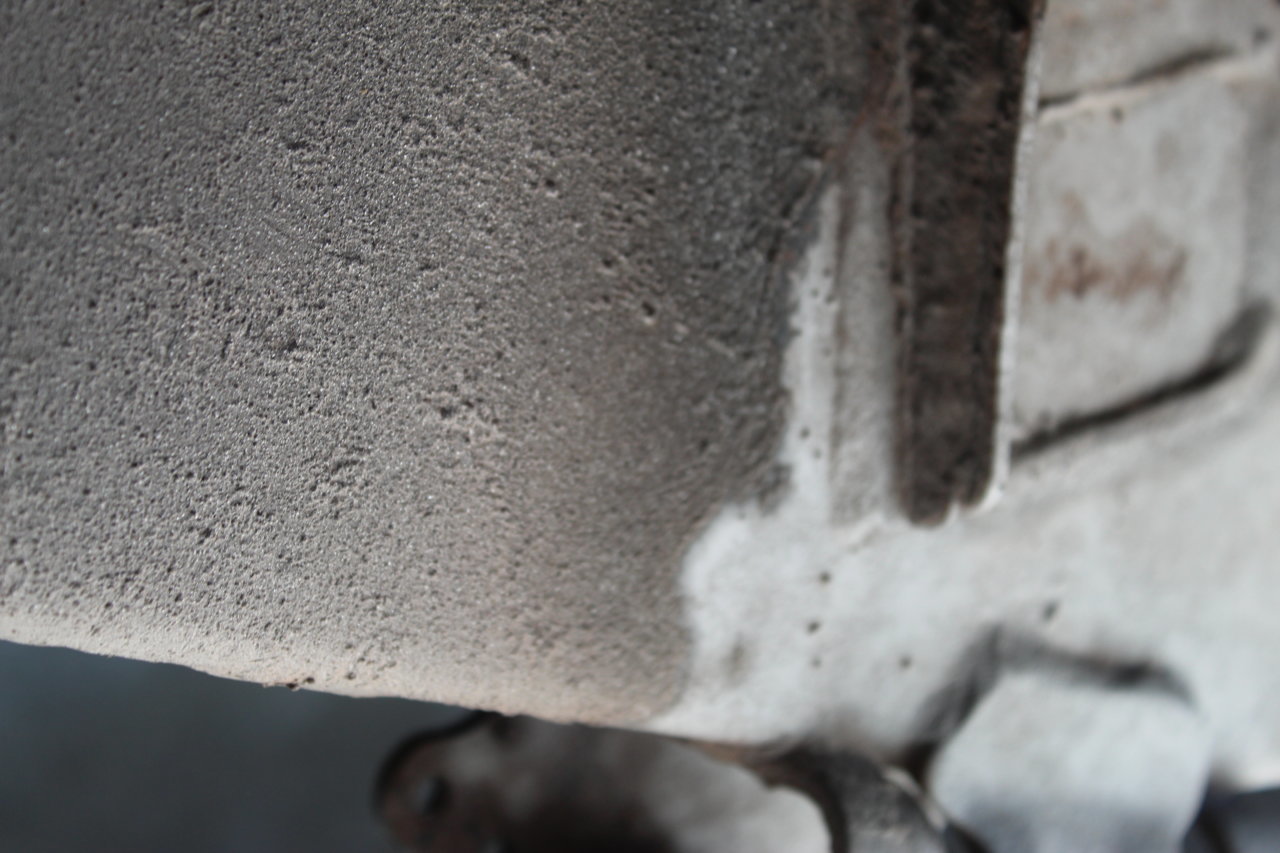

    it stays tacky and IS messy and black to the touch after road grime has accumulated, i've had it on for about six months now but am trying to remove it to replace failed taco primer / peeling paint
    if i remember the dripping from application was minimal, it did drip some
    this is what it looks like with a glaze of glass bead abrasive media dust covering it
    thanks for the tip on RejeX for bug splatter! i shall look into it,
