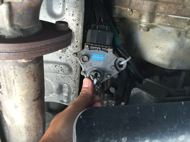

    The struggle is real when tryin' to reconnect the back up lights from auto to 5 speed manual tran but it's doable.
    let me get some pics and will get back to ya.

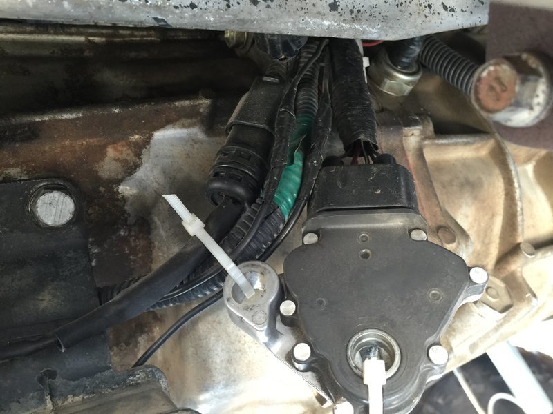

    image.jpg image.jpg image.jpgI'm sure see something like this on your swapped, first thing you want to do is assume the truck is an auto tran. Get a screw driver and put that triangle (silver plate) in back up position, unplug the silver plate to expose all the wires, turn the key in the on position and get a circuit tester and start checking those wires you will see there are only 2 wires that have power, one is your back up light cable and the other is your signals. Have the silver plate face you ( the side with the blue sticker) starting from your left the3rd or 4th pin(cable) on the top layer is your back up light cable in black color, now check another wire that does not have power and pick that one as your ground. Remove ( separate) those two pins (cable) from the housing, remove the key from the ignition and put the silver plate in park position, insulate the two cable making sure not touching each other and plug them into your back up sensor. If you do it correctly you should have back up lights when shift into back up position. It's not an easy task but it's not too complicate either, good luck and congrats for the swapped.
    Edit- remove the key from the ignition before removing the 2 cables from the housing.
