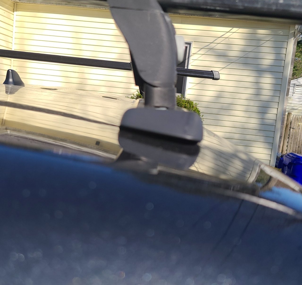

  5. Jun 24, 2022 at 4:26 PM
    Fatback17
    Fatback17 Masshole
    Jun 13, 2010
    #38868
    1,484
    Billy
    South of Boston, Massachusetts
    2020 TRD Pro MGM
    These tracks won't sit level on his curved cap which will cause any accessories to not sit properly on the track. Leer sells Yakima/Thule tracks that sit level so your accessories attach properly.
