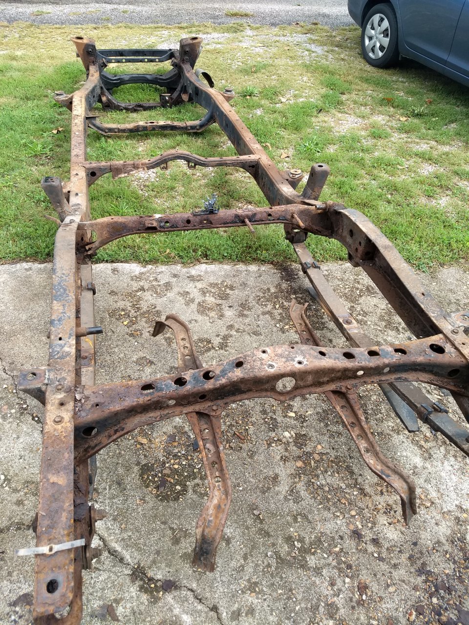

    A frame swap is not an easy undertaking. but its doable. If you do go through with it i can get you the instructions toyota provides. Like stated multiple times though this really is not a cost effective job to do unless you do it yourself
    mines currently sitting like this... still waiting on $ to keep building.. but mind you im going overkill lol
