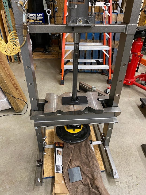

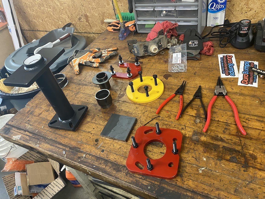

    This is what you need to do the replacement, it really is a huge time saver. I was going to make one but someone else already did for a decent price so I value my time a bit more over saving a few pennies. Even purchasing the tool it's still cheaper than paying the piper to replace them.

    What size press do you have?
    I’ve heard they can be really hard to press?
    I have access to a 30 Ton.
    But I haven’t really done anything like it before.
    I’m not against try though?
  9. Aug 5, 2021 at 9:41 PM
    #29
    6 gearT444E
    6 gearT444E Certified Electron Pusher
    Feb 3, 2018
    #243372
    7,798
    Deep South
    Herculiner Hootus
    just a 20 ton HF with the air over hydraulic pump. It hasn't let me down. If you are worried you can always heat up the bearing and retainer with a torch anyhow, since you'll be replacing it's not a big deal as long as you don't add too much heat directly to the axle shaft.

    The 20 Ton replaced mine no problem. About 3 hours start to finish once I had all the right parts. You can buy all the tools you need and still be ahead of the cost of having a shop do it. Think I'm into it for about $600 and that includes ALL new parts, including seals and the tool to do the work.

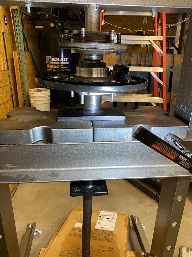

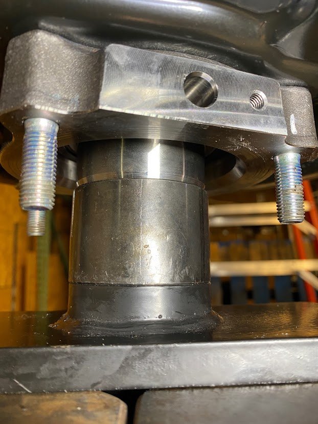

    Tool set up to remove old bearing:
    Tool set up to install new bearing:
